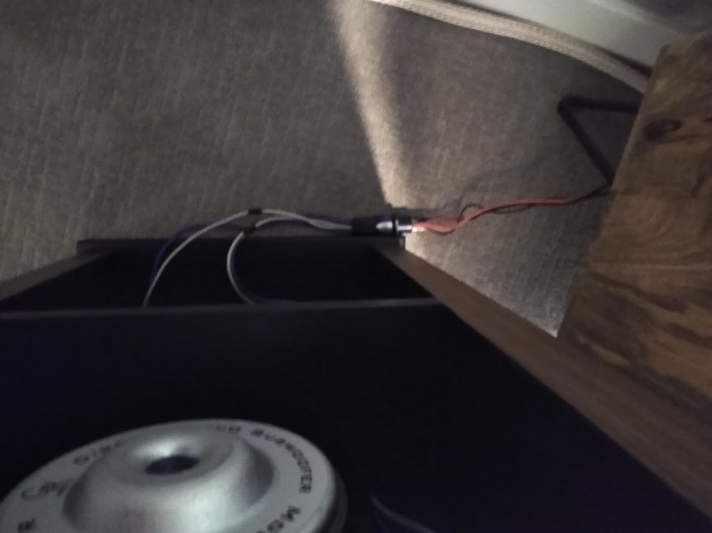

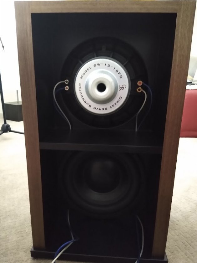

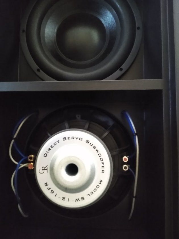

This is what I have for wiring, I am assuming these are nominal 16ohm woofer each and have them wired in parallel so the amp is seeing about a 8 ohm load give or take as its frequency dependent of course. So I don't know what else to check from here. The Servo side is a simple series connection at least per the wiring diagram. I used the wiring diagram with the two woofer configuration with the bottom woofer reversed, so therefor I can see where the wiring could trip up some people. the woofers are working together, just with a light touch on the surround's and you can verify that they are wired correctly. The Servo side is pretty simple as well.
Here is a close up of the wiring configuration. I have kept the wiring for the voicecoil  and the servo wiring on their respective sides of the build.

I can't really tell from your blue and white wiring which wires run back to the amp and are connecting to + and -.
To confirm or rule out the problem you could flip the polarity on the sensing coils at the amplifier.
It will either bring everything back under control and tighten everything up or get real out of control.
Be sure to test it at lower volumes first.

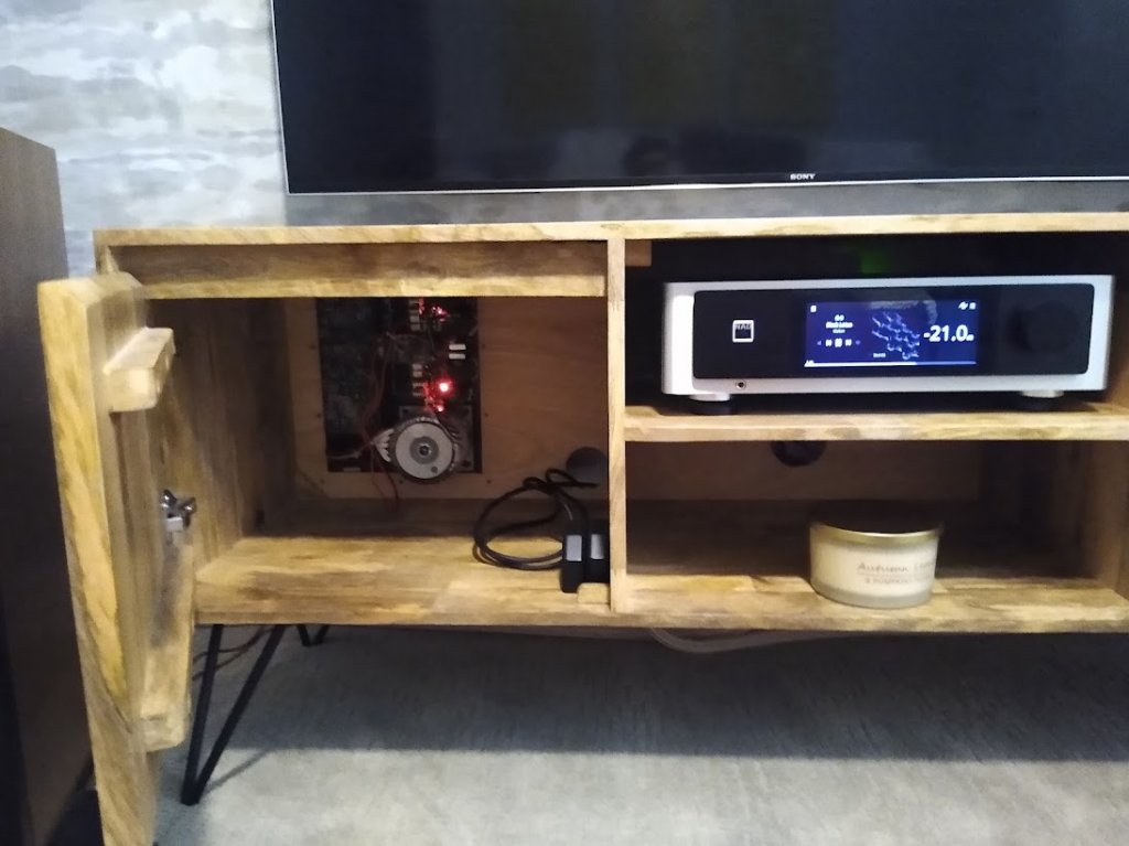

The wiring is correct Danny, but check this out! I had the genius idea to run splitters and feed both preamp inputs as Rythmik states you can gain 6db of input. So more is ALWAYS better right ? WRONG ! I opened both doors on the console so that I'm looking directly at the back of the amps. I played a series of tracks and low and behold one amp clipped at about 80% on the main volume and only got worse, the other amp however NEVER clipped ! totally different performance for sure !!!
Definitely put this in the "do's and don't" info on the kit ! I cant beleive I was simply overdriving the input stage and it never dawned on me to lose the splitters.... omg :duh: :duh: :duh:

pics of amp in overload at 80% main volume
sub amp volume at 65%
