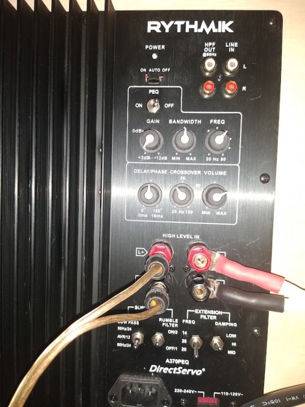

Did you ever try the speaker level connectors?  It's dead simple, you just hook up some speaker wire from your amp main amp to the subwoofer amp, and then from your subwoofer amp to your main speakers.  That alone would clear up if the problem is the RCA input or not, because it would bypass the RCA input entirely.
There's also some argument to be made that the speaker level input is better than the RCA input from a sound quality standpoint.  So, worth trying.

FWIW, jumping to a new amplifier when you’re clearly not getting the typical level of performance from the standard one is going to leave you with a good amount of risk that you end up with the same issue with the new amp. There’s 3 dead simple tests you can run (if you haven’t already) that should help you determine if your issue is with the sub amps or upstream:
1. Run the Spatials full range both with and without Dirac engaged and note the volume setting to SPL
2. Run the Spatials + subs using the speaker level inputs both with and without Dirac engaged
3. Run the subs by themselves (without the Spatials hooked up) using the speaker level inputs, both with and without Dirac engaged.
You mentioned only hitting 80db peaks during one of your test tracks, which unless you were listening to the subs alone does not add up at all. The Spatials with 400wpc available should be giving you way over 110 db unless you’re in an auditorium sized room. If you’ve tried the tests above and you’re getting normal SPL out of the Spatials both with and without Dirac, then there would seem to be something up with one or both sub amps. If that’s the case IMO it would make more sense to work with Danny to resolve and if needed get replacement amps, but it’s your choice/money. Good luck to you.

This is what I have configured. Subs only are playing, no mains ? Sub amps still clip at 80% on main volume. You can see the volume on the subs, I don't think this is out of line. No mains with or without Dirac engaged ?
To be sure I understand.  Looks like the Sub amp volume is roughly 70%.  In addition, the Main Amp volume is at 80%.  Is that correct?

Correct, that is when the Sub and LED's begin flashing on bass heavy tracks. Still no mains though ??
I can't speak to why mains are not working in that, but it is not how recommended wiring would be done. You want to run the sub and mains in parallel, not serial.
But when you say you are getting clipping at 80%, is that the input clipping light or output? I would expect it to clip at 80% of your mains more or less - that is *a lot* of volume if you are using 400w. I would just not expect you to ever be near 80% of volume.
The more important question is what kind of volume you are getting now at whatever volume setting you run your NAD at normally. Is it still low?

I may have just realized the mains issue: that is a class D amp and they usually don't have a real ground output. You likely need to wire a touch differently. Your manual should have the info. Here is the REL doc on it since REL does high level inputs almost exclusively.  https://rel.net/blog/2017-12-27/how-to/connect-rel-class-d-gear/

NoahH could have identified a potential issue.  M33 manual does say never connect the blue terminals to earth ground.  Could be a ground issue between the NAD and Rhythmic.
Also found in another forum long discussion about M33 owners having problems with DIRAC.  Distortion in the 20-100 Hz range.  Also, mention of problems across the entire frequency spectrum due to DIRAC erroneous corrections.  Some gave up on DIRAC, others "reset" M33, installed new firmware, and installed new version of DIRAC.
Suggest it may require discussion with NAD.  The way you describe the LED behavior on the sub amp, appears it is trying to protect itself (as designed) from a bad input signal - plain and simple.  Changing to a bigger amp or sealed box will not fix a problem with the source signal.
