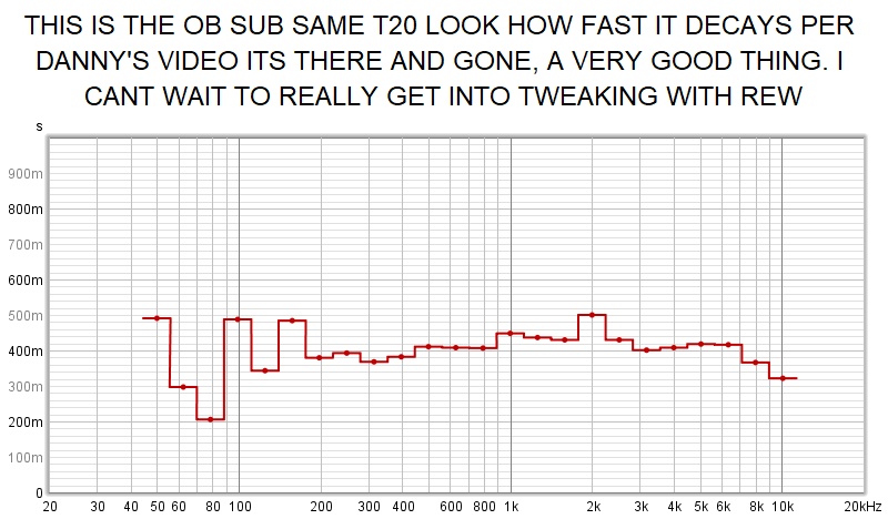

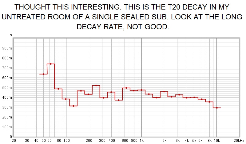

Just playing around with data results from some previous shots of the system. I think the decay of these subs are quite evident in the graph. I just selected the t-20 decay for both the two OB subs and my previous Sealed sub. I is pretty amazing the quick decay for sure. I cant wait till I get the time to really play with them.
The bit more smoothness in the midrange is due to the 706 mounted panels behind my listening space. The measurement's were months apart. Just thought this very impressive.

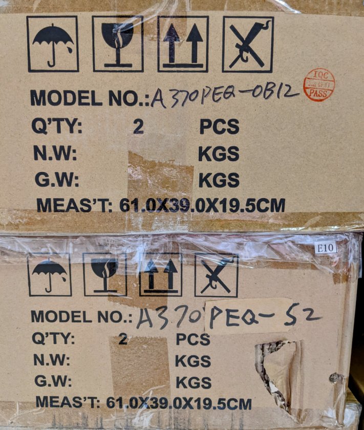

Im not sure why I hadn't thought to ask this yet.
Assuming you still have the original boxes that the plate amps came in, was there an O written on the top the inner boxes?
The outer shipping box should also have something like "A370 PEQ-OB12" written on both of the ends of the box.
If by some reason they don't, that means the amps were never configured for OB use, and are the ones configured for sealed/ported use only. The outer box should say "A370 PEQ-S3" on the sealed amps.
Here's what each version looks like:

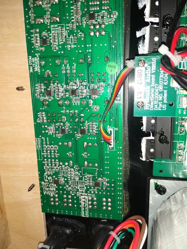

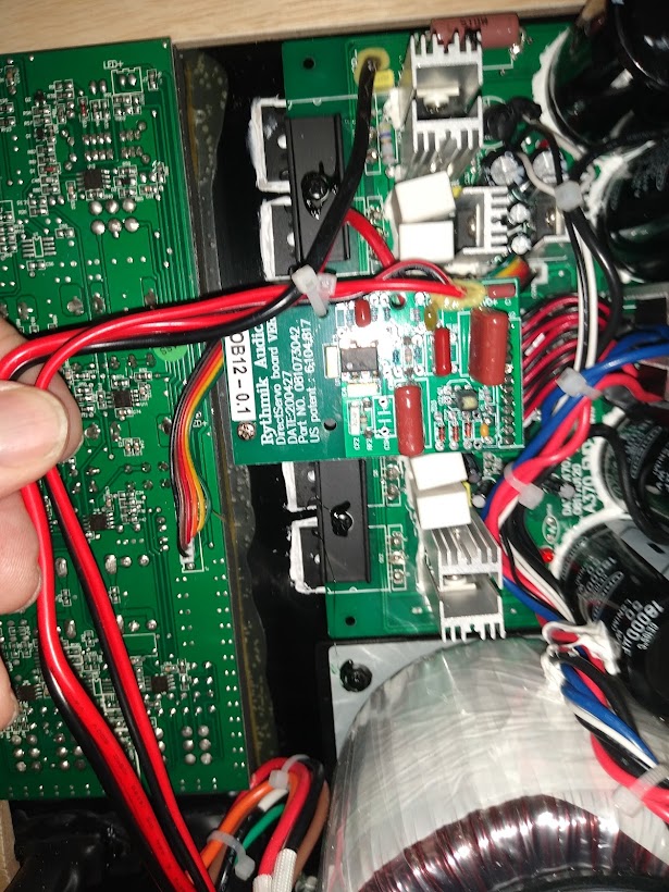

MY apologies, I have been up north with no signal for a few days. The ultimate issue I have is either my M33 output is loosing steam to feed the plate amps ? or the plate amps themselves are clipping at a certain master volume setting. I just can't get the "output" I feel that seems balanced to human hearing, at least in my case. I usually bump up the low end to compensate like the Fletcher Munson curves and research indicate about the way we as humans perceive sound balance. I cannot listen to a "flat" response, I think it sounds incredibly lifeless. So again, I just need the amps to be able to keep up with the M33 output. The sound reproduced by the M3's with this amp will part your hair ! That may be part of the problem ??
I am including two pictures of the Servo board on the amp itself that is labeled OB12 on the board itself, so I am assuming this will rule out any confusion about amp/driver mating issues. I just don't think these subs are going to work for my situation. I have been having correspondence with Brian at Rythmik. He has told me their sealed subs have more output than the OB subs as one might expect. He went on to say the ported models have even more output yet, but don't think I would go that extreme as I still want a very musical low end, and Rythmik really does seem to corner the market on that.
