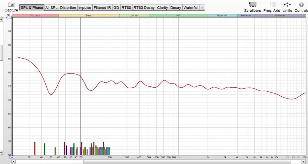

Here is the frequency response at the MLP Brian.

This plot does not look good either. You can see that you have +5db at 30hz and -6db at 50hz. 50hz is more audible than 30hz, so you keep turning up the volume.  You need to find a way to eliminate the -5db at 50hz without using Dirarc (because it is just an EQ on composite response) and find out why you have +5db at 30hz.
Also plot it down to 14hz or 10hz to see the entire roll-off characteristic.  Right now just based on the plot, you will say your subwoofer volume is too high which is why +5db at 30hz  and it causes a cancellation at 50hz, which is caused by incorrect phasing.  Hence OB sub is clipping.

Yeah, I’m a little limited on sub placement as one cannot insert a speaker cable between amp and sub, as it will ruin the servo control over the drivers. I would have no choice but to build amp boxes. As for the low end response, I’m afraid its my room simply dictating the low-end response I’m going to get. So you think I should implement the PEQ and bring down the 30hz region in hopes to bring up the 50hz region ?
