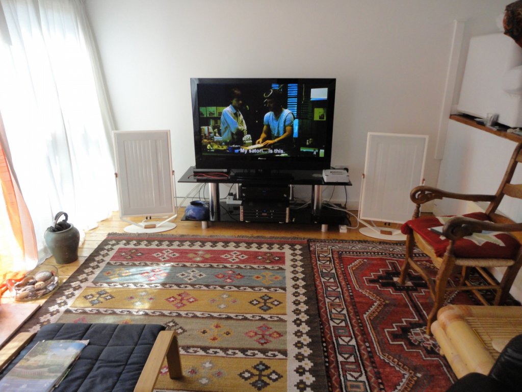

I had to 'downsize' my hifi, after losing use of my hifi room (Ocellia Calliopes previously). An added atraction was being able to specify colour -of item, not sound!
Use of a sub -or two - limited by trying not to clutter up living space; the section of the split-level room is only 15' by 10'. as you might be able to see in pic?
I guess I could hide subs behind the panels though.....
off to look at your suggestion, + other makes as I'm in UK.

The Stands are a part of the speakers -supposedly a 'hommage' to old-style microphones! But I could possibly use small subs immediately behind. Failing that, actually behind the listening spot is possible (there's a 3-step stair down into the space)
Just researching subs that have a pass-through set up, to relieve the speakers/amp of the bass frequencies.
It's the penalty of a small room space.
Get lovely bass from my Mr Speaker 'Ether' phones' often think I should just accept the phones as my main system.
