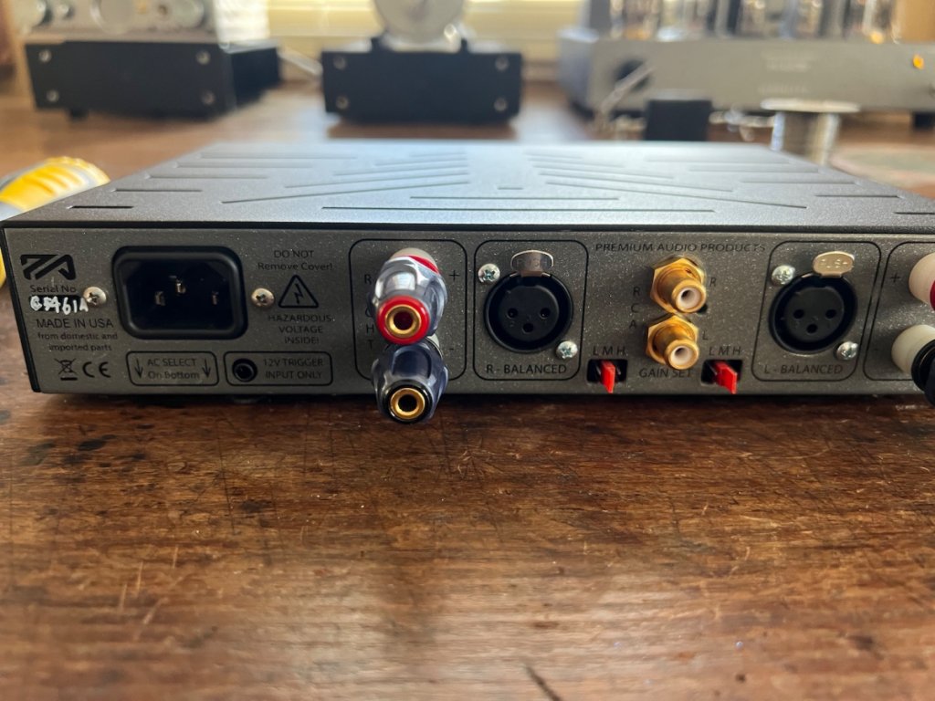

Sure thing, here's the links for the parts:
VH Hookup Wire - https://www.vhaudio.com/unicrystal-occ-copper-wire.html - get the 18ga for the speaker wire and 24ga for the RCA wire.
ETI Cable Pod (Speaker Binding Posts) - https://www.vhaudio.com/connectors-speaker.html#EichmannCablePod
ETI Copper RCA Connector - https://www.vhaudio.com/eti-fr-tc07-rca-socket.html
Case bit (to enlarge the speaker binding post holes) - https://www.amazon.com/dp/B00YK581VG/ref=emc_b_5_i
Nylon Spacers - I bought these at my local Ace Hardware.  They were necessary because the ETI Cable Pod speaker binding posts were too long.  I just took one of the binding posts into Ace and measured various nylon spacers until I found one that fit.  I needed 12 in total (3 per binding post).

Tyson when I use the links above it takes me to a gold plated binding post.  It cost $119.  Is this the correct post.  I am confused because you said copper but it is saying gold plated.
Do you remember the size of spacers?  I want to ship the parts to Class D Audio so I won't have a chance to take them into Ace.
Last question.  What length of wire should I get for each?
I really appreciate all the help.
The purity of the copper doesn't have anything to do with the plating.  Most of the time, other metals are mixed in with the copper to make it harder and stronger because pure copper is very soft.  The ETI copper is pure copper and you have to be careful with it, don't over-tighten it or it can break.  The gold plating is there only to prevent oxidation.
For the wire, I'd say get 2 feet of the green 18ga and 2 feet of the red 18 ga.  That will wire the speaker signal.  And for the RCA wire, get 1 foot of 24ga.  The space is so small you don't need any more than that, it will wire up everything with plenty to spare.

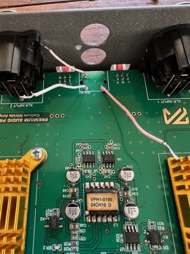

« Reply #527 on: 20 Dec 2022, 05:42 am »
Seems to me like Tyson still would like the MiniGan sound to be a touch more mellow.
Precisely.  And I got my wish  :thumb:

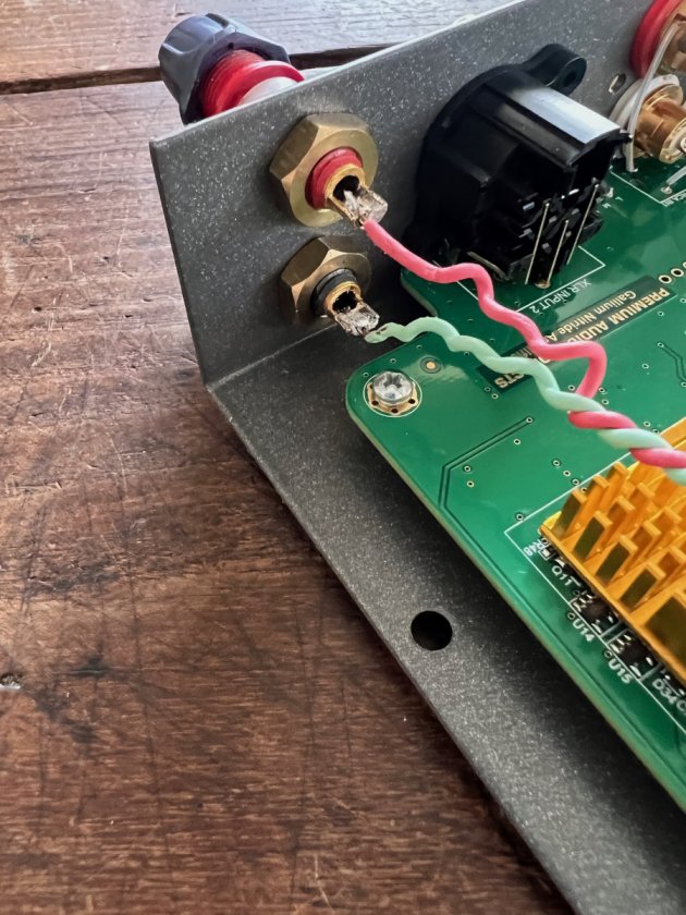

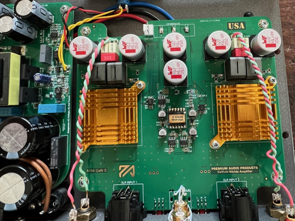

The VH Audio OCC 24 ga wire came today and I took pics of the work so people can see more clearly what I did.

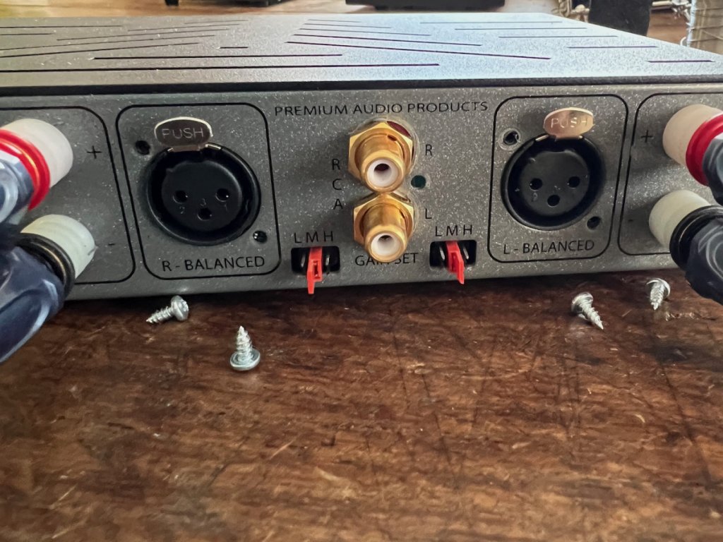

These screws have to be removed:
And removed:
The screws on the board have to be removed (one screw at each of the 4 corners in the pic below):

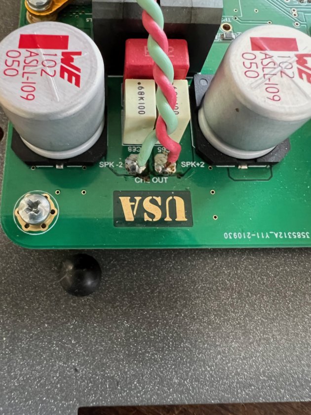

Speaker wire, red on the right, green on the left.  The old speaker wire ran under the board.  I prefer to run the new speaker wire above the board because it looks cool:
Connected to the terminals.  Red wire to the top terminal, green wire to the bottom terminal:

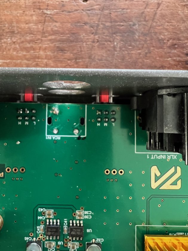

After you remove the RCA plastic block, this is the board underneath.  Ground is top left.  Left signal is bottom left.  Right signal is bottom right.
Wired up:
I was happy with the amp before the mods, because I was using it mainly as a Home Theater amp in my downstairs system.  It was great at that, perfect for it, really.  Massive soundstage, incredible detail.  But I didn't like music through it.  Too sibilant and tonally thin.  After the mods, the tonal balance is MUCH better and the sibilance is dramatically reduced.  I can now listen to (and enjoy) music through it.

Tyson, have you ever tried using starquad twisted wire?  It can provide up to 50db of noise rejection at 60hz.  In the amp you could use it from the module to the binding posts.  Induction is also decreased with this wire geometry.  Given that it is a short run it may or may not make a difference but with the proximity of the power supply it might be worth trying out.
I wonder if some of the sibilance you were hearing was because the factory wires were picking up electrical noise due to being run under the module and not being twisted together for electrical noise rejection.
