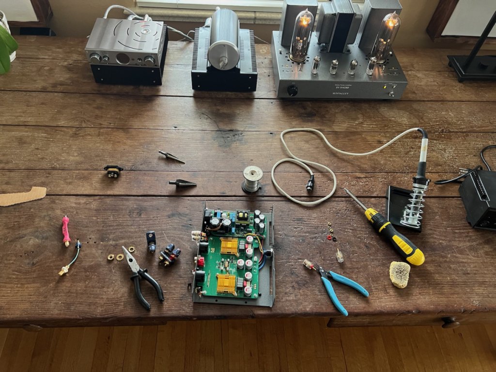

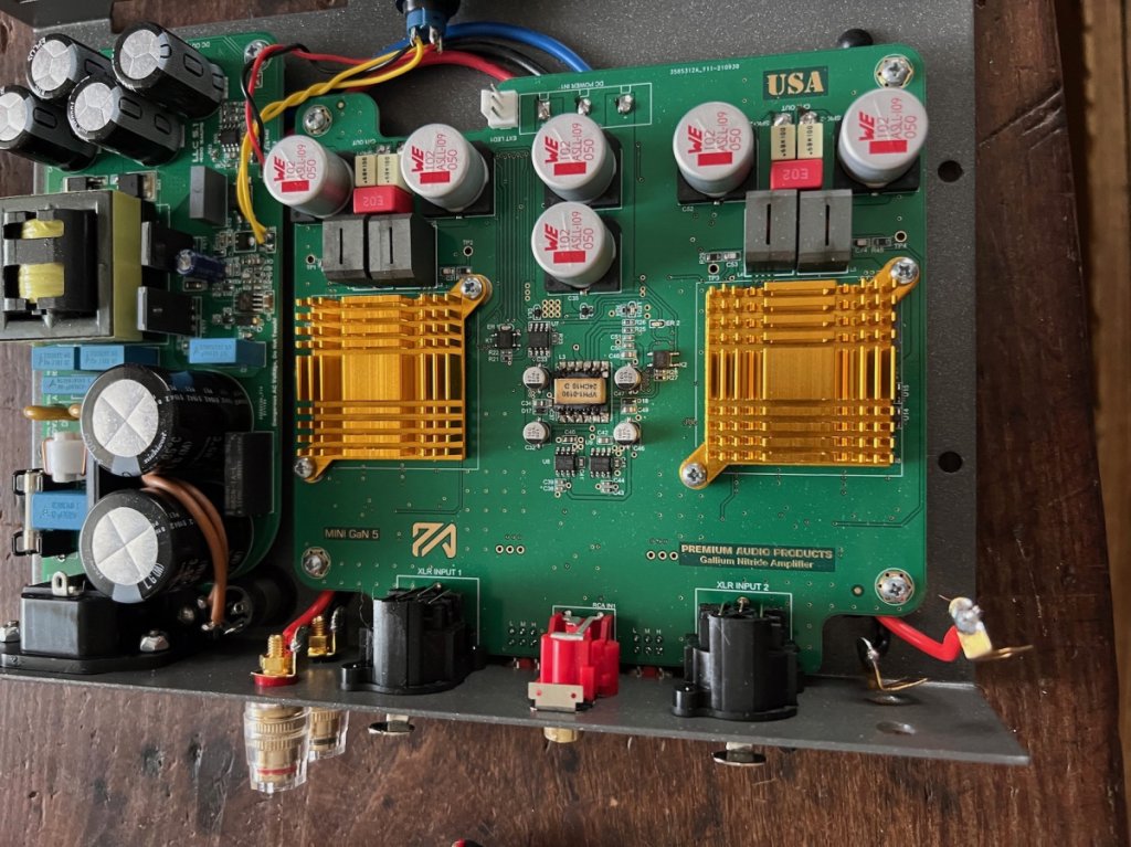

Well, I couldn't stand the hash and spitiness I was hearing with the stock MiniGan 5.  Looking under the hood it's clear they used mediocre quality parts for the binding posts, RCA connectors and internal wiring.  So, time for surgery!

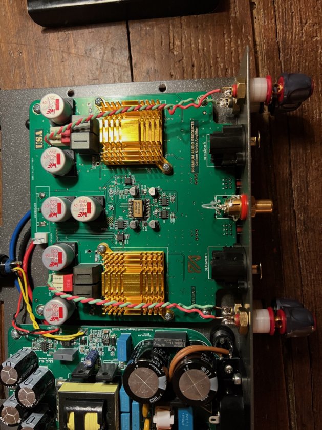

Spent the afternoon with a drill bit, a soldering iron and some top quality parts.  Here's the progression of the work:

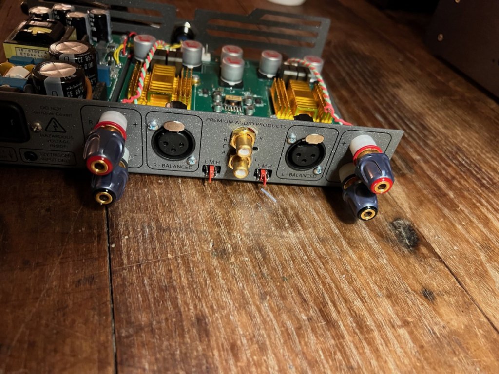

Was the result worth the effort?  Hell yeah.  Tonal beauty is no longer a glaring weakness.  It will never be a tube amp, but at least there's no hash or spitiness getting in the way of the amps other, considerable strengths.
Here's a list of parts I used.  Mostly I picked things that I know have a softer/warmer sound, to try to get the amp to be better balanced:
ETI Copper RCA connectors
ETI Copper binding posts
VH Audio OCC hookup wire (for the speaker wiring)
Nemak pure silver hand polished hookup wire (for the input/RCA wiring)
A few things to note (if you want to try this yourself).  First, the ETI copper binding posts are too thick for the existing holes in the case, so you'll need to enlarge the holes with a case bit.  Second, the ETI Copper binding posts are too long to fit without using some silicone spacers (I picked up some at the hardware store).  Finally, to get to all the solder points you need to remove the main circuit board.  There's 4 screws on the corners of the board.  And the RCA connectors and the XLR connectors have to be unscrewed from the back of the case, because the board is attached to those connectors.

 :D hi all. Hay Tyson,, that mod looks like easy enough for a home handyman. Where did you get the parts ? I just might do that myself. Thanks .... :D
Sure thing, here's the links for the parts:
VH Hookup Wire - https://www.vhaudio.com/unicrystal-occ-copper-wire.html - get the 18ga for the speaker wire and 24ga for the RCA wire.
ETI Cable Pod (Speaker Binding Posts) - https://www.vhaudio.com/connectors-speaker.html#EichmannCablePod
ETI Copper RCA Connector - https://www.vhaudio.com/eti-fr-tc07-rca-socket.html
Case bit (to enlarge the speaker binding post holes) - https://www.amazon.com/dp/B00YK581VG/ref=emc_b_5_i
Nylon Spacers - I bought these at my local Ace Hardware.  They were necessary because the ETI Cable Pod speaker binding posts were too long.  I just took one of the binding posts into Ace and measured various nylon spacers until I found one that fit.  I needed 12 in total (3 per binding post).
