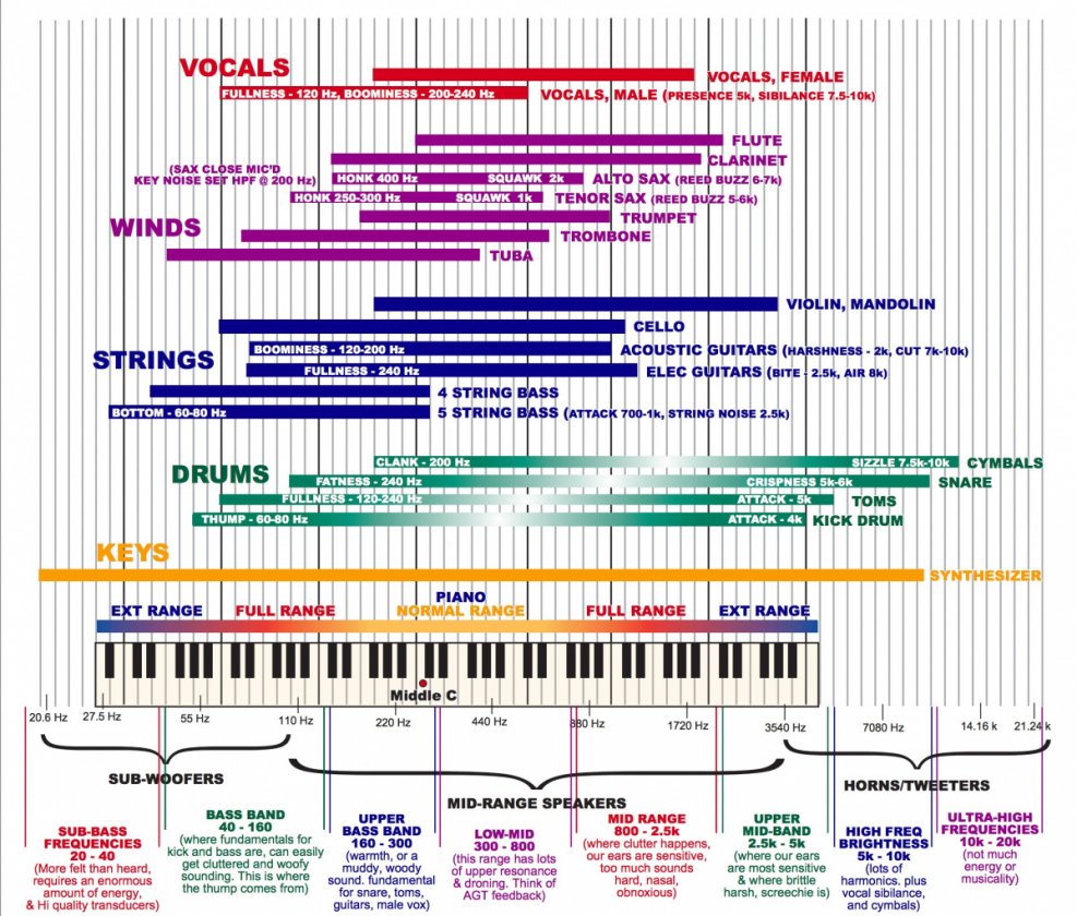

I love my X3s.  Bass has never been a problem for me.  I hear double bass instruments cleanly and clearly.  I am attaching a frequency chart that shows which instruments actually get below the 90 Hz subwoofer crossover.

Desertpilot…. Great explanation. I wonder if the 250W or the 500W is now the standard for new orders?
I suspect another thing happens… it’s not uncommon for people to want more bass.  And turning up the knob doesn’t help if you speakers vs LP are in a room mode that is sucking out all the bass.
Also, as you show, since most of the bass tone is above 90 hz… an amp that can provide the proper tone is required for all X’s and M’s.
When I looks at that chart, a tuba, double bass, kickdrum and lowest notes of a piano get down below 90 Hz.  That's about it.  Since we can't really localize a subwoofer, it is difficult to say the sub is not producing enough bass.  It could be the mid-range driver.  I've never felt the need for more subwoofer output.  I do have the SVS Subwoofers but mostly for movies (crash, bang, boom) and organ notes if they get below 30 Hz.
