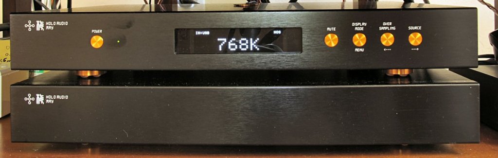

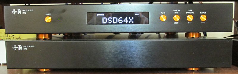

The HoloAudio May KTE is a R2R NOS DAC with an A+ rating in Stereophile's Recommended Components. The positive reviews of the May and the more affordable Spring are all accurate. The HoloAudio DACs are the real deal but unfortunately, at $5,598 for the May, not the affordable giant killer everyone is looking for.
The May is often compared to the Denafrips Terminator Plus because both are R2R DACs and the price of the two used to be close. The Terminator Plus was $6,500 a year ago. I have seen only one review where the reviewer preferred the Denafrips, there are probably more. At this level system synergy is the determining factor, one is not better than the other, only different. The Denafrips Terminator Plus current price is $8,849, so HoloAudio DACs might just be the fabled giant killer.

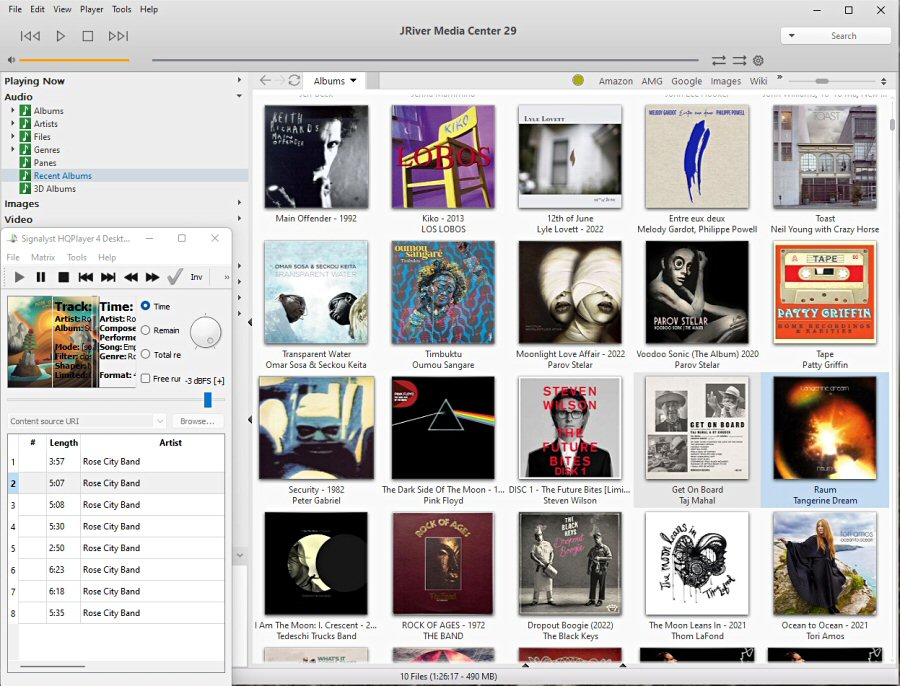

HQPlayer Desktop is the opposite of plug-and-play. At first the 21 inputs, 30 digital filters with up to 16 million taps and 15 dither settings seem daunting but many are optimized for specific sampling rates.
The GoldenSound Discord channel has an excellent explanation of all 21 input choices with recommended settings to get you started. The filter you like this week may be different than next week. But you do have to read the manual, which is included in the HQPlayer download.
I use HQPlayer with JRiver running in the background. I have used JRiver for years and it functions as HQPlayer’s pretty face. I discovered albums and individual songs can be dragged and dropped into HQPlayer. An internet search will come up with a couple of scripts to configure JRiver to play directly but I couldn’t get them to work, one has a typo that even when fixed doesn’t work and the other is too convoluted. I like having the ability to play music with either JRiver or HQPlayer. HQPlayer doesn't play mp3 so it is easy to click X to stop it running and use JRiver.
The trick to using JRiver with HQPlayer is to install Power Toys (Windows) or any other “Always On Top” utility. Start HQPlayer first, press Win+Ctrl+T (Power Toys), then start JRiver. Size HQPlayer to fit in the lower left of JRiver. Then Drag and Drop album covers or individual songs into the HQPlayer box. Each album or song added will then play next.
I don’t use Roon, muso or Alchemy Desktop. Many setup questions will have answers somewhere in the 1025 page thread at Audiophile Style, that is where I found out to set the bit depth to 20 bits for the May. Different DACs will use different bit depths.

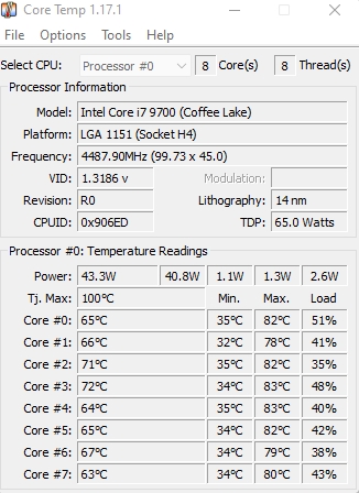

I recently built a new music server after my 10 year old Intel Atom music server died after a long illness. I picked the Intel i7-9700 processor for two reasons: extra power in case I ever wanted to play around with oversampling and the 9700 is on the approved Windows 11 list.
https://www.audiocircle.com/index.php?topic=177495.msg1867916#msg1867916

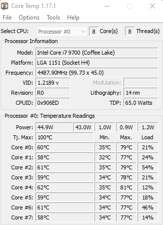

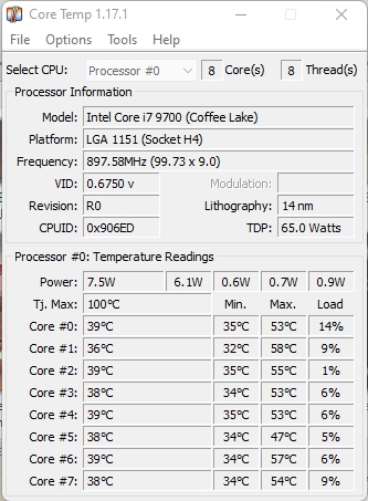

HQPlayer’s upsampling and dithering algorithms will tax even the most powerful processors. The i7-9700 does just fine but I was able to stall it out with the wrong combo. Upsampling DSD64 to DSD512 had stutters. 44.1 PCM to DSD256 looked like it would take forever to process. Upsampling on the HAL MS-6 Music Server which uses the Intel Atom quad core processor would be an interesting challenge.
I took screen shots of different oversampling configurations using the free Core Temp app
https://www.alcpu.com/CoreTemp/
Intel i7-9700 idle load and temperature
HQPlayer 44.1 kHz upsampled to 384 kHz
HQPlayer 44.1 kHz PCM upsampled to DSD256
HQPlayer DSD64 upsampled to DSD512

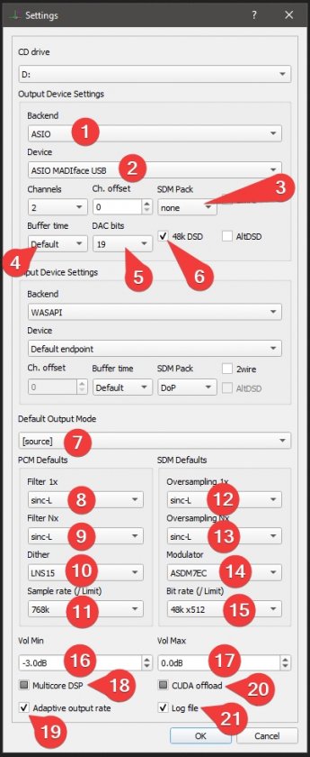

SET Up
So if I go from left to right on the main window...
First is the filter selection, most of these can perform either up or down conversion, depending on what is needed.
- So "IIR" the first one is how a steep analog filter would sound like, I don't recommend using it for anything else than upsampling and only at 2x or 3x ratios, although it can do higher ratios or down-conversion too. I think this is mostly useful to hear how "extreme analog" would sound like. Some DAC chips have slightly similar output stages.
- Then there are three types of traditional "FIR", these are similar in construction to those ones used inside most DACs, the "asym" one being somewhere between linear and minimum phases, only taking "near future" into account. So a traditional design made as good as possible.
- "FFT" is a special kind in that it performs it's work in frequency domain and is also fairly steep. This is technically closer to how audio codecs work than how upsampling is traditionally done. I don't know if any hardware oversampling implementation would use similar technique.
- "poly-sinc-*" these are the ones I use most and recommend the most, these can perform conversion from most input rates to outputs rates in a single pass and with a very low CPU load. Single pass approach maximizes the filter precision. (those who will eventually ask, these are synchronous converters)
- "sinc" is a true asynchronous converter and can perform conversion practically from any rate to any other rate. Although it is quite high quality, it has fairly high CPU load too and not recommended unless the "poly-sinc-*" ones cannot do the needed conversion.
- "polynomial*" is not a filter as such, but just polynomial interpolation approach to upsampling. These look only at small number of samples to calculate a new one and thus don't "ring", but on the other hand the filtering performance is poor too. These kind of filters typically also cause premature treble roll-off (roughly 3 dB or so at 20 kHz for RedBook material, starting from ~10 kHz). These are the controversial upsampling "filters" some people like a lot while others don't like at all. (non-apodizing)
- "minringFIR" this is a single-pass filter that is very similar to the polynomial interpolators above in that it is really short and looks only at very brief period of time, while still performing better at filtering and not having such treble roll-off issues. Not recommended for other than 2x/4x/8x/etc ratios. (non-apodizing)
Update on some recent changes regarding (Version) 2.9.1 and later:
There are now "poly-*-hb" filters for both up/down-sampling and DSD->PCM conversion. These are steep so called "half band" linear phase non-apodizing filters. These are in many upsampling cases completely reversible interpolation. Not really recommended for general purpose use, but interesting to play with.
The "poly-*" DSD->PCM converters (in DSDIFF/DSF Settings) have been heavily optimized and are now much faster while also having even more accuracy, so these are now actually one of the lowest CPU load while having best quality, most recommended choice now for the conversion.
Then to the next item, dither and noise-shaping. This is needed whenever any processing is performed. Reason is that calculations can lead to results that have more precision than can be expressed in the resolution supported by the DAC. Just truncating or rounding the result to fit the DACs precision causes distortion that is directly related to the signal. Dither hides this rounding error into very low-level non-audible constant noise (a bit like thermal noise) - then it's no more related to the signal. Noise-shaping takes this further by moving this noise to less- or non-audible frequencies. Especially multi-bit converters but to some extent others too also benefit from noise-shaped upsampling in improved linearity.
I don't recommend any noise-shaper for 44.1/48 kHz output rates, because there is no proper frequency space available where to park the noise.
There are number of noise shapers:
- "NS1" is a first-order shaper, just tilting the noise floor so that it increases towards higher frequencies and it has a bit of extra "against-the-wall" high frequency noise too. Not really recommended for anything, but included for completeness sake.
- "NS4" is fourth order shaper that has a gentle step to move a bit of lower frequency noise to ultrasonic frequencies. The only shaper that I would say is useful at 88.2/96 kHz rates.
- "NS5" is fifth order shaper that has been designed to be used at 352.8/384 kHz output rates or above. This one moves aggressively roughly 40 dB worth of noise from low frequencies to ultrasonic range.
- "NS9" is ninth order shaper variant for use with 176.4/192 kHz, the step from low to higher noise is more clear, but otherwise similar to the "NS5"
- "RPDF" this is just plain white noise, not really recommended, but also included for completeness sake.
- "TPDF" is industry standard flat triangular dither, good for any case, especially for 44.1/48 playback cases. Doesn't generate practically any CPU load either.
- "Gauss1" is Gaussian noise dither, should be more "perfect" than TPDF, but also loads the CPU more. Works for all cases too.
Third selection is set of available output sampling rates, computed based on what the hardware and selected filter are capable of, in combination.
Generally, I recommend choosing between "poly-sinc-*" filters and using highest possible sampling rate. Dither or noise-shaper chosen based on above description, "NS9" for 192 kHz output, "NS5" for 384 kHz output and "TPDF" or "Gauss1" for any lower rates...
To be continued, I'll make two other posts. One for the DSD->PCM conversion and maybe other one for PCM->SDM (DSD) conversion.
Hope this helps...

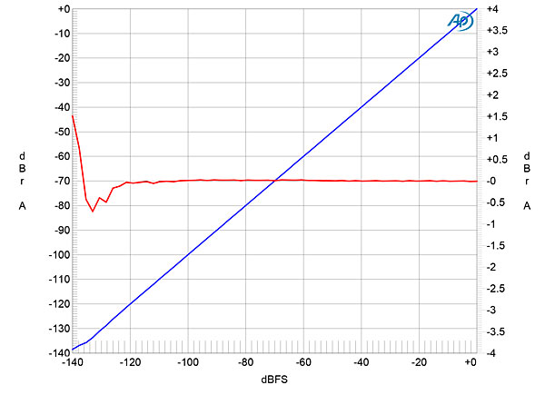

Stereophile's John Atkinson measured the May, there is a  linearity graph in the article but I didn't know what it meant, now I do.
Fig.11 HoloAudio May, left channel, 1kHz output level vs data level in dBFS (blue, 20dB/vertical div.); linearity error (red, 0.1dB/small vertical div.).
A question was posted on Audiophile Style:
"I thought the May was capable of running 24 and 32 bit. Why not use the full bit resolution?"
Miska replied:
"Because it is not physically possible to create R2R ladder that is accurate to such resolutions especially at sampling rates suitable for audio. For this reason you get more accuracy by using less bits, but higher sampling rate.
"Here is for example Stereophile's linearity measurement of May...
"You can see it begins to go off at -120 dB which equals to 20 bit...
"But since 20 bits can give over 160 dB digital dynamic range over 100 kHz bandwidth, it is safe to use it, or even much less bits and still be sure that the noise floor is dominated by analog noise.
...But I'd say it is safest to use at most 20 bits, since there's no reason to use more and it is around the figure there is most consensus about in measurements."

My Intel i7-9700 fanless music server (no NVIDIA card) does have it's limits. HQPlayer's extreme hi-res upsampling will require an extreme computer like Anand's build with a NVIDIA card1 if you want to try glitch free 44.1 to DSD512 upsampling. Staying within PCM and going from 44.1 to 352.8/384 is very worthwhile and musically satisfying. A Intel Atom based music server may be able to do it because the processor load is so low. A lot more listening will be needed to see if DSD sounds better than PCM or just different.
The Intel i7-9700 can upsample 44.1 kHz to DSD256 glitch free with the right modulator. The ASDM5 adaptive fifth order one-bit delta sigma modulator works. The slightly more accurate ASDM5EC is more processor intensive and has drop outs. The DSD256 upsampling is right at the limit of i7-9700 and a fanless case.
CoreTemp readings after an hour of upsampling 44.1 kHz to DSD256 was right at the edge but stable with core temperatures bouncing to 99° C. The cases side heat sink fins were very hot to touch. Power hit momentary peaks of 64W before dropping. The Streacom FC10 case is rated for a 65W. The Intel Core i9-12900K used by Anand is between 125W-241W and would melt in a fanless case.
1  On 5/28/2020 Miska wrote:
