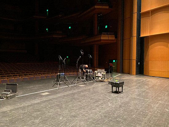

Sorry, WGH, I didn't define my acronym... IR is impulse response.  In the particular context I was describing at the time, it's the acoustic characterization of a venue or space.  So if you have an IR file for, say, Notre Dame Cathedral or Wrigley Field or your garage for that matter, you can convolve that file with your music and the music will sound as if it's playing in that space.
The catch is that you really want any IR file (acoustic space characterization or EQ filter set) to have a high sample rate and bit depth, otherwise, when it's convolved with your music, the high frequencies can sound a bit off.  Thus the reason my IR filter for my driver EQ is 32-bit and 384 kHz.  But trying to find IR files that acoustically characterize a space recorded to that fidelity is much harder (or expensive or locked into specific convolution tools).
I recommend watching the video in my second link of the previous article, as it describes a couple of ways to capture an acoustic space characterization style IR file.  (It's somewhat different that recording high quality music.)  Here is the full address:
https://www.youtube.com/watch?v=BLKWy-U6iQY
IR files get used a lot in music production for the same reason, though they describe it as adding reverb, but the process is the same - whether used in an attempt to to make a standard violin (or a synthesized violin) sound like a Stradivarius or making the recording studio sound like a famous concert hall.
Do I convolve acoustic space IR files with my music often?  No.  But it is kind of fun! :)   I convolve my driver EQ IR file continuously, however, just as I would the IR file defining room EQ filters - if I ever decide that my acoustic treatments need just a bit of extra help.

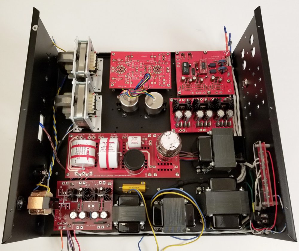

I have more info on my friends ANK 5.1 Signature, here is his in-progress build photo....
Silver (.999) signal wire 16 gauge, instead of 18 gauge supplied copper
High voltage and high current hookup wire 16 gauge
Six 1/4 watt resistors on Super Regulator board replaced with 1 watt
Basic rubber feet replaced with large aluminium/rubber footers
Small rubber washers for mounting power transformers and chokes
Super-Reg board: United Chemi-con capacitors replaced with audio Elna Silmic of same values, sometimes higher voltage
Analog board: United Chemi-con capacitors replaced with audio Elna Silmic
RCA panel jack replaced with WBT RCA jack for aux S/PDIF connection
Front-mounting rotary switch and gold knob optional addition instead of rear toggle on/off (120v live run will be high grade shielded and grounded)
Replace 5x20mm fusses with audio grade
Copper tape for making a flux band around the smaller choke
V-Caps upgrade from Audionote caps, purchased from ANK (suggestion from Brian at ANK)
Fourteen Non-magnetic Tantalum resistors all replaced on analog board, from ANK (I love these resistors for signal paths)
USB board: WaveIO with latest clock, opposed to supplied Chinese brand of questionable origin?
Added 5 volt power connector for outboard linear power supply instead of using USB cable with computer supplied voltage leg
Rectifier tubes besides the one supplied, 5Z3PJ (new), Jan5931 (NOS), WE274B (Psvane), 5U4G (whatever), etc
Experiment with the two analog tubes ECC82/12AU7 and ECC99 (EH, JJ, Sylvania, Phillips, etc)
Power transformers mounted in slightly different location with 90 degree turns
Aluminum panel with Mu-Metal shielding between digital/analog side and power supply side
Luckit WaveIO inside so the connection is as short as possible eliminating two 75/110 ohm connectors.
