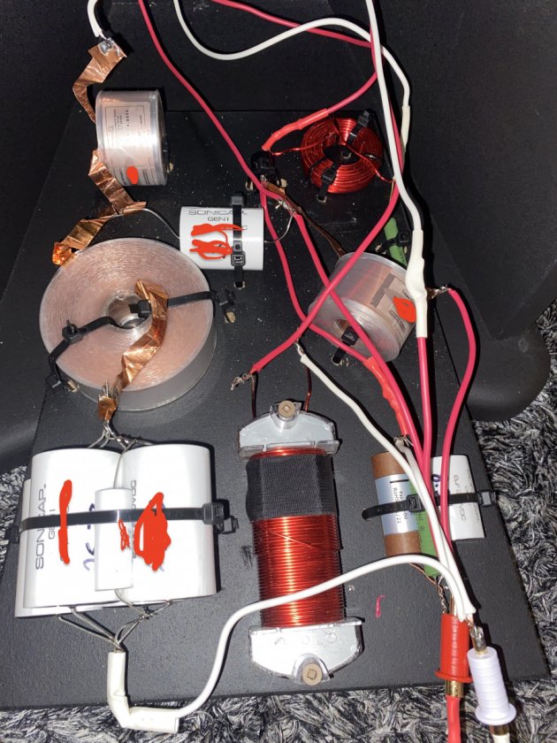

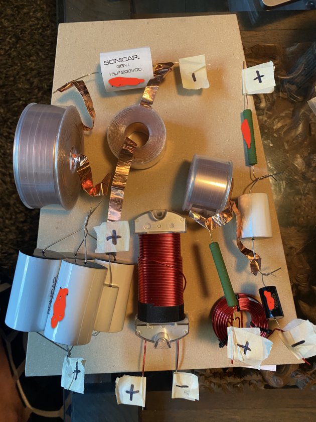

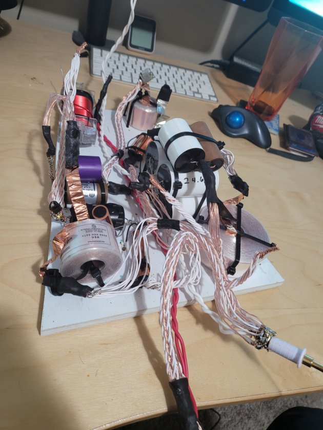

Am I close here?  Everything is put together very rough and I know that I need to sand the foil ends and wrap stuff much tighter but does this look right?  I very new to this.

 I would clip those long inductor leads

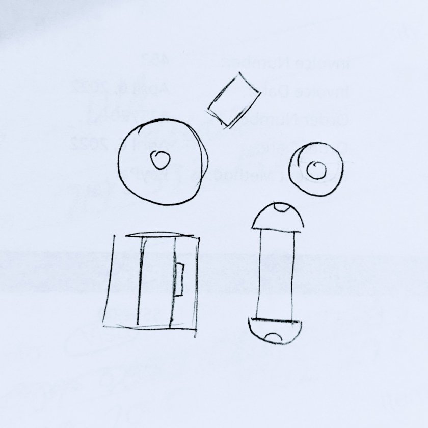

I would lay the big foil one down, along with the small one on the right, then stand the middle one up so that it's outer face is pointing towards the center of the large inductor.
The two red ones are okay.
Something like this:

Thank you so much!  Are the components of the cross over connecting to each other correctly?

If you search for other build threads on your same speakers you will see plenty of photos and suggestions. This layout is tricky, mostly because of the number of inductors involved.  As stated already, I would certainly separate those inductors a little more and have more of them laying down then standing.

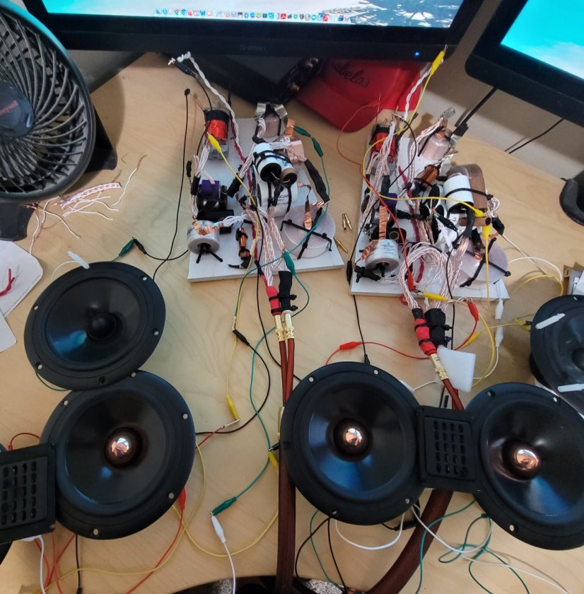

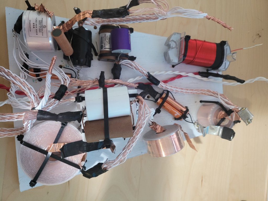

As others said, move your coils around like mine and the last pic. I think the one inductor should be stood up tho compared to the most recent picture.
I went 🍌 on my crossover so parts will look different. If your going thru all this work too I would do a few mods to your parts. Do it big now because down the road your gonna have the o
Itch and it's easier to upgrade now. Add a 0.1 vcap odam and 0.01 duelund pure silver bypass to your tweeter cap. Better yet is replace that sonic cap with a combo vcap odam and use just the silver bypass on it.
Add a 0.1 vcap odam to your mid cap bundle and 0.01 pure silver duelund bypass cap. Well worth the money. Crazy improvement... This combo sounds far better than the miflex imo. I only used miflex to bypass all the shunting or parallel to main signal.
Also upgrading to path audio resistors is WAY worth it.

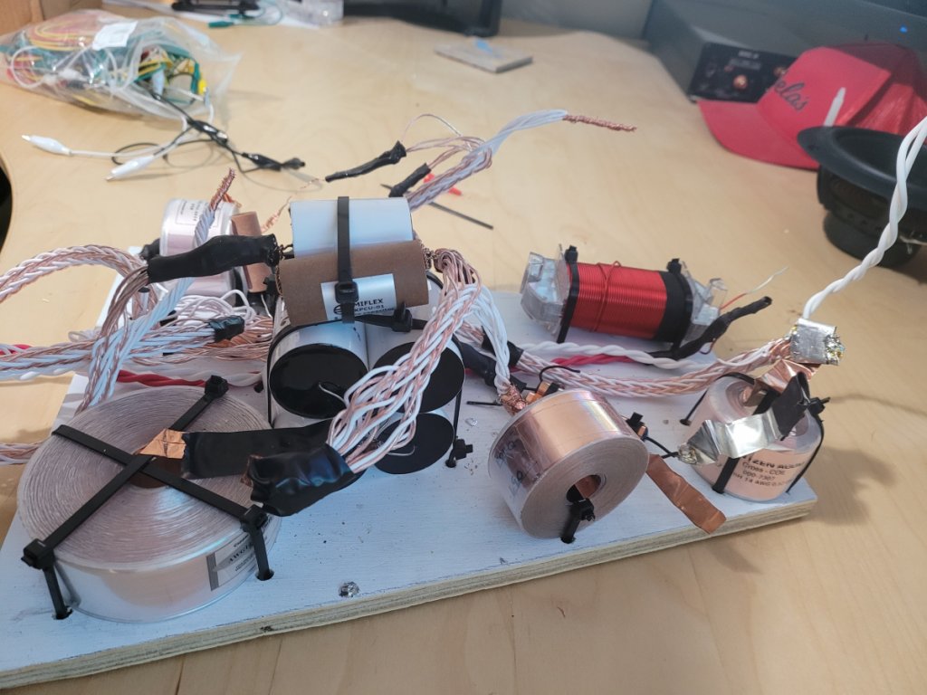

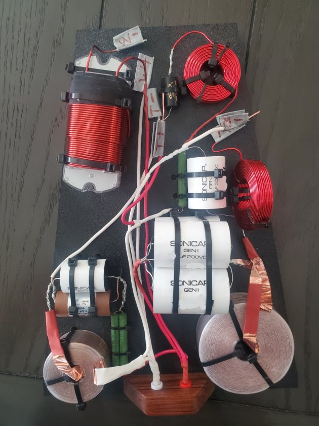

I got them up and on their feet, and man do they sound good!  Thank you all for your help.  Here's how it ended up.
I know its not as pretty as some crossovers but they sound incredible.  If you have suggestions for things you think I should change fire away.
Looking at my picture just now I realize I didn't shrink the one piece of shrink wrap :duh:
