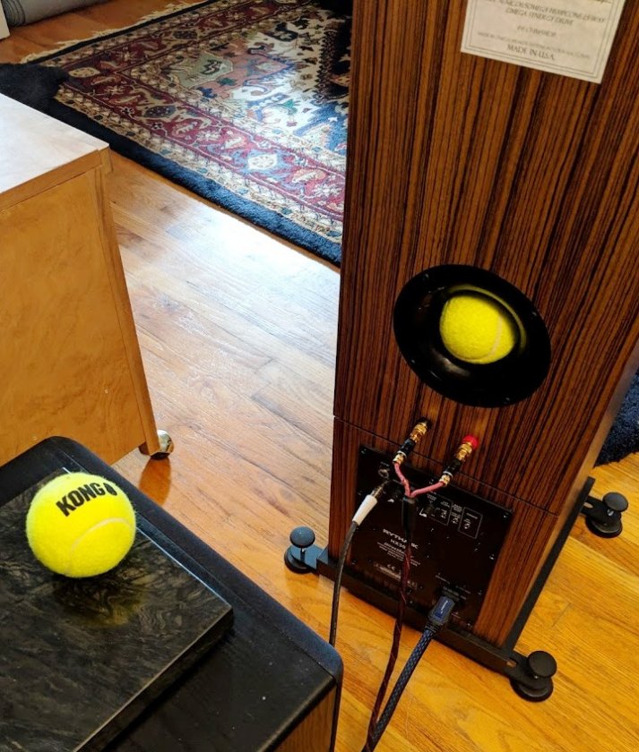

It's what I do with SAM-HO's.  It tighens up the bass nicely while reducing the output a bit.  Subs more than make up for that.  Louis has endorsed the approach.  I have posts here, maybe in my main thread, about doing this + photos.  I use an oversized tennis ball that is a dog toy from Pet Smart.   But it may be that your ports are not the same size.
I found some of these balls.  I needed to put it in a sock to fit the port snuggly.  Sounds pretty good.  Thanks.

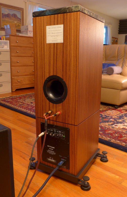

About your speakers, I see an extra plug other than power and speaker inputs. Do you have a sub output from the speaker?
pstrisik
  • Posts: 1356
  • Holding pattern in Audio Nirvana in the PNW!
Sorry for the very late reply!  I somehow had missed this.
I have Omega SAM HO's over Rythmik 8" powered woofers in cabinet built by Louis to match (even grain matched) the SAMs.
The woofers have low level, stereo input from the preamp and a power cord.  That's all.  You are probably seeing some cable overlap that makes it more difficult to tease out.
Here's a better photo to see the cabling:
doggie
I have owned two pairs of Omega towers and used a pair of subs with both. I found that plugging the ports improved clarity/coherence.
