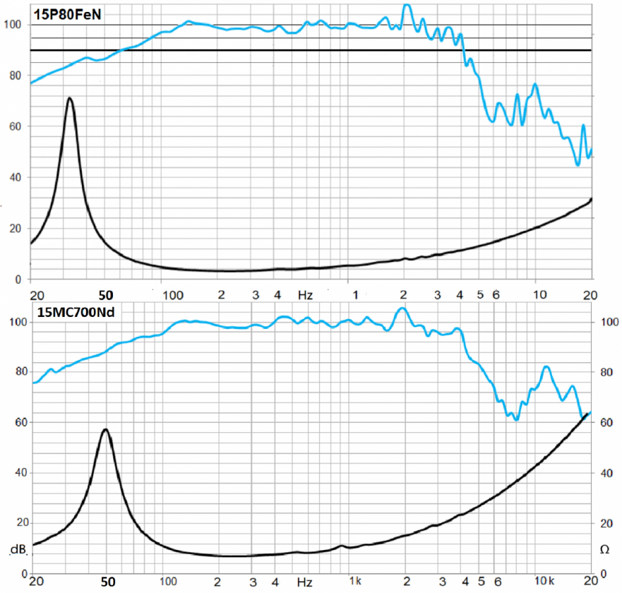

I suppose a first question is "when a manufacturer sets out to design and build an OB 15" driver where do they place there efforts and please don't say high Qts :)
Not sure never was a driver engineer, came to mind large Xmax, Mms and Xlim, low Le, hi Qts. The Beyma 15P80feN have low Qts 0.18 but hi Vas 305L what may be suited to your experiment, great driver to horn loading, 101dB.
