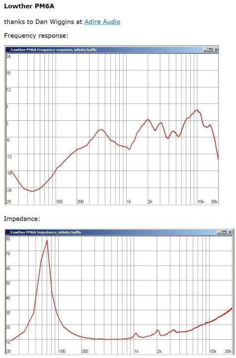

Have located this comparative maybe it help you.
