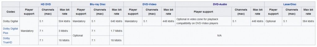

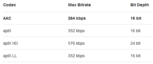

Bluetooth bit depth is evolving and changing, I don't know the KEF wireless bit depth but anyway, the sound quality will be determined by what the TV is sending, if it sends the minimum then the sound will be real bad compared to HDMI, 264 kbps and 16 bit.
Bluetooth bit depth comparison chart. MP3 audio can be up to 320 kbps, so Bluetooth is worse sound quality than an MP3, it's no wonder you can't understand the dialog.
Coax and Toslink is a little better but Dolby Digital is still pretty bad
