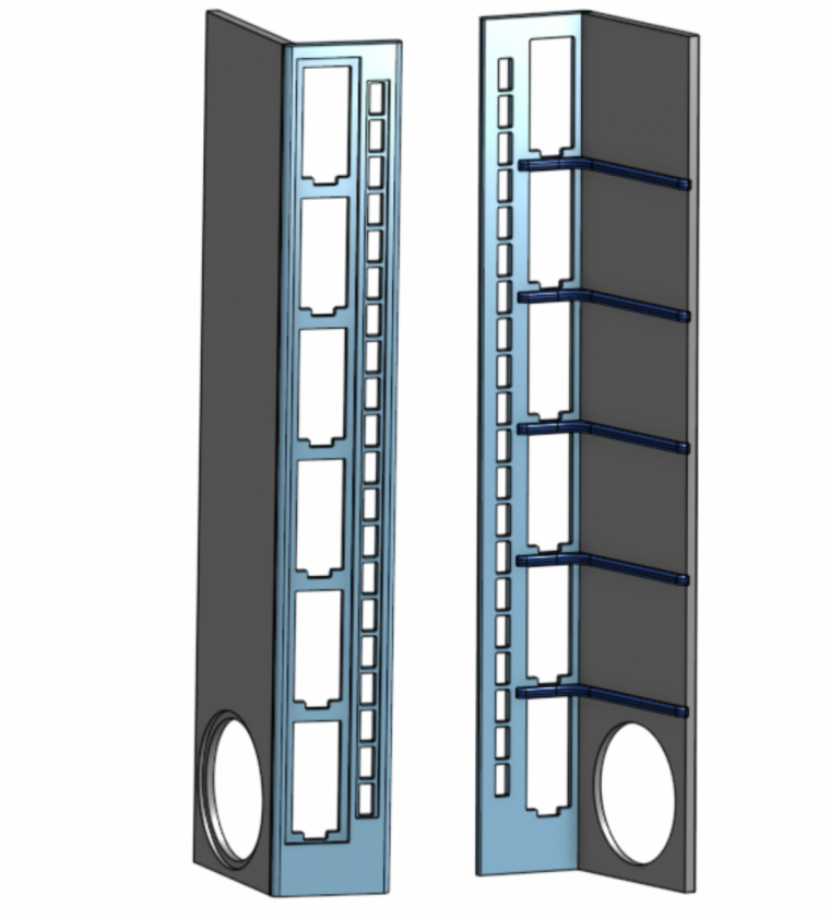

I'm interested in building a Line Force based on the Radian LM10N drivers. I'm trying to figure out which tweeter to pair them with, and how to tackle the midbass gap between my OB servo subs and the LM10N's. Does anyone have any opinions between the Radian LT3.2, and the LT2.2? I'd be removing the back cups, obviously.
As far as bridging the low frequency gap - I'm considering mounting some of the GR M-165-NQ drivers in the side wings, or potentially some other 8 or 10" drivers to take care of the ~90-200Hz band. I'd try to mount them fairly far back on the wings? I might even try to run some very narrow bracing between the front baffle and side wing since the front baffle is essentially swiss cheese. I looked into composite materials and came acrross this as a potential material:
https://www.interstateplastics.com/Hdu-Precision-Board-Pblt-48-High-Density-Urethane-Foam-Board-And-Sign-Board-Sheet-PURIFD%7ESH.php?sku=PURIFD+SH&dimensionNote=&vid=xS260514025424-3p&kitoptionpk=11561&qty=1
Much to the chagrine of Danny, I think I might use the dreaded DSP on this build... I've been speaking to Rich Hollis and am really impressed with their DSPNexus 2/8, but have now heard from a few different people that the DAC implementation may not be quite what I'm looking for. Any opinions there will also be of great help. There is no chance I'm going to be able to ship such a huge and fragile speaker to Danny to develop a passive crossover!

subsonic1050
  • Posts: 303
Re: Line Force?
« Reply #235 on: 14 May 2026, 09:23 pm »
Yes, this is exactly the problem - my OB subs plate amp only goes to 120Hz. I really wish I could use them to capture that elusive 80Hz as it would make everything considerably easier. I have come up with a cabinet design that will be made from 1" thick baltic birch with a walnut veneer. I'm going to use very narrow bracing between each of the LM10N's and the side wall to stiffen everything up a little, but one of my design choices has to be choosing a tweeter. I can't figure out which would be better - the LT3.2 or LT2.2. If I go with the 3.2, I could fit 18 of them, and with the 2.2 I could fit 20. The advantages of the 2.2 seem to be:
Cost - even with 2 more drivers they are significantly less expensive
Wider frequency range - Definitely play lower than the 3.2 looking at the response, though the suggested crossover point is slightly higher for some reason
Narrower driver - closer center to center with the LM10N, reduction in comb filtering/lobing
Advantages of the 3.2:
More surface area/moving mass
Potentially higher quality drivers? Some google summary said that, though nothing on Radian's site indicates that is the case.

Also, here is the beginning concept for what I'm thinking. Almost identical to the existing one, but made for the Radian drivers, and this one is modeled with the LT2.2 tweeters. I get more drivers, a narrower front baffle, closer center to center spacing, potentially a lower crossing point? - but I'm still looking for advice on which tweeter is best if anyone has any suggestions.
This is also modeled with a 12" SB Acoustic woofer in the side wing. It may be slightly too big? And I will probably need to put in a vertical brace. I looked at composites, but plan to build the frame from 25mm baltic birch and veneer it. I also incorporated some relatively shallow braces in the back to help structurally.
