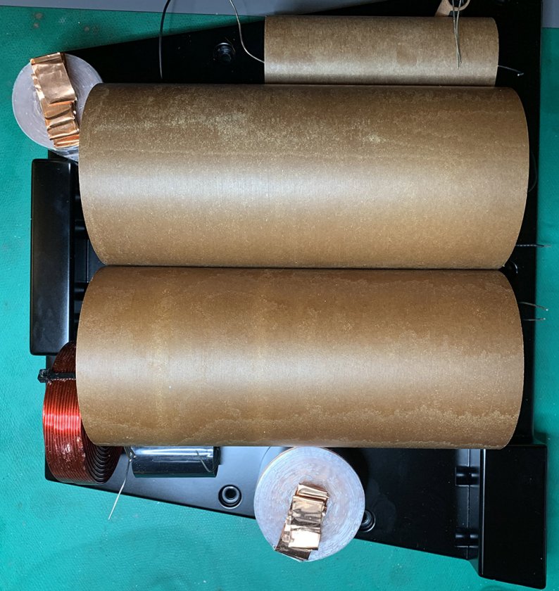

The Crossover is going to be a very tight fit to get it on the crossover board. I think I have room to add some zip-ties for the big caps. The rest I'll probably have to use some other way to hold them in place.
The resistors and bypass caps are tucked under/behind the big caps so you can't see them, but I'm using 0.01uF Dueland tinned copper foil bypass caps for the big caps. I will probably also add a 0.1uF Miflex cap to bypass the Erse cap I'm using in the notch filter.
Hi I am looking at building a pair of these with non BG components. I've done a simulation of the crossover and come up with very different parts to yourself. How did you come up with your Xover design?
Danny originally designed the crossovers for them using BG Neo 10s and out GR Neo3 in this cabinet using a microphone in front of the speaker.
We will be working on a version for a customer soon using the GRS branded Neo10 clones, but they will require a very different crossover to the original design, due to the differences in their overall response. The GRS units also have some limitations that need to be dealt with that the older BG units didn't suffer from.
We're also looking using the new Radian LM10 in the future, but it will require a re-design of the cabinet and a new network, and we're not ready for that just yet.
