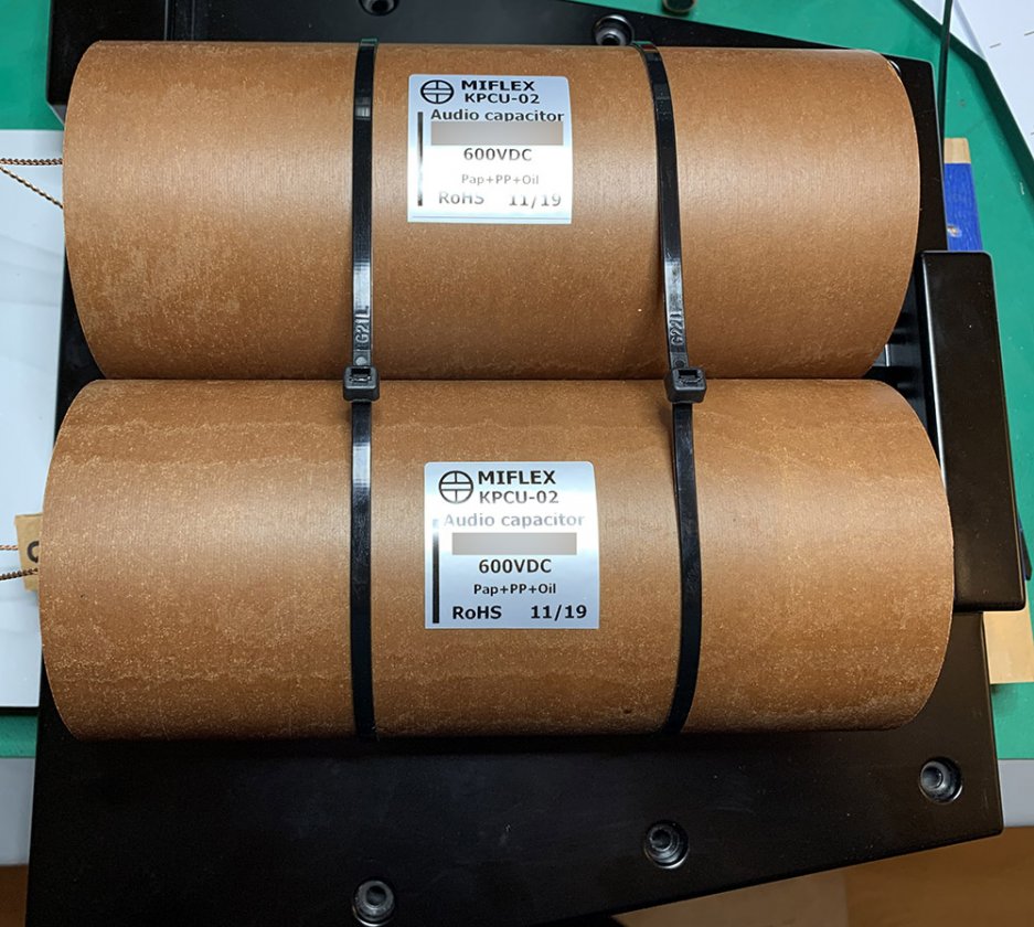

The Crossover is going to be a very tight fit to get it on the crossover board. I think I have room to add some zip-ties for the big caps. The rest I'll probably have to use some other way to hold them in place.
The resistors and bypass caps are tucked under/behind the big caps so you can't see them, but I'm using 0.01uF Dueland tinned copper foil bypass caps for the big caps. I will probably also add a 0.1uF Miflex cap to bypass the Erse cap I'm using in the notch filter.

Jay
Instead of drilling  the boards and using  tie wraps,  I'd    try using  either   clear silicon or  even hot glue....   it would suck if  drilling those boards   ended up in paint  chipping  :(
Just  an  idea
jay
Jaytor
Re: Line Force?
« Reply #48 on: 26 Oct 2022, 01:18 am »
I want to have something strongly mounted to the board, so I am using zip ties on the big caps. I drilled the holes under the caps so you can't see them from the top. This stuff drills very cleanly. No chipping at all.
I had planned to use non-acidic rubber cement, but hot glue is a good idea. I will probably try that on the other parts.

Jaytor - huge envy on this. Super excited to hear how this goes.
As a tangent, the giant caps trigger a weird thought for me for folks who do more crossovers and electronics: why do we not worry about caps next to the inductors? Caps, particularly ones like these big ones, are also giant windings of a conductor. Will those giant caps really not pick up any current from the inductor's fields?
The caps do have giant windings, but each winding is only connected at one place, so there isn't much opportunity to induce current. The caps will pick up a tiny bit of EMI (you can connect a scope probe across the cap leads), but it is very small. From an EMI perspective, it would probably be better to spread things out, but keeping the leads short will often have a bigger effect (at least in my experience).
Progress is being made. 88 screws and my finger tips are raw. The other speaker will have to wait a day or two. I ended up using #4 machine screws for the NEO3s and #6 machine screws for the NEO10s. Both 1/2" in length.

I picked up a nasty respiratory virus on my trip back from BC. Fortunately, Jay, Don and company were spared, so probably picked it up on the way back home. It's slowed me down a bit on getting the speakers assembled. I've now got all the drivers installed, the left crossover is assembled, and the right is about 3/4s done. The Neotech wire I ordered from SonicCraft was supposed to arrive yesterday, but seems to be in the wind somewhere in the USPS system.
Each of the copper caps is bypassed with a 0.01uF Dueland tinned copper foil bypass cap. The large Erse film cap used in the notch filter is bypassed with a 0.1uF Miflex. Each crossover weighs 22 lbs.  :icon_lol:
