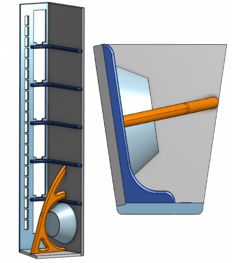

I think it's probably unimportant for now - I'm going to just build them as "normal" but with the radian drivers and some bracing in the cabinet. Then I'll see what the array is doing, how my OB subs blend with it, and I can try to address the midbass later if necessary.

When I was originally thinking about building out the Line Forces, I actually was very much leaning toward the newer Radian drivers as my first choice.  But then I ran in to the exact same issue that you are here - how to get an elegant bass solution that would meet them at 200hz.

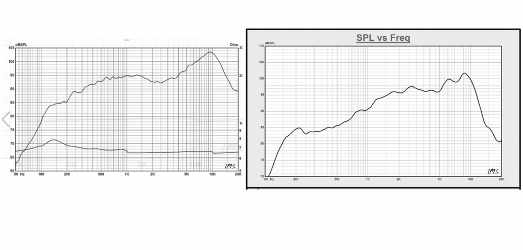

Thanks for the input everyone. Tyson - this is the first time I'm hearing that this issue is more of an issue with the Radian drivers than the old BG drivers. Everything I had read was that the LM10N was better in basically every way. When I'm looking at the frequency response, it appears the Radian rolls off much better below 200 where the BG falls of a cliff. In this diagram the Radian is on the left, BG on the right. How did you determine that the Radian would be worse? I hadn't compared the responses before and now I'm wondering if this whole question is actually a non-issue with the Radian...

I also decided - F*&K it, and I just dropped almost 6k on drivers. And that's not even all of them. I ordered 16 LM10N's - deciding to do 8 per side, and I ordered 3 each of the LT3.2 and LT2.2 tweeters. My plan is to make small test speakers with one LM10N and 3 tweeters to decide which tweeter to use and also test baffle configuartions (waveguide vs no waveguide, waveguide shape, etc.). I have what I think is a cool idea regarding the waveguide. I'd build the cabinet with the drivers flush mounted from the front - like they currently are. Then I'll mill a huge piece of walnut to put the waveguides in and attach it over the drivers. That way, I can maintain the small braces that form a web between each driver. Also the waveguides will look much prettier milled from walnut. There are wood movement concerns, but I have some thoughts on that.
