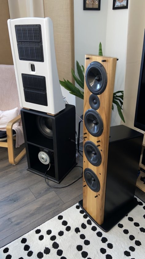

Would you care to comment on your observations regarding the size of the sweet spot with the Line Forces vs your NX-Oticas now that your big caps are properly broken in? Is it still an issue you feel the need to work on?
I have been playing around with speaker position and bit and have been able to significantly improve the sweat spot width. It still sounds best when seated centered between the speakers as every speaker I've owned does, but I can now get a decent stereo image across the width of my couch.
Regarding the change in response while standing, as Danny has mentioned, there is a bit of change in response when your ear height is near the top of the line arrays, but this is the case with any line array. Obviously a taller array would mitigate this, but at the cost of a more visually imposing design. I personally think the existing Line Force design is pretty optimal, particularly in my room which has a moderate height ceiling.
I should make it clear that these speakers sound spectacular when seated. They still sound very good when standing, and it's only because I'm very familiar with the sound that I have noticed the change. No one else that has heard them has even noticed.
I've had a number of experienced audiophiles over to hear my system that have commented that it is among the best (if not THE best) system they have heard. I'm really glad to hear that Danny and company are looking at a new version using the Radian drivers. This speaker concept deserves to be heard by more people.
