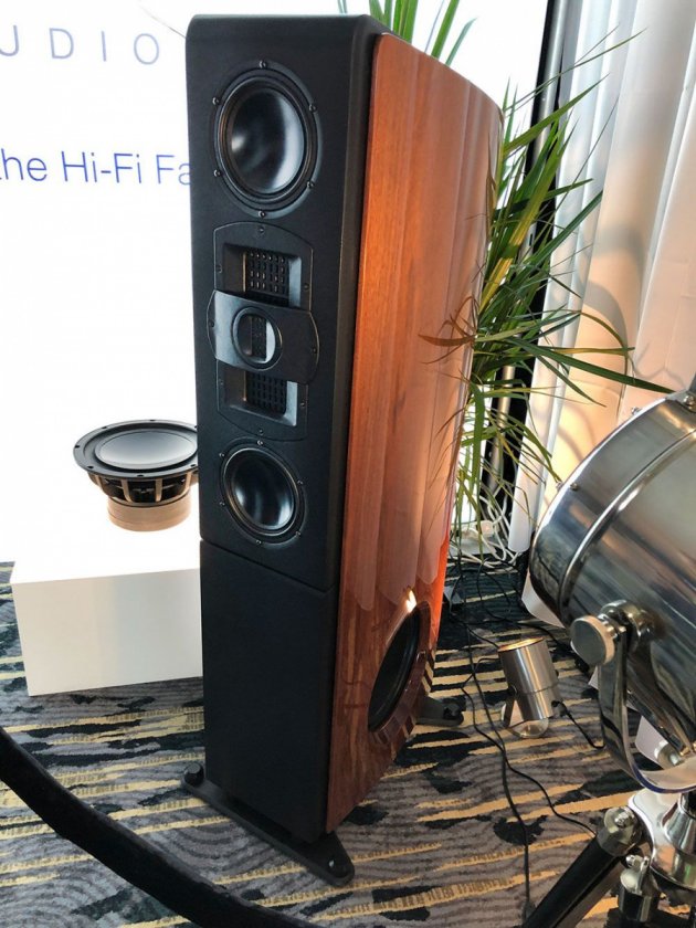

The planar coaxial. Looks like someone thought of that already:
https://www.bmsspeakers.com/index.php-90.html?id=bms_4508nd
https://radianaudio.com/collections/coaxial-ribbon/products/6crn38lt6-line-array-driver
PS Audio tried the planar coaxial approach with one of their early prototypes and gave on on this design.
That’s good to know. They obviously tried that approach because they understood the potential. Might be better off with the BMS 4508nd drivers to make a line source with perfectly aligned acoustic centres, and uniform polar response.
  • Posts: 11647
Re: Line Force?
« Reply #178 on: 1 Feb 2023, 01:50 am »
I heard that exact setup, and it was ..... not good.
In fact, I've also run a coaxial system in my own home setup (passive and later fully active).  It was meh.  Now that I think about it, I've actually heard quite a few coaxial setups over the years and none of them sounded amazing.
With coaxial speakers that had a round woofer and a round tweeter in the middle, the soundstage never left the speakers.  With coaxial speakers that had the drivers co-located (ie, the tweeter in front of the midrange) the midrange had this weird ghostly quality to it.  Pretty much like if you put a big ass tweeter in front of your mouth, it's going to make your voice sound weird.
In some applications, maybe you can't get away from a coax setup due to space limitations (like a car), but in all other instances, it's best avoided if you want the best sound quality.
