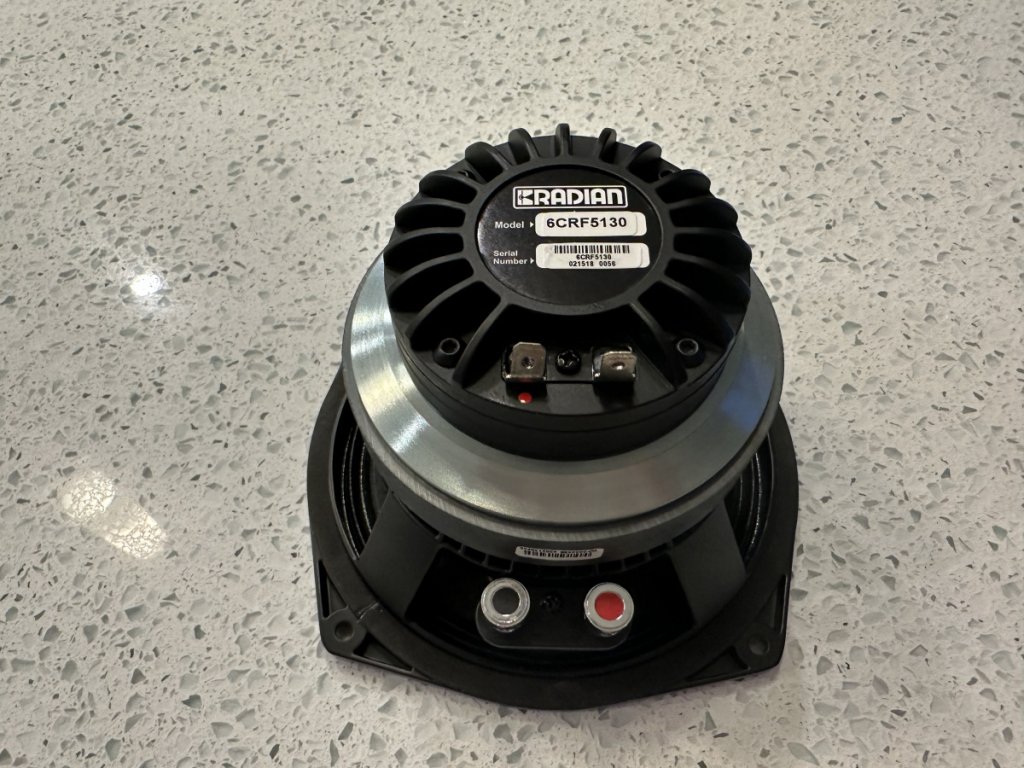

I actually have some of Igor’s round ribbon coaxials here and they’re killer!
Yes, Igor and I have talked about those.
For an open baffle application try taking the backs off of them and they will really open up.
Low distortion

« Reply #156 on: 1 Feb 2023, 12:46 am »
The only thing I don't like about those drivers is that the time arrival of the tweeter is so far behind the woofer.
Low distortion
  • Posts: 39
Re: Line Force?
« Reply #157 on: 1 Feb 2023, 12:47 am »
One of them arrived damaged with the binding posts broken off the tweeter. So I plan on using a pair as midwoofers in a 2 way. But the tweeters are very good. And can play very loud with no fatigue.
That can easily be solved with SOTA DSP.
