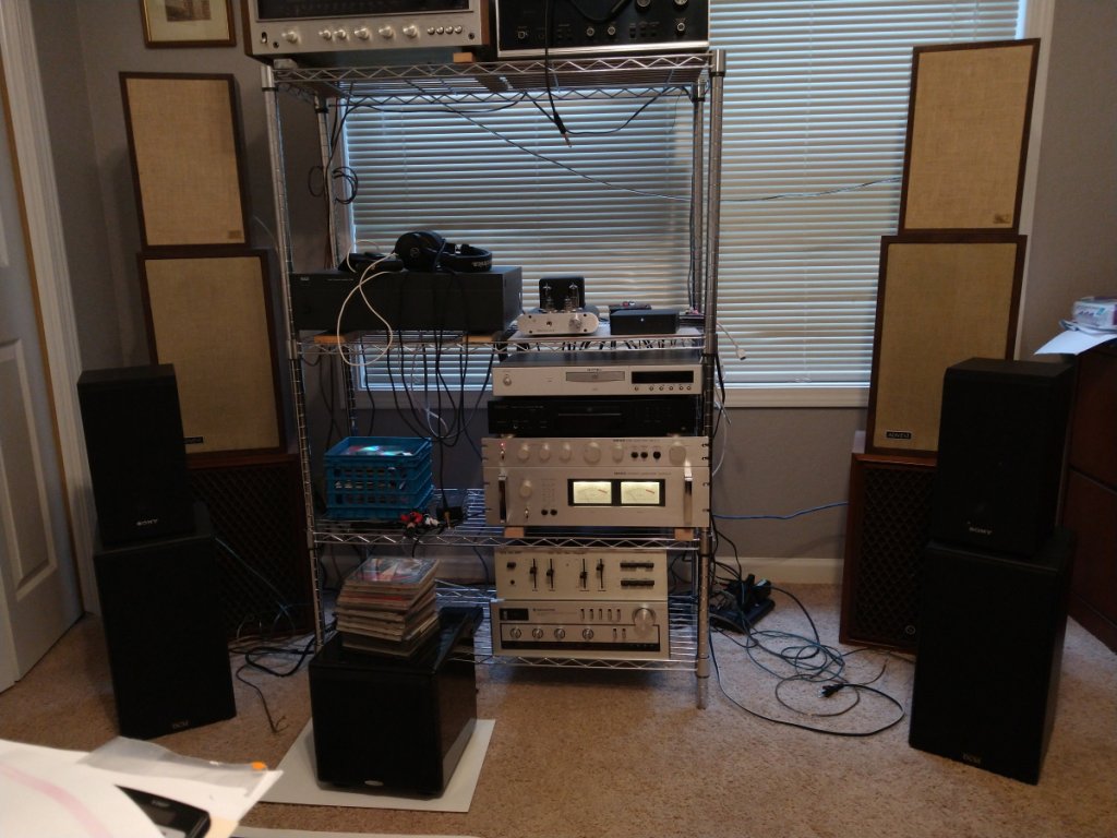

I just finished the SSCS5 upgrade. I never owned or considered Sony speakers before. I listened to those speakers stock for about 1 week so maybe between 35- 40 hours total (driven by Nikko Alpha/Beta II) and my impression was that they are OK stock but somewhat congested in the mid range. Kind of what I expected from cheap Sony speakers ($123 on Amazon). Stock they would not be something I would want to listen to all day but I felt I should get a good baseline before doing the upgrade.
Wow, what a difference the upgrade made. It was like clouds cleared and the sun came out. I have to let you know my listening tastes are jazz, classical, orchestral, and 60's and 70's R&B.  The bass is beautiful; clear and strong (Dave Holland and Ron Carter) and the mid range congestions is gone (lots of Freddie Hubbard and Chet Baker). I am quite impressed. Listening to some Bernard Hermann and Henry Mancini film sound tracks, recorded in 50's and 60's that I played before the conversion sound clearer, more detailed after.
I had to listen to one of my Philly favorites, the Delfonics 'Didn't I Blow your Mind.' I think this should be theme song for these Souped-up Sony's.
Thanks for this Danny! Makes me want to build one of your kits. I was considering building Wayne Parham's four pi speakers but now I am rethinking that.
My wife already told me I don't "need" any more speakers. What does she know?
jmimac351
