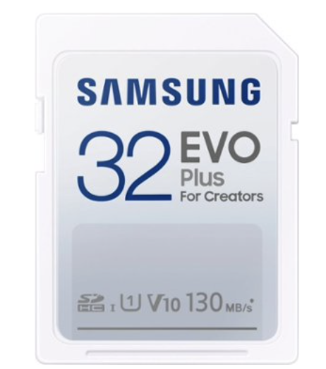

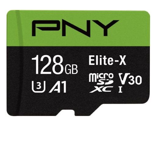

Calypte
Re: New OS3 to replace Manic Moose
« Reply #48 on: 14 Jul 2022, 07:11 pm »
SD card or CF card?  The BDP-1 and BDP-2 use CF cards which are much larger in dimensions.  I posted the reflash procedures  for the BDP CF card reflash a few posts back.
It's a mini SD card.

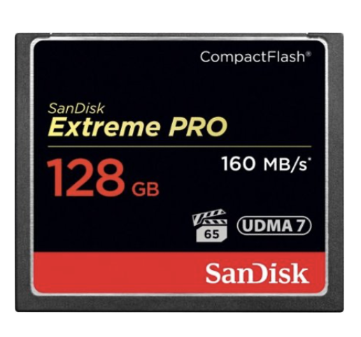

vonnie123
  • Posts: 364
« Reply #49 on: 15 Jul 2022, 02:22 am »
I am talking about a USB flash drive or music drive as you described. Excuse my lack of knowledge but what is a BDP CF card and an SD vs. CF?
Here some info on the different cards.....Micro SD, CF, and full size SD
https://en.wikipedia.org/wiki/SD_card
https://en.wikipedia.org/wiki/CompactFlash
gbaby
  • Posts: 951
« Reply #50 on: 15 Jul 2022, 01:41 pm »
I thought these discs were for digital cameras. How would you use this on the BDPs?
vonnie123
  • Posts: 364
« Reply #51 on: 15 Jul 2022, 02:54 pm »
http://support.bryston.com/downloads/BDP/Replacing_Flash_Memory_in_BDP1a.pdf
The Compact Flash (CF) card is pictured in this link.  BDP-1 and BDP-2s use CF cards to store the firmware and load it at boot up.  I assume BDP-3s  use the same system.
The "KINGSTON" card is the CF card.
gbaby
  • Posts: 951
« Reply #52 on: 15 Jul 2022, 09:19 pm »
Thanks Vonnie. I did not know. Since I own the BDP-2 and 3, I guess I won't need to replace my Compact Flash card will I? If I owned the BDP1, I'd be satisfied that it plays my USB files, and I would not care about Roon. No sound is better than imported music from CDs in my opinion. You would think that a BDP would result in buying less CDs. However, it had the opposite effect on me as I am buying more CDs.  :o
vonnie123
  • Posts: 364
« Reply #53 on: 16 Jul 2022, 12:59 pm »
If it works ok, no need to replace it.  (If it ain't broke, don't fix it...!)😀   You only need to replace/ re-flash the cards if they get corrupted.
