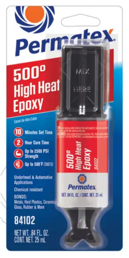

High Temperature epoxy is what I used when I had a base key break.
