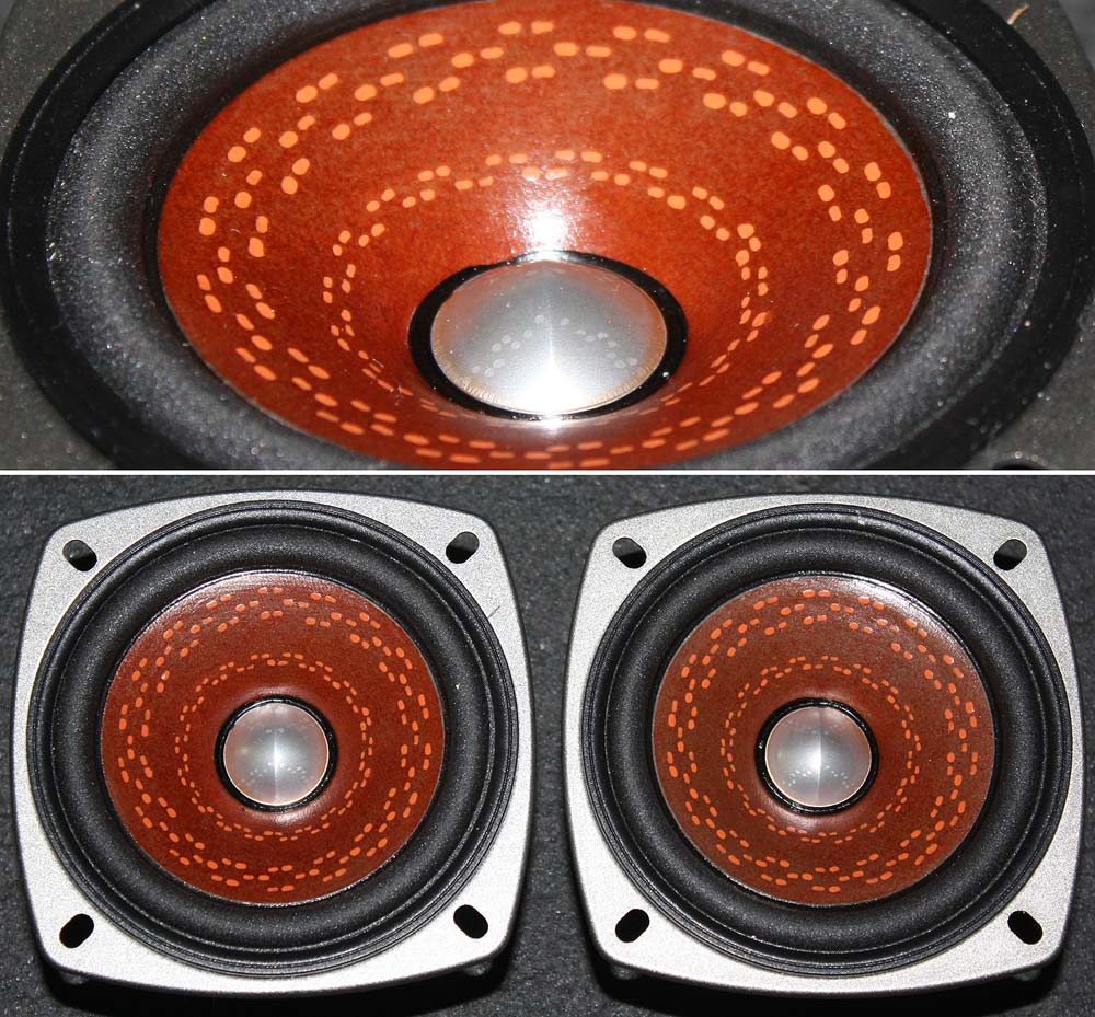

Fostex FF85wk, Mark Audio Alpair 5.2/3, 7.3, Pluvia 7HD.

Be aware that that Fostex is a 3" paper cone full range and will have the typical intrinsic issues when used as a tweeter.

I thought the same when i modified my first pair… but it had better top than the $100+ tweeters on hand. Do not dismiss how well the 19mm dustcap works as a HF radiator.
Do not dismiss what they can do.
The Mark Audios mentioned are all Al alloy, the A6.2m and A7ms are also good.
There is a plethora of new modern small fullranges that make excellent midTweeters. You can choose your poison.
2 significant advantages directly from the low XO, it is possible to achieve quarter wavelength spacing to eliminate lobing, and the XO is placed where many of the other evils go away.
