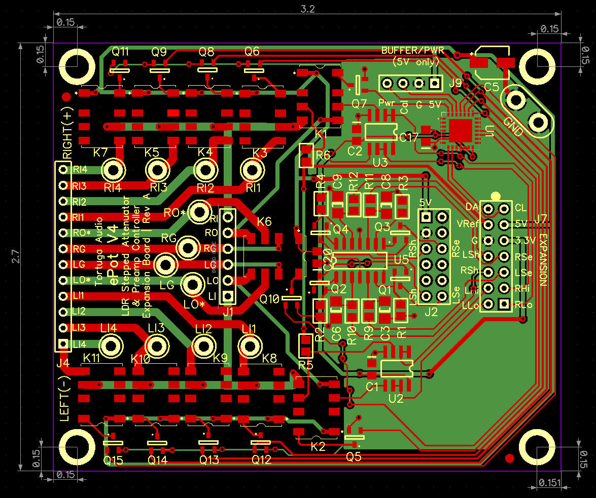

Here's the PCB layout for the V4 expansion board which is used together with primary V4 board for balanced audio applications. The expansion board has essentially the same layout and key control circuit as the primary board but is "headless" meaning it has no brain of its own. It's controlled entirely by the primary V4 board. In balanced audio applications the primary V4 board handles the right channel while the expansion board handles the left channel thus 4 total channels for balanced stereo attenuation.
The expansion board connects to the primary V4 board via a 14 pin ribbon cable. It's also 1 inch shorter but has the same width.
I'm waiting on blank boards from the fabricator which should be here in another week or so but what with all the tariffs and trade war noise there's a lot more uncertainty in shipment timing.

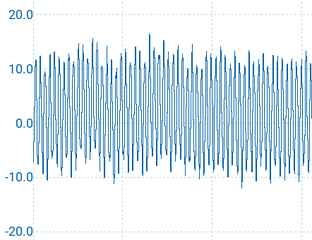

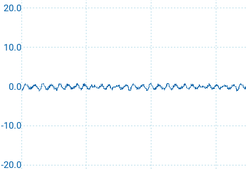

« Reply #59 on: 22 Apr 2025, 11:47 pm »
Heh All,
I've been iterating on the design of the HPS.V4 Hybrid Power Supply and believe I'm all but done with the development work and am waiting on latest boards back from the fabricator. Meanwhile I took a few simple Input/Output readings to indicate overall performance. In this specific instance, the input to the HPS.V4 is from a typical 5 volt USB switching charger. Not the worst I've seen but not the best either. I'm showing the before/after (input/output) taken at both 1 ms (1000 Hz) and 100 us (10 kHz). Clearly there's more high frequency noise but this is to be expected with switching power supplies. This info was taken using a common LM1117 5 volt linear voltage regulator. Better performance is possible with a super-regulator such as the one made by Sparkos Labs.
The vertical units are in millivolts and the horizontal units are time.
Here's the AC component of the raw 5 volt input to the HPS.V4 at 1000 Hz. Not terrible - a few millivolts.
Here's the AC component of the 5 volt output from the HPS.V4 - at same 1000 Hz. Dead quiet at lower frequencies - well under a millivolt.

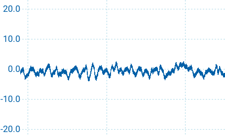

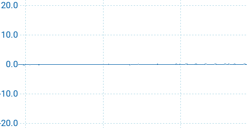

Next we take the same before/after look but with the sampling set higher at 100 us or 10,000 Hz.
Here's the raw 5 volt input. Clearly more noise at the higher frequencies but in absolute terms not awful at around +/- 10 millivolts.
Below, you see what the HPS.V4 does to the above waveform. Roughly a 10:1 reduction in noise magnitude.
Overall a very decent noise profile for a nominal 5 volt DC supply.
