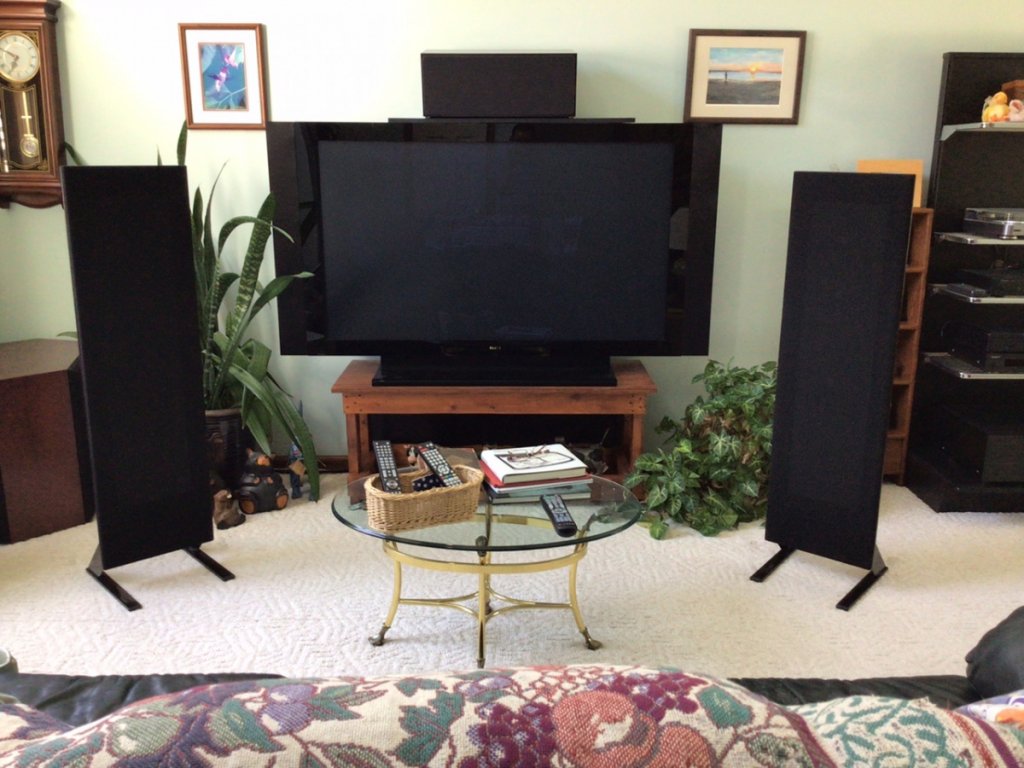

I took delivery of my LRS in October 2019.  I had read that tweeters out gives a wider soundstage and tweeters in gives more focus.  Being a soundstage fanatic, I opted for tweeters out from day one.
I’ve occasionally wondered what they would sound like tweeters in, so today I finally gave it a try; tweeters in with aggressive toe in to keep the tweeter panel a little further from the listening position than the mid/bass panel as recommended by Magnepan.  I kept them spaced pretty wide, pretty much forming an equilateral triangle with the main listening position.
To my surprise, I got both a wide soundstage and more focus, as well more depth.  I expected more focus, but thought the soundstage would shrink a bit.  Also, with the aggressive toe in, it sounds like I’m getting a little smoother treble response.  Perhaps I’m not getting as much treble energy reflecting of the 60” TV in between?
What’s been your experience with tweeters out vs in?

I suspect the radical toe in had more to do with the results than having the tweeters in or out.  To be sure you'd have to align the panels as they were previously but leave the tweeters on the inside, and then move the tweeters to the outside with the radical toe in.  I don't believe I ever stopped playing with placement with my modded MMGs until I sold them.

I agree the toe-in is the reason.
My listening room is not very wide, but I am 100% for Tweeters in.
I worked on the speaker position back when I had 3.6's and now the same position with my 20.7s. So much so I have the exact distances from side and back for each edge. So If I move them I can get them back exactly.
I also have a strong Toe in on my big Maggies.
With tweeters on the outside, aggressive toe in would place the tweeters closer to the LP than the mid/bass panel.  I know Magnepan doesn’t recommend that (something to do with coherence), so I haven’t tried it.  I’ve toed in as much as the tweeter being 1” farther than the mid/bass panel.
Interestingly, prior conventional speakers I’ve had in this room also worked best in an equilateral triangle and pointed to the main LP.
Toed in the way the are now looks odd, but they certainly don’t sound odd!  I’ll get use to it. 😁
