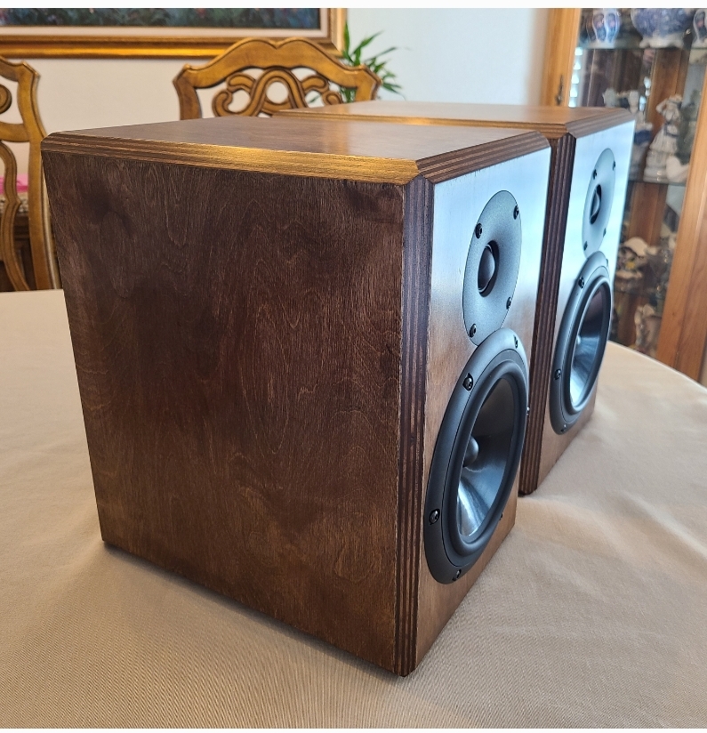

Greetings, my name is Frederick del Rosario. I am formerly a Audio Retailer and Installer from Asia. I have been involved in the Industry for about 20 years. I want to offer my services to anyone who needs help with Gr Research Products and maybe other DIY Projects. I am located in Victorville, CA 92395. I can help with: Assembly, Wiring, Crossover builds, Etc. even if you have an existing DIY build that you want to clean up the wiring.
I am just trying to help pay Medical Bills that are constantly coming. Our Family situation is not allowing me to work on a normal basis. I am a Audio Hobbyist at heart so I only charge a minimal fee. I am very Transparent and share build pictures with my previous clients.Thank you.
[email protected]
ATTACHED ARE SOME CLIENT PHOTOS:

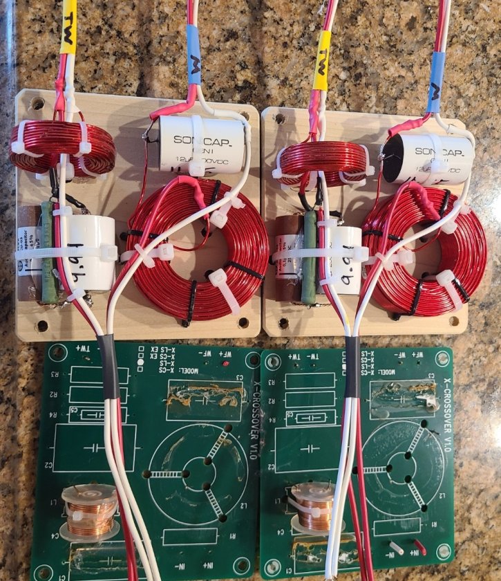

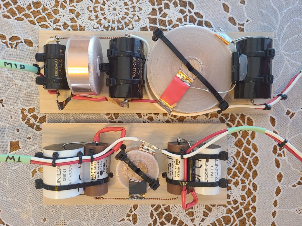

fre11111
  • Posts: 229
Hi Everyone, just wanted to post some photos. Thank you

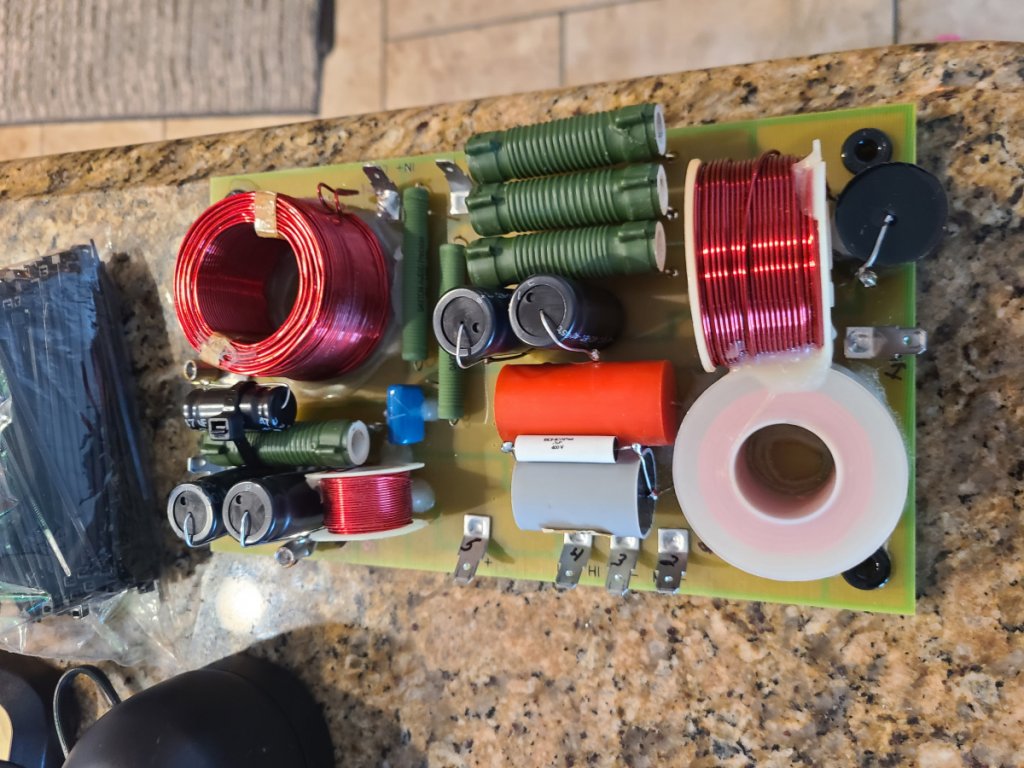

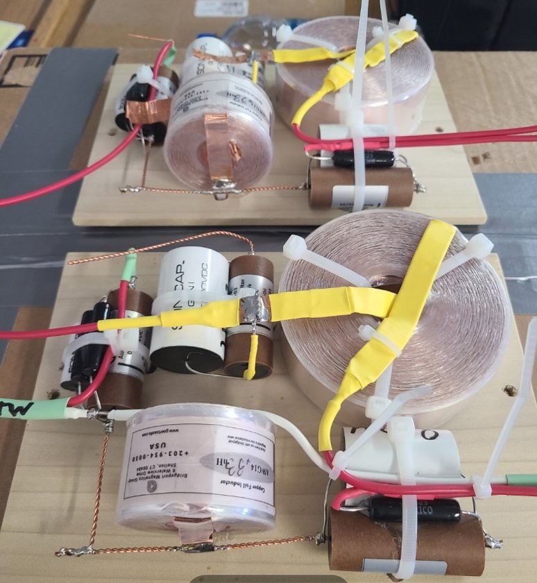

fre11111
  • Posts: 229
X-Statik Crossovers in the works.
« Last Edit: 26 Jul 2022, 04:03 pm by fre11111 »

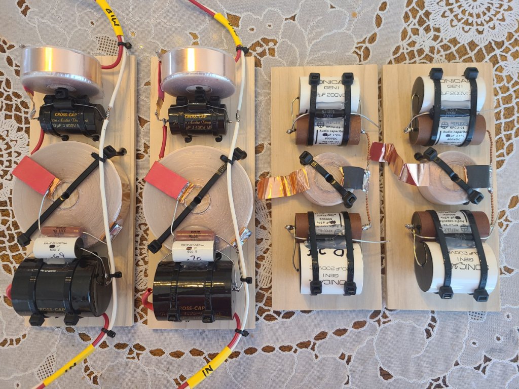

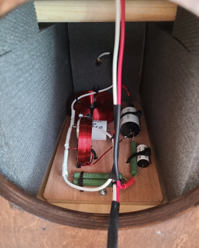

An Older PSB Floorstander, updating Caps and Resistors.
wingsounds13
  • Posts: 20
Those are pretty, but NOOOOOOOOOO!!!  :o  You're taking those beautiful copper foil air core inductors and putting steel bolts through the core?  Changing the inductance is the lesser of the sins, worse yet is that you are adding steel (cheap steel at that) to the magnetic circuit and turning beautiful and expensive air core indicators into iron core inductors.
Somebody, please tell me I'm wrong so I can stop shuddering.
J.P.
wgraft5
  • Posts: 203
  • Wayne in Oregon
J.P.
That was my first thought,Danny said not to put a bolt through the middle of an air core inductor because it makes it into a iron core which is bad for over 200 hertz.
Danny Richie
The guys that just responded are correct. You can't put a piece of steel through the center of the coils. That drastically changes their value and negatively affects the sound.
Use plastic zip ties instead.
fre11111
  • Posts: 229
Guy Sorry abou that. I will correct that right away. I am finishing up final touches and will post the updated photo right away.. Thank you.
fre11111
  • Posts: 229
Thank you for everyone who reminded me of this simple lesson. I am actually familiar with this changing Inductance being in the middle but honestly slipped my mind in design. I do appreciate you guys as always.
Frederick
Early B.
Frederick

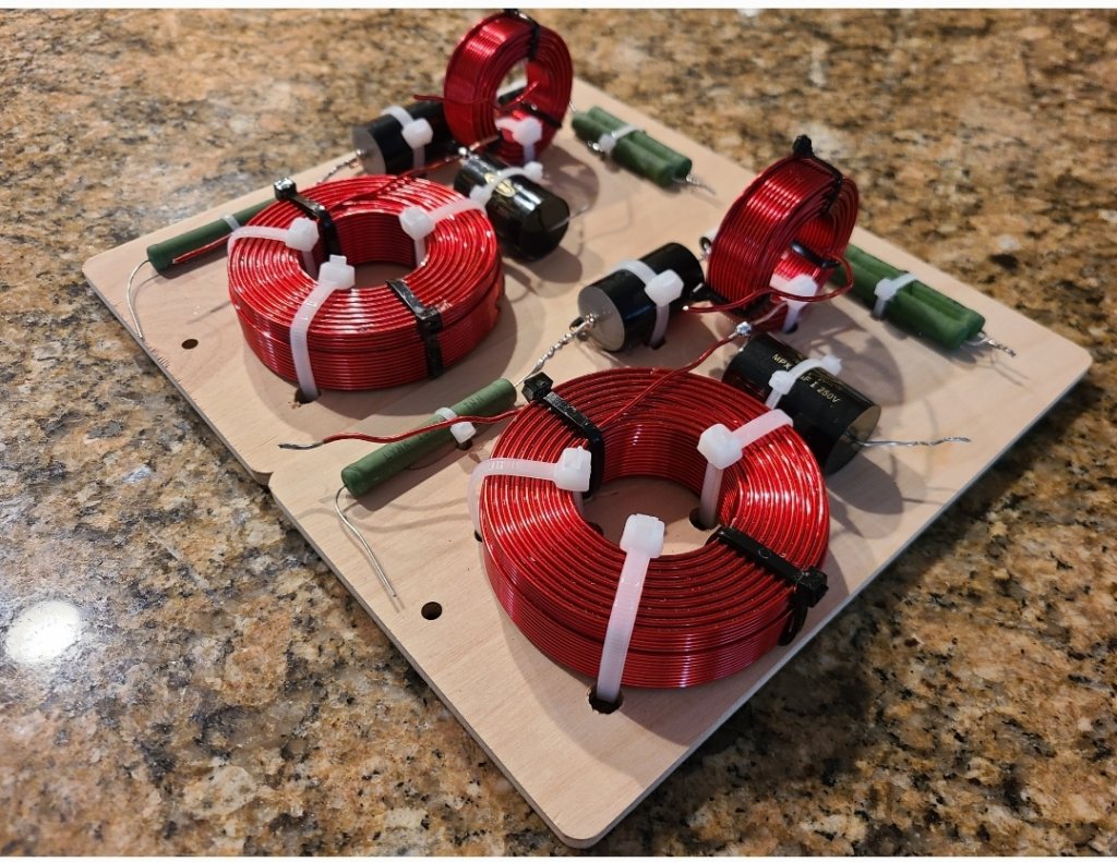

fre11111
  • Posts: 229
Hi Everyone, here are the updated photos🙂 Thank you for the support.God bless.

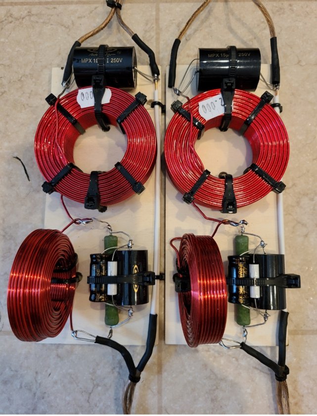

fre11111
  • Posts: 229
X-Statik Tweet & Mid Crossovers. The Tweeter circuit is waiting for some internal wires. Having them all separate will make it easier to mount inside the cabinet. These parts get heavy and heavy. Have a Greatday Audiocircle Community.
