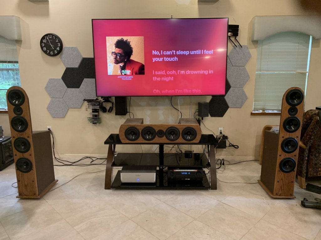

My AVM60 and the amp stack. TV is the beautiful 60" Panasonic plasma.
