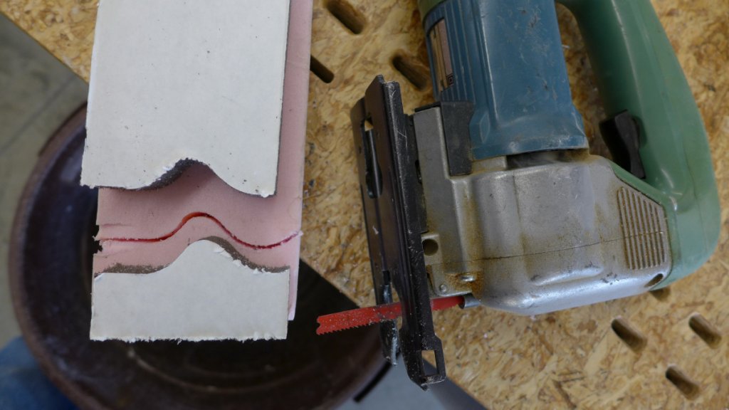

Been queried many times about NoRez cutting. It's really frustrating for some. I've been meaning to experiment with this and finally got some longer saber saw blades to give it whirl. Was kinda awkward flopping off edge of my table, but backing with foam gave a stable platform and a place for blade to plunge freely. May work for some and saber saw blades are less expensive than bandsaw blades.

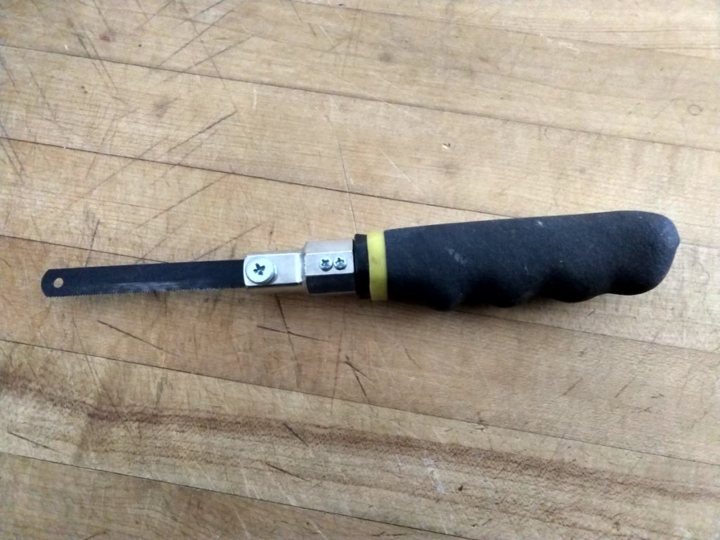

In looking at the No-Rez cutting post's I see what other's are using and some of their pitfalls. Here is a hand tool that works well. It uses any hacksaw or electric saw blade (of similar size).You pick which blade works for you (fine to course). It offers excellent control at "human speed" thus saving your fingers. You will be able to cut intricate shapes. Here is a link to a Stanley brand sold at Home Depot (as an example of one place to get it), https://www.homedepot.com/p/Stanley-4-5-in-Tooth-Saw-with-Plastic-Handle-20-220/100654917. See attached picture of the Tooth saw.
All the best to all.
