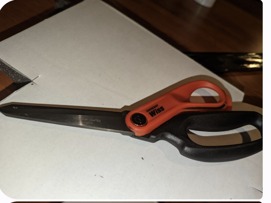

If you need to smaller pieces, and not use a power tool, these work great.  Got them at Home Depot.   They can cut through leather etc.
HT1278
  • Posts: 152
Re: No-rez cutting tool
« Reply #5 on: 19 Apr 2022, 05:42 am »
They are Wiss 10 in HD Tradesman Shop Shears.
Model #CW10TM
Home Depot generally has them in stock.

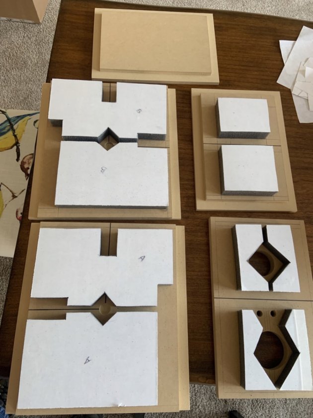

Hey all,
Thanks for all the advice above.
For those who have done the bevel-cuts to made the no-rez inside the sub baffles, did you do exactly 45 degree cuts, or did you do a little less to let the pieces push on each other a little since they are compliant?

« Reply #19 on: 20 Nov 2022, 03:30 am »
I cut No-Rez on my Saw Stop very regularly with no problems and I do not disable the safety.
The SawStop is how I ended up doing this. It worked incredibly well. A miter saw would work really well too.
I was beyond anal because I have giant 6 stacks and wanted the very-visible no-rez to look perfect. I ended up making a couple basic jigs and doing it on a SawStop and got to about 1/16th inch precision pretty easily.
Thanks to all the folks who replied when I first started this thread.
