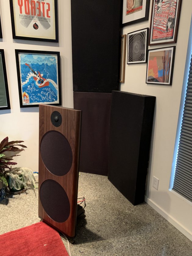

I ended up increasing the toe to about midway between neck and shoulder. It has helped to increase the focus of the vocals. I’m pretty much sitting in an equilateral triangle. Currently up to 60 hours or so.
I’ve also been experimenting with my GIK acoustic panels. I have always had 1 bass trap in each corner of the room, but decided to take the two I had in the rear corners and stacked them into the front corners, along with another GIK 244 panel behind each speaker (pic included). This has helped to clean up imaging and eliminate the room boom, while ultimately unmasking more of the details in the music. On the flip side it also makes the speakers sound lean and thinner, but I’m wondering if that is just the true sound of them at this point in their evolution. In you guys experience does the bass deepen and become more pronounced over time?

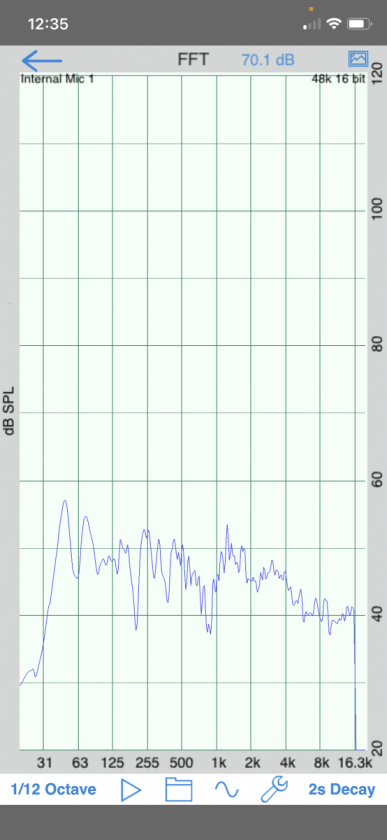

Thanks for the tip Tyson! I found a -20db pink noise track on Spotify and let it play. Here is the graph I got with my phone in the listening position. I don’t really know what to make of it. I left all settings as-is, aside from switching to 2s decay.

As for bass in that measurement you did not apply any smoothing but it looks like if you avg the response you are a few DB down right around 32-36hz which is what you should expect in room. As with any speaker as you move closer or further away you can be in a peak or null so assuming you are in about an equilateral triangle you an experiment moving forward and back 12-18” for a total of 24-36” variance and measure again.
From what I am seeing I would say that you are likely fine where you are.
Now as woofer compliance is achieved in mechanical breakin the bass will likely sound deeper. As for toe in try what I outline above. Happy listening!

Thanks for taking a peek at that graph. It’s my first time running any type of measurement like that, so I wasn’t really sure how to interpret the result. But glad it doesn’t seem to be too out of whack. I’ve got the speakers on the long wall to be able to get a better spread, so I can’t really move back much further or I’ll be too close to the rear wall. I’ll play around with it a bit though.

Try moving 2 of those GIK traps to the middle to cover the window/ blinds. Its a free, quick and easy listening test.

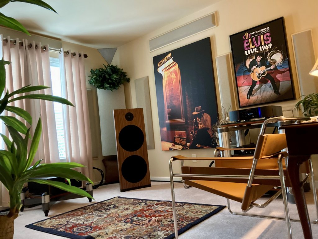

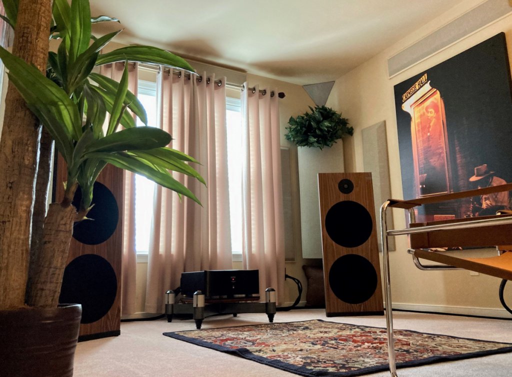

« Reply #18 on: 18 Apr 2022, 02:35 pm »
Thanks for the feedback fellas, it’s greatly appreciated!
"I added that 244 behind each speaker and it thinned out the sound"
Well, that might be the issue, you would not keep it there. Perhaps on the side walls. I add a faux rubber plant tree to my room on the wall by where I sit, it is about 6' tall, and I could not believe that improved my room acoustics thus the sound became more focused in front of me and the bass became more dynamic. More so than a new piece of gear could have improved the reproduction of music. Rooms do matter.
Mr. Big
  • Posts: 656
Re: M3 Sapphire Toe-in
« Reply #19 on: 18 Apr 2022, 02:37 pm »
Note no glass pictures around the room they are the worse for reflecting sound around the room, only Canvas prints, acoustic panels, and even Flaux plants on top of each bass trap. So different materials and forms and shapes throughout the room. The room is neither too dead nor bright.
In the large window between the speakers, I have the blinds tilted up a bit (like a diffuser) with heavy drapes and one ASC 8" X 48" diffuser panel in the middle of that window behind the curtains, even that one panel made a huge improvement in center imaging. I am lucky to have my own loft area for my system, and lucky again to have no wall behind me where I sit, due to the loft being on the 2nd level with the family room below me, the wall in the family room is 50' from where the speakers sit.
