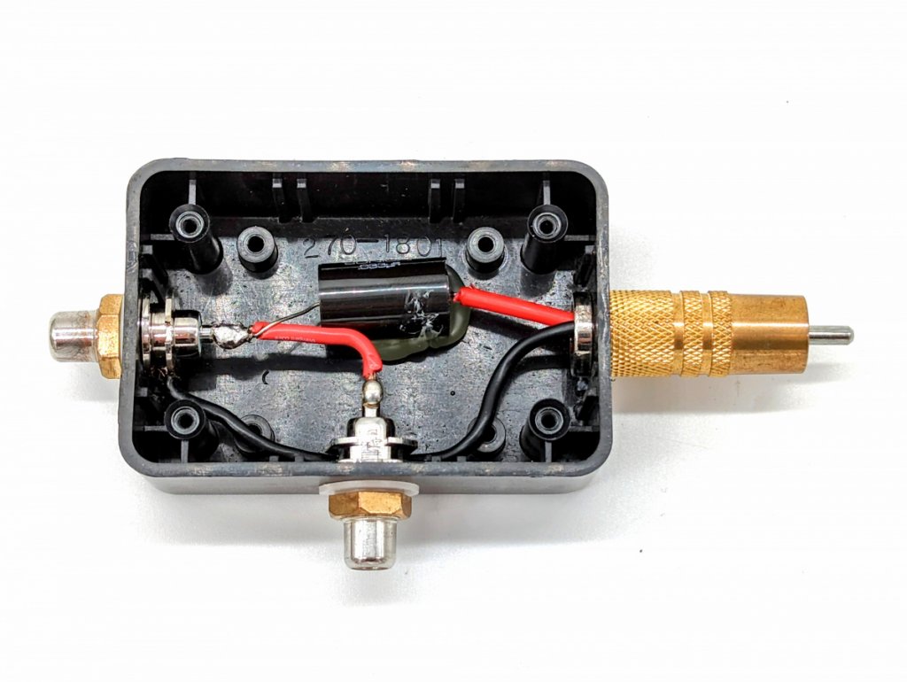

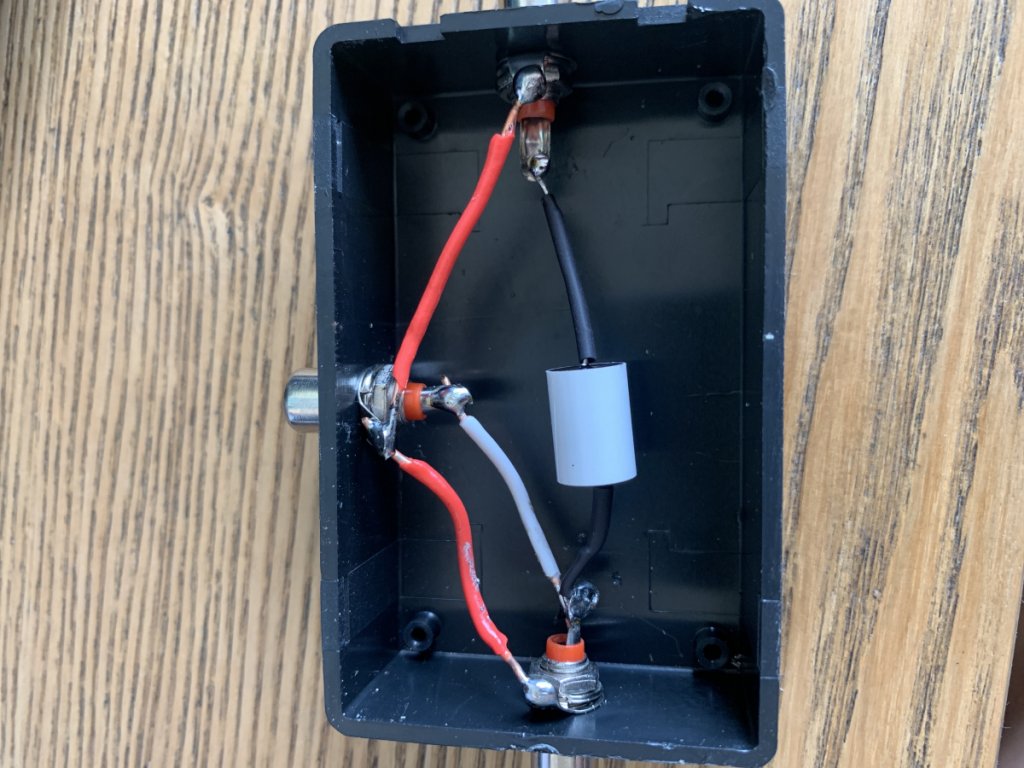

Here's the insides of that same filter
Here’s my version, but I’m getting really bad noise come in through these. I can tell why, since there’s a decent amount of exposed wire, but what can I do to fix this? Thanks!

That's really odd, my guess would be either a bad connection somewhere, it's being placed too close to other electrical devices, like a transformer within an amplifier or other electrical device, and it's picking up a lot of electrical noise from it, like an antenna, or it's somehow creating a massive ground loop.
Does the sound go away if you touch the outer housing of the full range output, or does get worse?
If it's acting like an antenna, or has to be kept close to powerful transformers then using some copper shielding kits on the inside like you see for guitars may be a good idea to reduce/prevent EMI issues.
https://www.stewmac.com/electronics/shielding/self-adhesive-shielding-kit/?utm_source=google&utm_medium=shopping&utm_campaign=2022-09-gp&gclid=Cj0KCQjwj7CZBhDHARIsAPPWv3d3h9QOx80RGneVEPEByXqoI-8k1tidif-GergTGkJRliAVUdPDJKQaAsMyEALw_wcB
I would also check if it's causing a ground loop. Do both connections exhibit the same noise issue? does it exist if only one connection is made, or is it only with both connections are used that the issue arises?

I am kind of wondering if it is a ground connection issue.

Those solder joints are horrible. It's probably diode effect from the cold joints causing RF pickup.
1. The leads ends are tinned first.
2. A good mechanical conection is made to the solder tabs before soldering.
3. The ground tabs should be positioned between 2 nuts not compressed between one nut and the plastic case.
4. You need to apply enough heat to allow the solder to flow uniformly without spent solder sticking to the iron when removed.
5. Practice.

I hadn’t had any issues all weekend. I run my music off of a desktop, but today as soon as I arrived with my work laptop to put in more hours at home the sound started again, so I’m wondering if it’s picking up WiFi noise.
Edit:As soon as I got done working I turned off my work laptop and the issue went away. So it’s definitely causing some signal to be picked up by my filter.

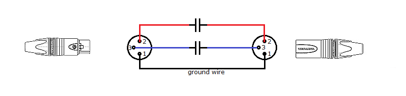

Heres a basic one i drew for someone else:
Would this work for balanced interconnects? If not what would that circuit look like?
Balanced is going to be quite different
It will be like this:

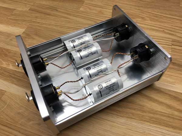

Here's one with both channels in the same chassis:
Hobbs. Thanks for this picture. But on which lead do we connect the sub out, if I use rca? XLR looks obvious, but do show us. Thanks

If you want a full-range RCA out on an XLR bypass:
Positive will be pin 2
Negative will be pin 1
If you want an all RCA filter with both full range and highpass:
Left: input from preamp
Bottom: full range out
Right: high pass out
