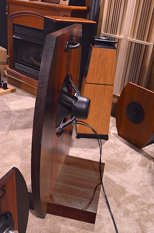

Not at all, unless your expectations are very low. The only way to noticeable increase detail is removing the xover and use a full range driver>
https://www.lii-audio.com/product/recommended-15-full-range-speaker-driver-for-music-loudspeaker-with-tube-amplifier-f-15-in-pair/
The use of xovers remove the music harmonics, small details and the 3D ambience that are lost as heat, as well as decrease the speakers sensitivity.
Dont fix what is not broken.
The problem with full range is that you move the distortion from the Xover to the drivers.  Having one driver do all frequencies causes doppler distortion. Complex music with a lot of things going on can also sound a tad blurred at least that is my experience with my previous Omega speakers.
  • Posts: 21447
Seems you was using FR in hi SPL, Iam using FR since 1990s and never heard blur image, small soundstage etc I can positively recommend single point source, just good sound.
Also never heard about doppler in speakers.

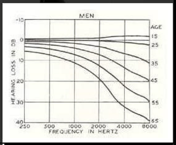

Iam about 60 years old and my ears barely reach 15kHz, so as you registered in 2003 with 73 I suppose you now have 92 !  What would give you poor listening capabilities so low as 8kHz or 10kHz.
