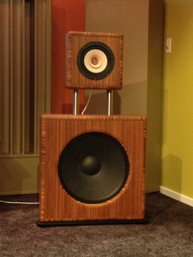

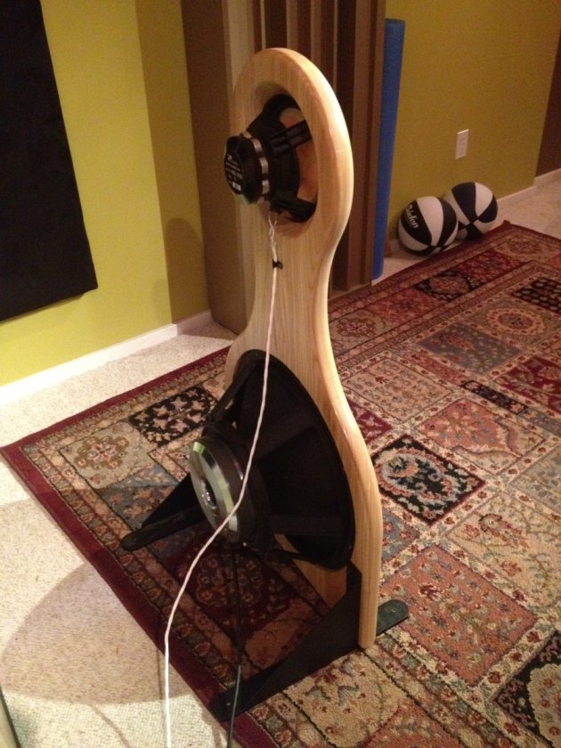

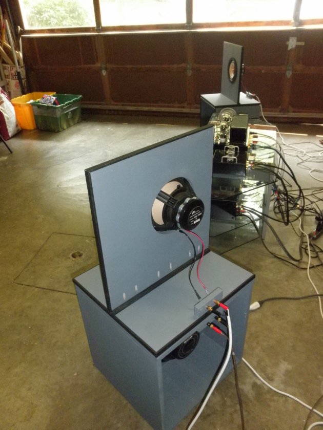

I built these out of drivers I ended up with in trade and scraps from other jobs. TB 1808 and a big Radian 18" woofer in a couple of different configurations.
Fun stuff.

Those r gorgeous…..I am not in recovery yet  ……
