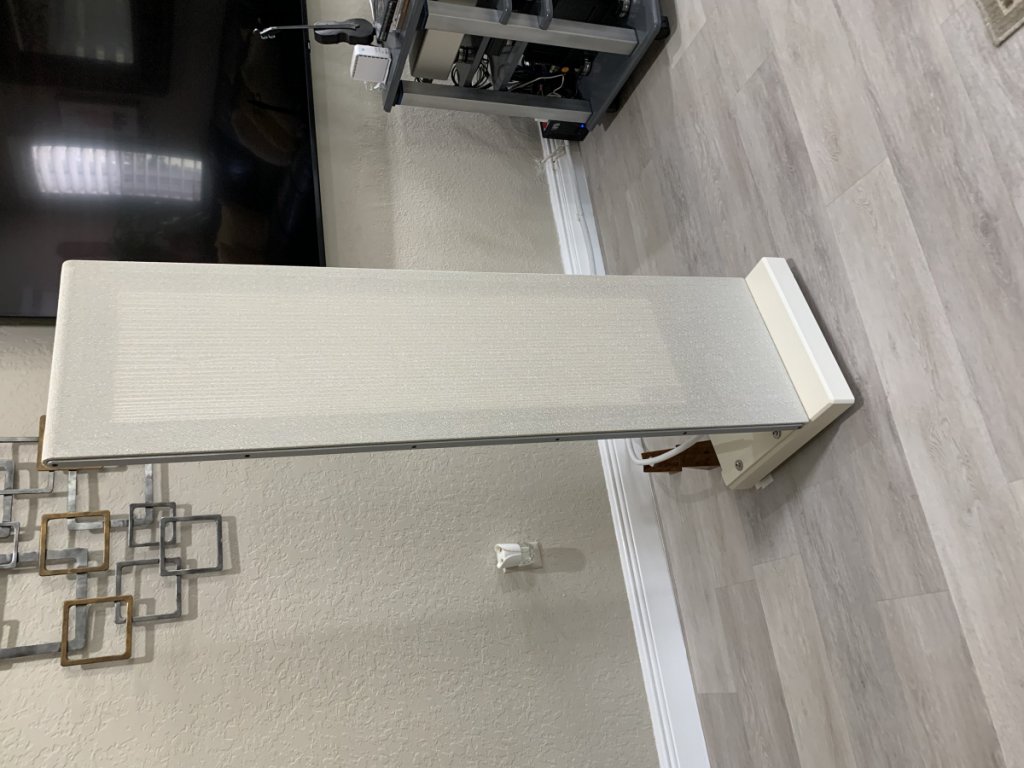

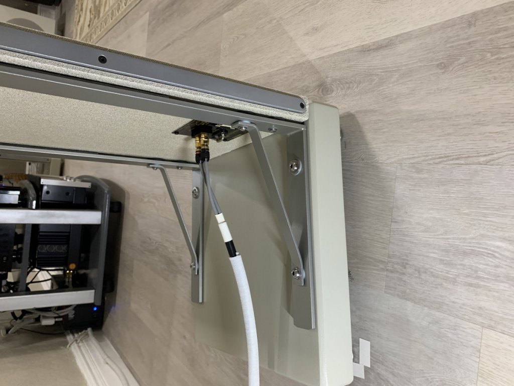

Hi BikeFi10, the metal thickness is 1/4” , I ordered steel lengths pre cut from Online Metals, my neighbor has a small machine shop in his garage, so he drilled all the holes and welded the brackets for me at the ninety degree angle.
I could have made the verticals taller, but they get too heavy and I was trying to keep things as less cluttered looking as possible. They do not eliminate all the sway, but I would say at least fifty percent. I have since added some new support brackets that takes it to about eighty percent. I could go from the lower support straight up to the top hole in the vertical which would be even better, but I don’t think the trade off in esthetics would be worth it.
The top holes are not centered because I wanted the TNuts
I placed in reverse, to be centered on the wood frame of the speakers. I also wanted to stay away from the inner edge of the frame as I couldn’t tell if any of the ribbon attachments may be affected.
The verticals are 25” tall, that’s 4” less than half the length of the .7. You can go higher depending on the model you have, but it will need more support.

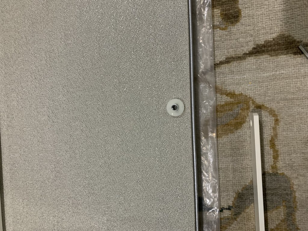

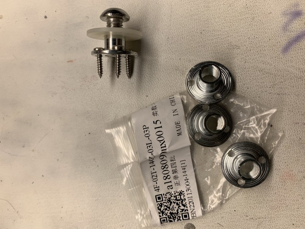

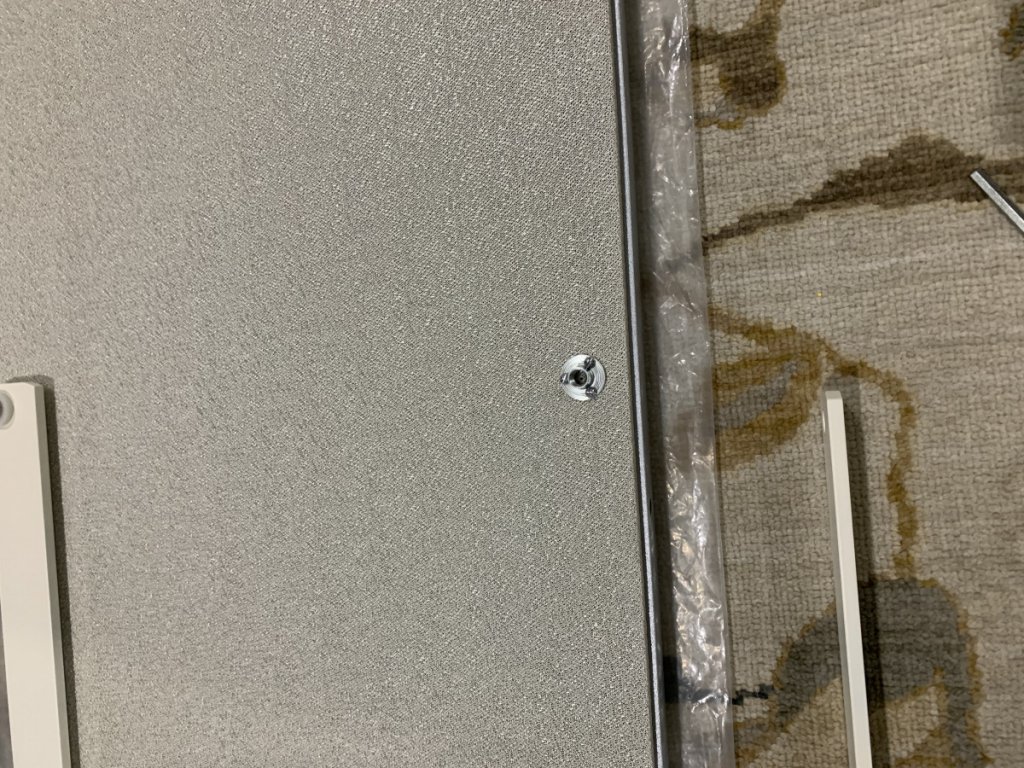

I didn’t drill, I thought about it and decided the only way to do that,
would be to remove the sock, and I wasn’t doing that.

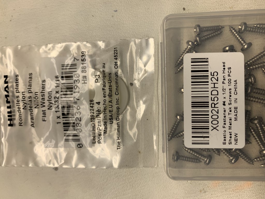

So I came up with idea of using these nice Tnuts I found on Amazon in reverse, using three tiny #4 screws. Let me tell you, whatever wood the frame is made of, it’s really hard. I just used small punch to start the holes.
They are placed right over the sock.
Once the three screws are in, I use a flat washer over them so they don’t eat into the painted brackets. The washers also provide a little damping between the parts.
You can check out the TNuts, the dementions were perfect for me.

Hi,
I think 3/4” msg boards may be too light to hold the 1.7s from tilting forward. I know it wouldn’t hold the .7, and the 1.7 is much heavier and taller. You could add weights to hold it from tilting, but I wouldn’t want to depend on that.
I used the same TNuts between the speaker frame and the brackets, but I turned them upside down and made the holes in the brackets just big enough for the shaft to go through. Here is a picture.
I got them from Amazon, I will look them up and send you the info later.
