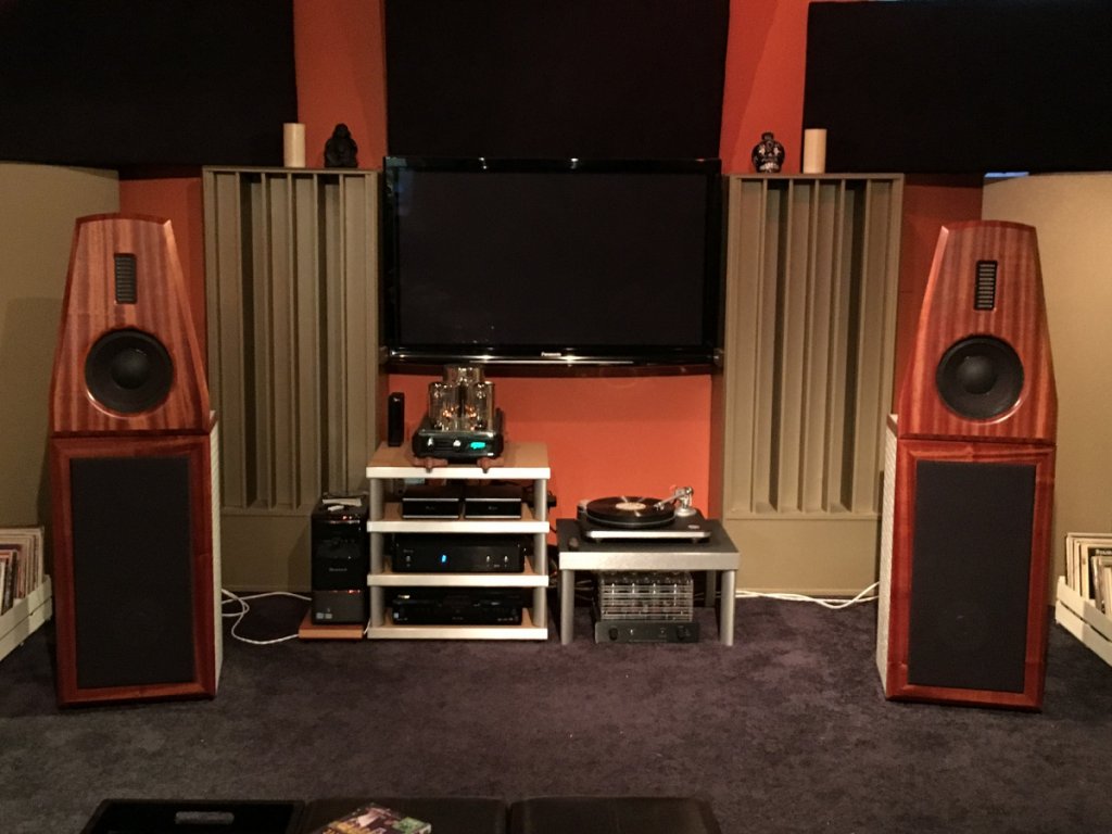

Ah, although they are about 4 feet off the front wall there is an equipment rack in between, that would be hindering some breathing space to some degree. I won't be able to rectify that until the room is remodeled and the rack relocated. I played with lots of frequency settings and think I settled in around 50-60Hz.

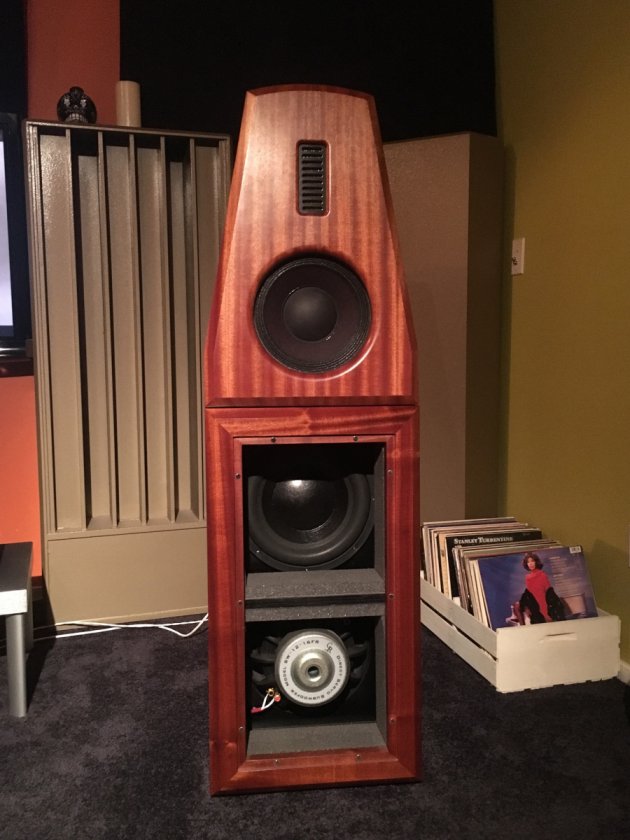

Also, put them as close to your main speakers as you can.  They are not like normal subs that do better in the corners.  They do best if they are right in line with the main speakers.
Got it, that I did inboard of the mains. Eventually will be outboard. I've seen others place them a foot or two behind the mains possibly to get them out of the soundstage area?
Or on top.

Or on top.
Well, those are gorgeous.
Woodsage
  • Posts: 134
    • My YouTube Channel
Re: OB Sub First Impressions & Break-in
« Reply #17 on: 1 Mar 2022, 05:03 am »
Well, thank you!
