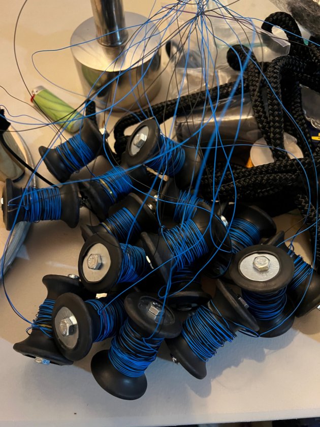

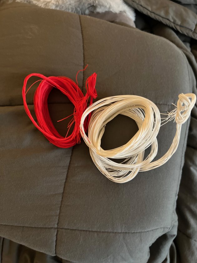

The materials consists of:
solid core silver
teflon insulated
each strand measures approximately .3 mm diameter which is about 29 gauge.
There are 36 individual wires per pole (36 for + 36 for -)
Length is just about 3 meters.
TOTAL
64 wires per speaker cable times 2 speaker cables @ 3 meters.
Group dev
I have a few ideas for what to do with the wire. I genuinely think the overall material quality is pretty damn good. most of my ideas surround doing something unique with geometry. I have purchased a nylon core that I was thinking of using in the middle ala Breathe C, the only difference being the way I approach the geometry must be different because of the way the materials are arranged. The original arrangement can only be described as a 'shotgun' arrangement. IE no geometry, all wires were just straight shot from amp end to speaker end.
After a day of untangling an absolute rats nest of wire, I have everything separated out, spooled up and ready to go! All that's missing is your feedback on how we should proceed. We're looking forward to your feedback!

One question - if you braid it, will it end up being shorter than the original speaker cable?
Pez
Re: Group project: mresseguie Silver speaker cable
« Reply #2 on: 14 Feb 2022, 09:07 pm »
Great question, It definitely will. The goal is to end up with 6ish feet (2 meters) so my braiding options are somewhat limited.

I’d probably twist all the white wires together and twist all the red wires together.  Then twist the grouped red wires and grouped white wires together.
