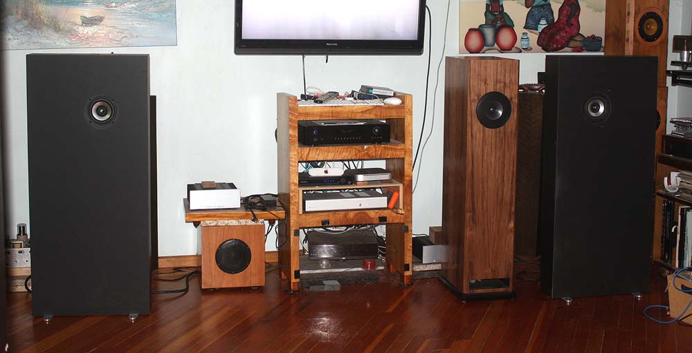

Check out my system for a picture of my loudspeakers (just updated).  The 3/4" MDF cabinets are 46" x 11" x 15" with one angled fold that runs the height of the cabinet (front baffle is double layered).  The interior partition is laminated with drywall and fiberglass on the driver side.  The loudspeaker vents on the back 18" from the top.  The black oval is there to extend the driver out away from the partition.  Back in my purist days I eliminated the binding posts.  Like the angled chamber to direct back wave away from the driver.  The loudspeakers were commissioned.
Have used a SET tube amp, a push-pull tube amp, chip amps, a number of digital amps, even a class T amp with them.  The SET was too weak, the class T did remarkably well, chip amps were the rage and supposedly well suited for single driver loudspeakers, the push-pull amp was OK but didn't suit my lifestyle.  The latest class D I've settled on have been from Temple Audio in jolly old England.  The F200a is rated at 27 watts continuous (8 ohms) and 80 watts peak.

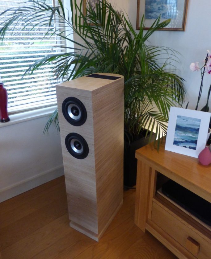

I've built quite a few speakers using Jordan speakers and although the earlier JX92s model could be shouty if not toed in to cross in front of the listener, I've never had any problem with Eikonas being shouty.  I've built single driver cabs, twin driver cabs and 4 driver per side TLs but my favourite is the twin driver TL3.  It has nearly as much extension as the 4 driver TLA but seems, to my ears at least, to have a bit more air.
Here's mine, built from translam birch ply when that wasn't as expensive as it is now :(
