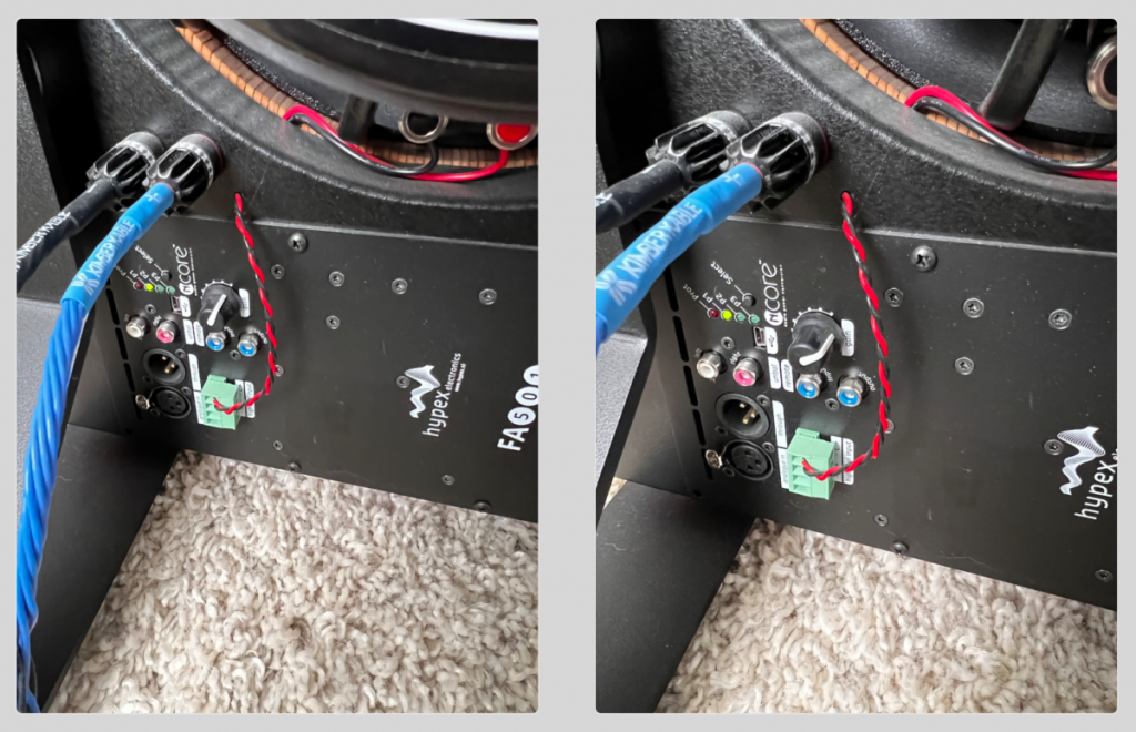

DBT, thanks for listing those tracks. So, I do get some clipping with some of them if the knob is turned all the way, past the last tick mark, to where it won't turn any further. I put a pic below to illustrate the difference. If I back it off just slightly from that position (image on the right) it doesn't clip. Is this what you've experienced?
FWIW, I noticed the amp module was different from what was shown on Spatial's site when I took delivery in the spring of 2020. I discussed with Clayton at the time, and from what I remember of that conversation is that the 251 module is standard for both the X5 and X3, and he was only using the 501 due to supply constraints. I think performance was expected to be the same regardless. He also mentioned that the vol control is programmed to have a specific range of adjustment.
JTF, I cannot set my subwoofer volume on the last tick mark without it clipping when I play, just about, any R&B or contemporary jazz songs that tend to have more bass than traditional jazz, for example.  I have a big room, so I have to turn up the preamp volume a bit, but it's at a reasonable listening level.  I can set the subwoofer volume, slightly, past the second to last tick mark on majority of the music I listen to, which is 90% traditional jazz, but I'm still not totally satisfied with the bass response.  It's amazing how you don't get any real bass response until you turn up the subwoofer volume to the last few tick marks.  I've never experienced this with any of the box subwoofers I've used for my surround sound setup.
I set the subwoofer volume on the second to last tick mark for the bass heavy songs that generally cause clipping when I go past that mark. See picture below.
The different amp installations due to supply constraints does sound like a familiar conversation I had with Clayton at the time I was purchasing my X5s, but I wasn't clear on which plate amp each X model was originally supposed to have?  So, your response explains it.  Thanks so much for testing those songs on your system!
My takeaway from conversations with Clayton was that the gain control is setup to be a fine adjustment over a smaller range. So, if a regular sub is 0 to 10, absolute minimum and max, the X5 is set to cover like 5-8 or 6 to 9, something like that. Does that make sense? I could be wrong but that was my understanding. The range of adjustment seems to be from where the knob clicks into place at the 9 o'clock position, to whatever max is. Below that I don't get bass, but the bass does get stronger beyond the last tick mark.
You're welcome, glad you found it helpful.
Yes, that explanation makes sense. I spoke to Clayton about it shortly after I received my X5s and he didn't seem to excited about the gain not having a more gradual increase of bass like most box subwoofers and supposedly, the manufacturer could not change that.  I guess it doesn't really matter as long as you get the bass tuned to your liking.  You are correct concerning how the bass gets stronger beyond the last tick mark, but my 250 watt ran out of gas and started clipping at that point, although it sounded good with several songs that I've tried at that setting.
