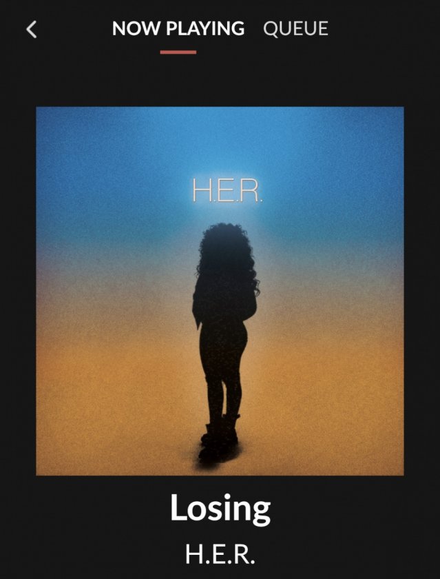

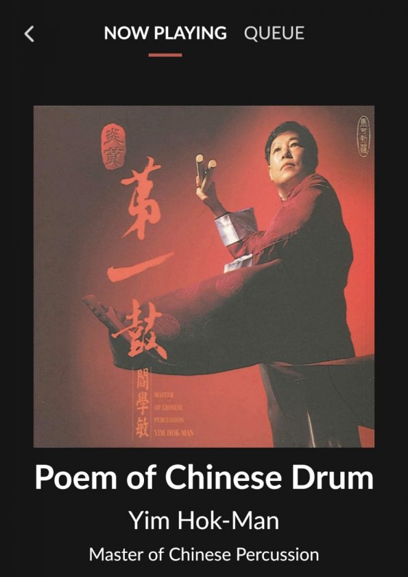

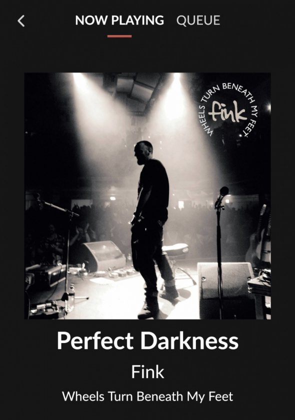

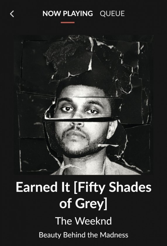

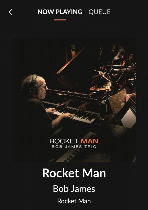

JTF, I really appreciate you doing a test run with some of the tunes that caused my 250w plate amps to clip.  So, I have a few screenshots of the songs below.  The title of the tracks are in bold font.  Thanks so much!
