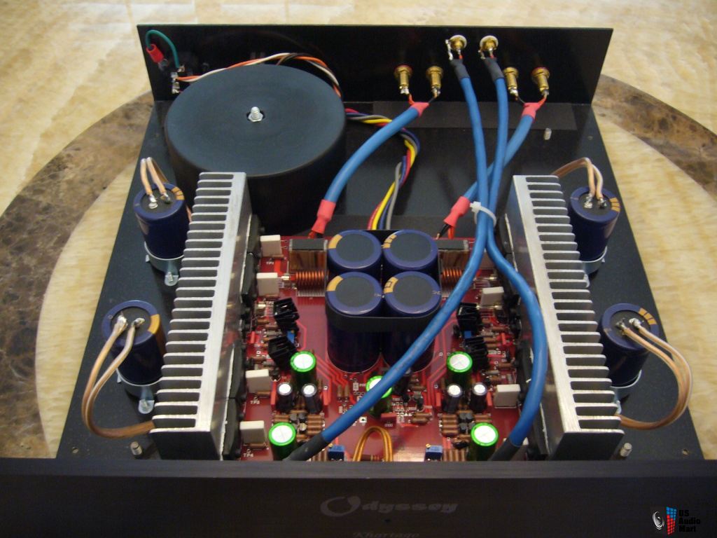

Hello, A fuse on the left channel has blown on the amplifier. I replaced the fuse and it was back up and running. After a few days when I turn on the amplifier it makes a loud buzzing noise back by the on off switch.  Could this be an issue with the power supply? Thank you for any input.

Does the cover come off to change the fuses?

Yes the cover needs to come off.

Could the transformer be touching the cover?

I don't think the cover Is touching anything,  I removed the cover and plugged the amplifier in with the same results.

You've probably checked the transformer bolt and cover already, but if something's loose it could amplify the buzz substantially.
