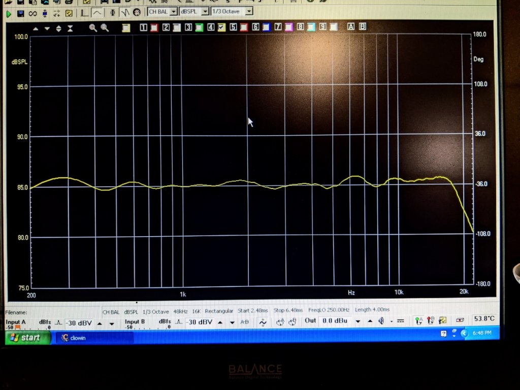

We got a few test LGK test cabinets in on Monday while Danny was away and I managed to get a flat line out of them...
BUT it took 3 notch filters, and an impedance of 3.2 Ohms.  :duh:
Once Danny got back, and had a chance to look at it, he noticed that the port was chuffing heavily at 76Hz.
We've made some adjustments to the design and the port, and are waiting on a new sample cabinet. But we're pretty confident that this next revision to the cabinet should be the last, which should get us a really clean response,  and simply the crossover.

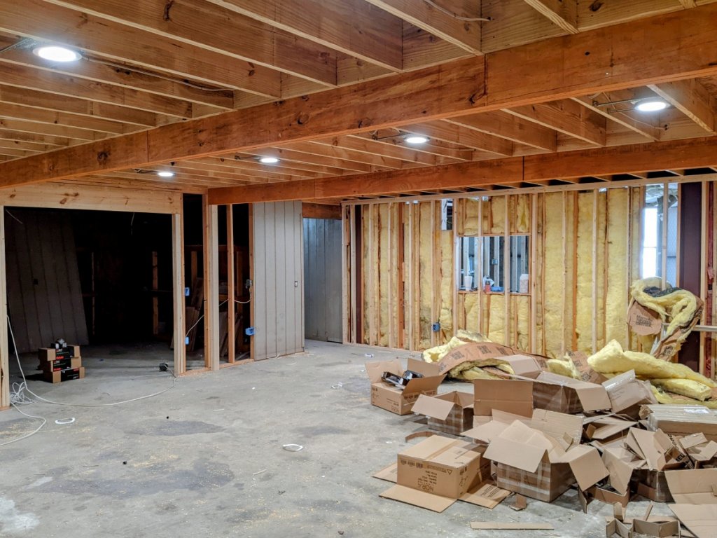

Some Big changes are happening in the shop as well!
The new shop area is coming along, nicely, and the lighting was just installed this week! It'll be nice to have some more space to work, as well as storage for parts, boxes, tools and other general backstock.

Wow Hobbs.  It might have taken a few filters but that is an extremely flat frequency response!!!!

« Reply #31 on: 29 Jan 2022, 03:09 pm »
Indeed! Hopefully with the next test cabinet, we can manage the same results without the need for 11 parts..  :P

Amen to that Hobbs. How about that lumber. Man that must have cost a bit. Why not go for steel framing? Introduce unwanted noise?  :lol: :lol: :lol: :lol:
The new shop extension does look good though and the anticipation on getting in there must be palpable. :)
