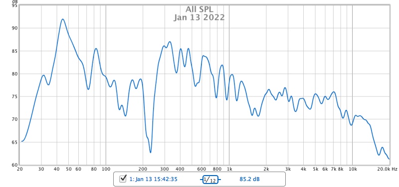

Re: REW is so depressing!
« Reply #80 on: 13 Jan 2022, 07:07 am »
It's likely the suck out is boundary interference known as the Allison Affect. The rule of thumb is to not put the speaker, in this case the middle driver, at the same distance (or in multiples of that distance) from the floor, front wall or sidewall. The suck out will be heard anywhere you sit in the room. An ideal formula to avoid this that I read is, measuring from the center of the middle speaker, the shortest distance to a boundary (likely the floor) multiplied times the longest distance (likely the front wall) should equal the middle distance (likely the sidewall) squared. Give it a try if you can.
« Reply #81 on: 13 Jan 2022, 01:38 pm »
Thanks Al,
I did not try moving the speakers left or right.  I should try this.  As I look over the measurement and knowing the subwoofers are crossed over at 90 Hz, the drop from 100 Hz to about 130 Hz is all mid-range driver.  My speakers are back on sliders so I can get the additional measurement done when I get some time.
What is weird to me is that I have truly loved the sound the speakers are producing.  I never once felt I was missing anything, two channel Stereo or five channel Surround.  In fact, the wide soundstage and depth is so good I am thrilled.  I've never experienced having my speakers disappear and an entire orchestra behind them.  I'm striving for + or - 5 dB all across the spectrum.
Marcus
abomwell
  • Posts: 366
« Reply #82 on: 13 Jan 2022, 02:59 pm »
Yes, it is the midrange driver that will likely benefit most by getting the boundary ratios better. Most people never notice the suck out between 1-3Hz until it is restored. That's the power range of the orchestra, where the trombones and cellos live.

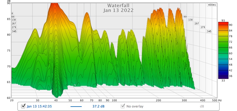

Thanks for circling back with additional measurements Marcus. How does the new waterfall plot look?
In the interest of full disclosure, here are my awful looking plots. The FR is horrific, waterfall not as bad. As you can see, I have a couple of major issues. The first is the 40Hz peak (probably room resonating frequency). The second is a 200Hz suckout. Fortunately it is short-lived.
So my issues are even worse than yours. Since I have M3 Sapphires and I'm not running subs, there isn't much I can do. The speakers are actually in a better location than before (the bass peak was even worse) and I have about all the treatments I have room for in the room. But the good news is that, just like you, I love the sound. I do have a little Schitt Lokius on order that may help but they are so backordered that it could still be a while before I receive it.

The thing to keep in mind is that this is the sound of the room.  No matter what speakers you put in there, you'll end up with the same graph.  Because it's not the speakers, it's the room.  Actually that's not quite true.  Because if you put a box speaker in that room, it'll measure even worse.

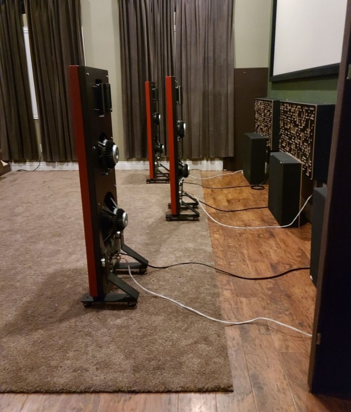

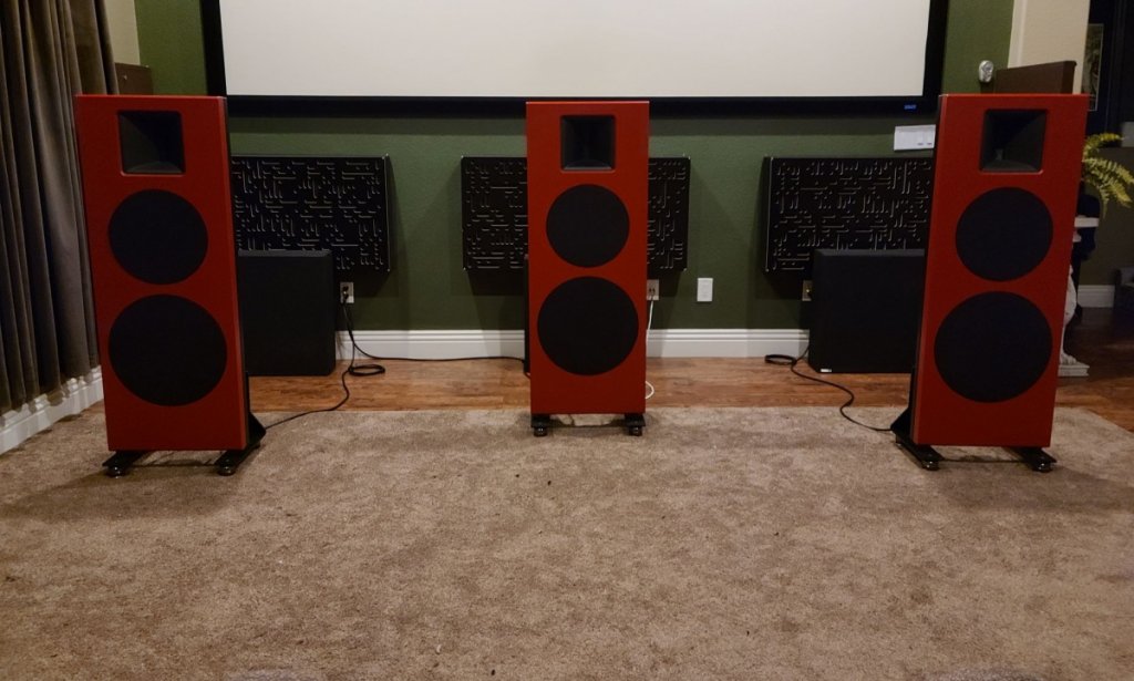

Okay, I lied about no more posts from me (LOL).  After I repositioned my speakers to their original location, I did not put back my bass traps, one behind each speaker (2x2 GIK monster bass trap with range limiter).  REW showed no difference with or without them.  After a few days, I decided to put them back in place.  Listening again, there was a noticeable increase in instrument clarity and depth.  How can this be?  I don't know.  Maybe subwoofer SBIR was clouding the music.  But, whatever the reason, I am very pleased with the sound.
Positioning:
-- Left edge of left speaker 20 inches from left side wall (exceeds the minimum 18 inches for side cancellation).
-- Left & Right speakers about 66 inches from the front of the baffle to the front wall.  No toe-in.
-- Center speaker 52 inches from the front of the baffle to the front wall.
-- Left & right speakers are 9 feet apart, center of baffle to center of baffle.
-- All three speakers are equidistant, 10 feet 7 inches, to the MLP.
You will also notice two GIK 2 inch thick absorber panels flanking the listening area (one along each side).  They were stored in a closet, not used, so I decided to use them.  Can't hurt having them there.
Marcus
