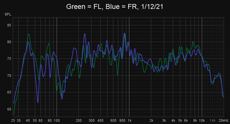

I finally ran more sweeps today.  As you may know, I have GIK diffusor/absorber panels on my front wall.  I also put bass traps along the floor behind each speaker.  I ran the sweeps with the bass traps and without the bass traps.  No difference at all.  I moved the speakers closer (from 5 feet) to the front wall.  The sweep showed a worse response.  I moved them further out in my room (WAF was not happy).  But, no real change from my original measurements.  Lastly, I moved the speakers back to their original position but turned the volume down to 50%.  Whoa, bass literally disappeared.  I turned the volume up to where the white line is in the middle top position.  This helped.  But, I'm not sure I will like it this way with bass much lower.  I need some time to listen.
I'll put the new measurement below, 1/12 smoothing.  If I use 75 dB as the mid point the peaks are only about 5 dB.  The frequency at 55 Hz drops off about 12 dB and is fairly narrow so I'll ignore it.  But, 100 to 140 Hz is down 10 dB.  Frequency trails off at about 12K but I can't hear anything above that anyway so it doesn't matter.  This was an interesting exercise.  I'm no expert but there is nothing more I can do.

Seems like the volume was the root cause of peaks. The nulls appear to just the room and mic position relative to the speakers. Not really to surprised on with or without passive traps, you need a lot of them to make a difference. I have 8 large corner traps and 8 wall mount traps to create a measured difference in FR.

I did run the sweeps numerous times with the same result so I guess the results are accurate.  I still have my old box subwoofers in the rear of the room (SVS SB13 Ultra (with the amp upgrade)).  I may turn those on and see if they fill in gaps.  Might be a fun exercise.

Marcus, if you can manage it, try putting subs in opposite room corners. In my room, with other speakers, it made a huge difference in filling in nulls.

You may want to experiment taking some measurements with the subs off and moving the speakers to see if you can improve the null in the mid-bass, then turn the subs back on and see how everything looks. Using one or both of your box subs could help but that null is pretty high. Experiment with position and running one of the subs out of phase with the others.
