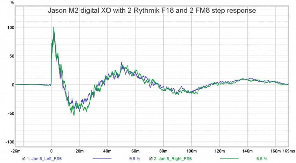

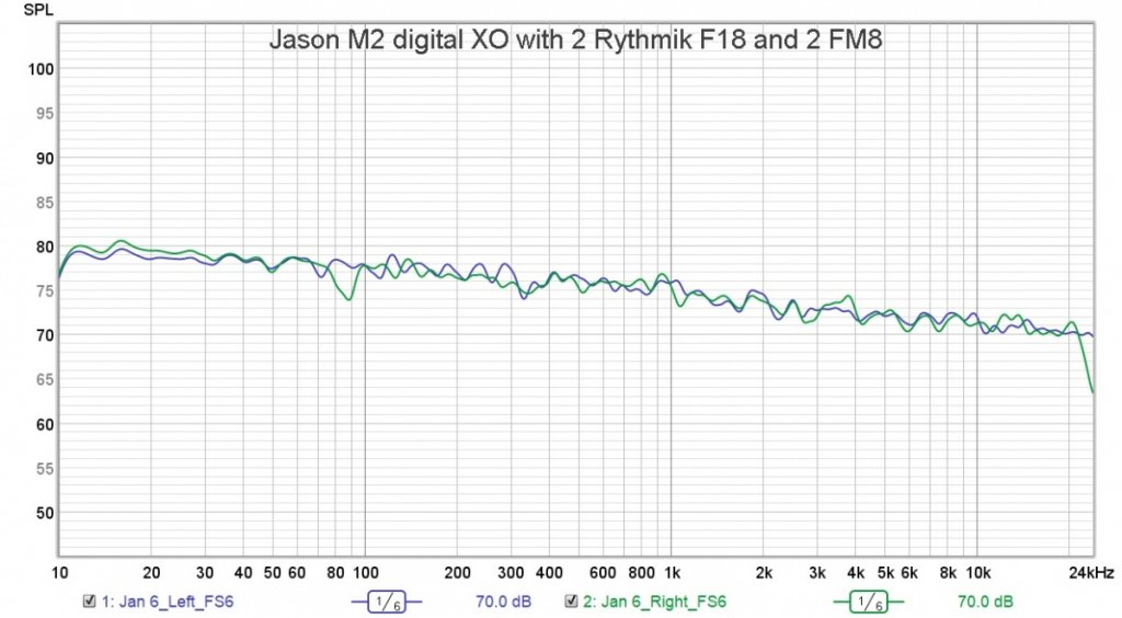

Here are my REW measurements post FIR Filter from Audiolense.
W10 i7 NUC > Roon (Audiolense Filter) > Motu UlatraLite mk5 > (2) Hypex NCore NC502MP > JBL M2 Master Reference +4 subs
