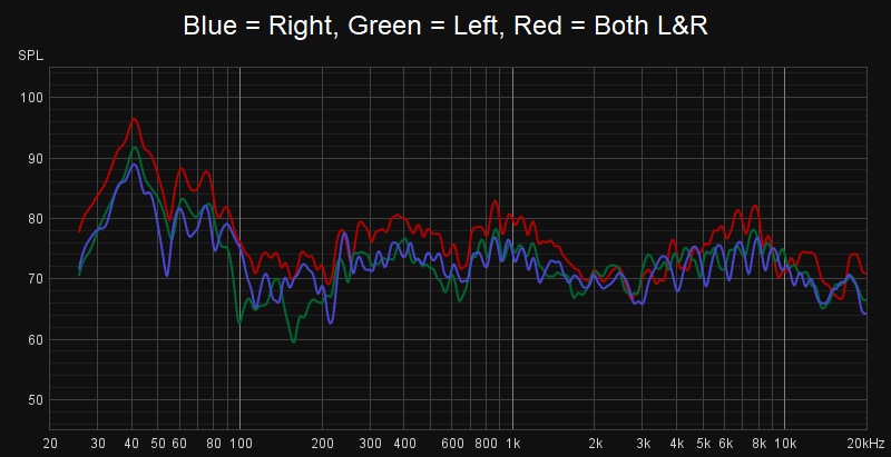

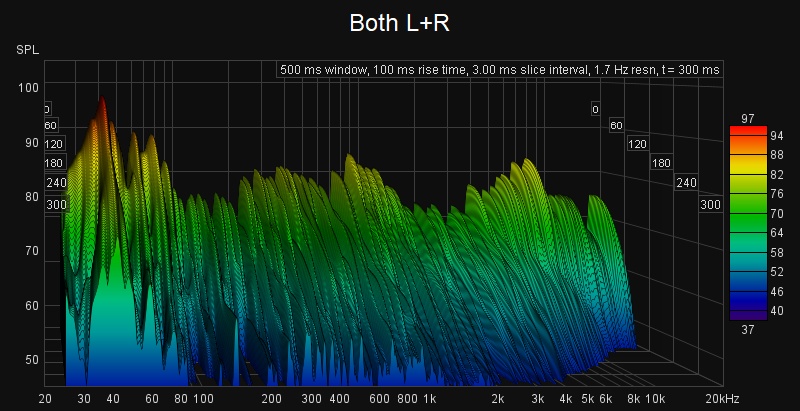

Here I am, for months, telling everyone how great my X3s sound (to me).  Finally, I dragged out my UMIK 1 and fired up REW.  Inside I was fearful of the results.  And, of course, the results were horrible.  Now, in my defense, I tried to play REW through my music server to my DAC (DAC is connected via USB).  REW would not work with the DAC's ASIO driver.  So, I switched to JAVA.  Left speaker, right speaker and both L+R.  All traces were almost identical showing a 25 dB peak at 40 Hz.  10 to 15 dB peaks at 60 and 80 Hz.  The speakers combined smoothed out the rest to within 10 dB.  Waterfall was miserable.  25 to 80 Hz was the worst.  But, there were additional frequencies in trouble as well.  I got room treatments.  I'm stuck with seating location.  All I can do is move speakers closer to front wall (which I don't want to do).
I'm going to try again tomorrow but run REW through my preamp so I can use ASIO4ALL and test all my speakers.  If my speakers fail again tomorrow, I'm likely to go the DSP route (Audiolense XO).

Marcus, your results are not uncommon. Domestic rooms have their way with bass. Using the EQ functions to lop off those peaks below 300Hz is an easy and effective solution. Other ideas that can help are non symmetrical speaker placement, using many more bass traps, and multiple (3-4) randomly positioned subwoofers. EQ is free with Roon and works well. Also toe-in angle changes things a lot too.

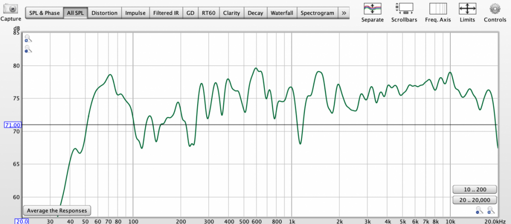

Marcus - can you post an image or two of your graphs?
I had the X3s and for a few reasons I switched to X5s. I have not measured my X5s yet, but here is a graph of one of my X3s. My lower end drops off and I'm wondering if yours does too.
Sure.  Maybe I am reading it wrong.  By the way, Last week, I ran Audyssey XT32 through my Marantz AV8805 preamp.  I use my X3s as part of my home theater setup.  Audyssey showed similar results although it applied filters to flatten everything.
REW: 1/12 smoothing.  Edit:  You could say I have one helluva "house" curve from 100 Hz down to 40 Hz.

I am a fan of REW. It’s humbling. It also shows the limits of acoustic treatments. Often, with troublesome bass, we are stuck with making slight improvements, not elimination of the problem.
Before you ran REW, did you have a hunch about that 40 Hz peak? 25 db would be very audible. I strongly suspect this is the resonant frequency of the room. There is only so much you can do to improve this without DSP.
The peak is so strong that you should try changing your speaker placement and/or listening position before tackling the problem with DSP. I was grappling with a 50 Hz peak. All I focused on was bass guitar! Moving my speakers 12” CLOSER to the front wall, such that they are now 48” away, solved the problem for me. Listening position is unchanged. I am quite certain I had them sitting in a bass node.
