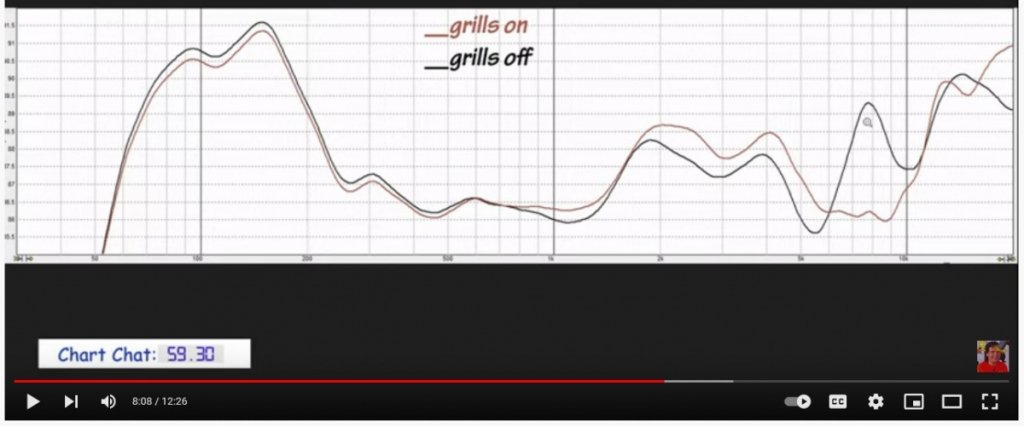

If the speaker really has a narrow spike at 57.5 and 115Hz does it come from the active drivers, the passive radiator or the cabinet? Hard to tell without measurements. Room EQ Wizard (REW) is a free measurement software program that will help define where the speakers problems are located. Without measuring you are just shooting in the dark hoping to hit the target. A steep learning curve but worth it.
https://www.roomeqwizard.com/
There are plenty or REW forums and tutorials to get you started.
Or you can watch the Alan Ross W King D8 Review to see a frequency response graph
https://www.youtube.com/watch?v=tiYJ1riJa_s

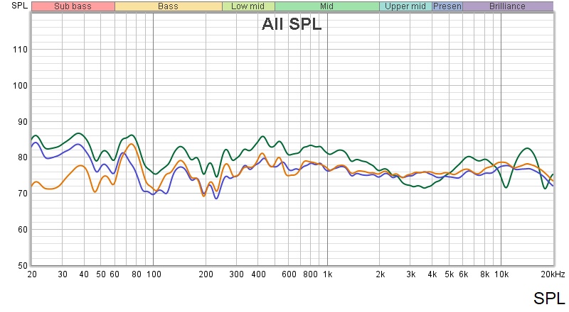

Now compare that graph to an in-room measurements of GR Research speakers using REW
https://www.audiocircle.com/index.php?topic=178270.0

Thanks for that Alan Ross link. The peaks (115Hz and 230Hz) show up in another Alan Ross review of the same speaker (https://youtu.be/Y__GH361JtQ?t=1030). I also already carried out frequency response testing of my own and confirmed response peaks there, which suggested to me a FR peak with a fundamental harmonic at 57.5Hz. Boominess at 115Hz and 230Hz is additionally very noticeable by ear, especially for notes played on instruments.
