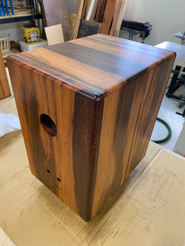

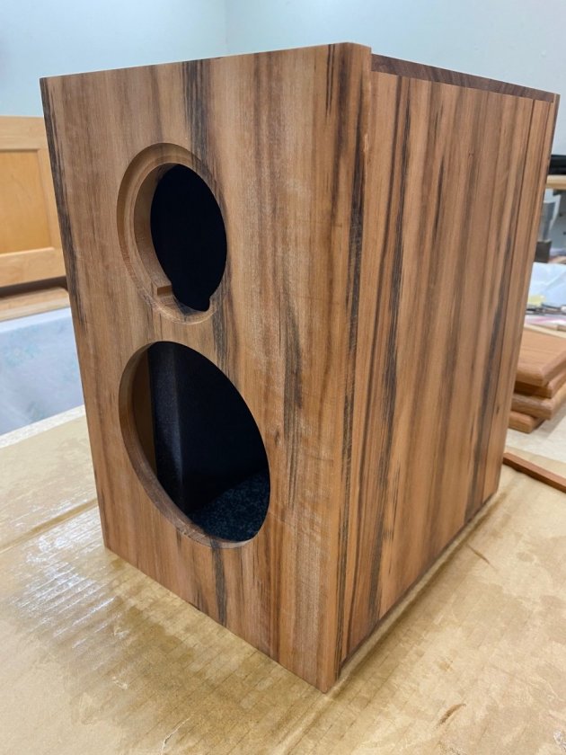

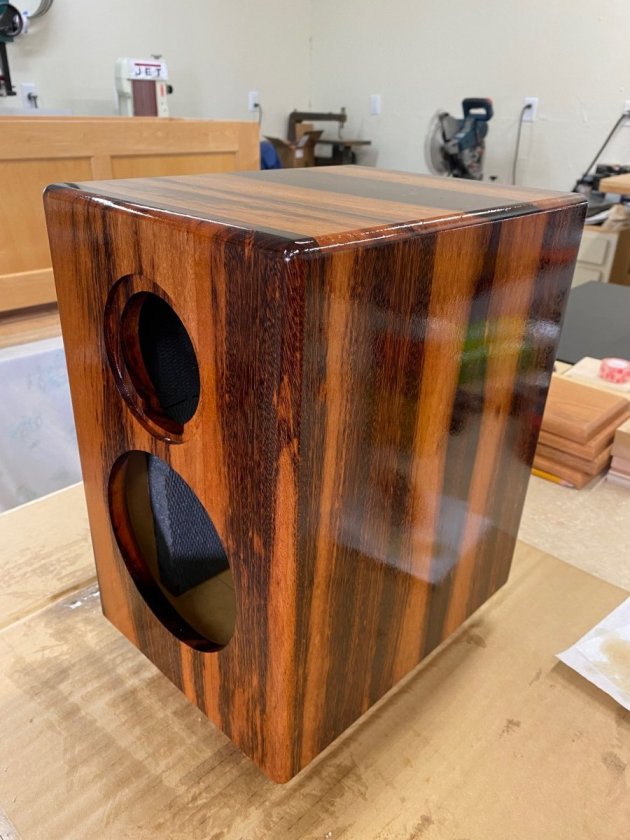

Well I decided to go ahead and apply some finish to the first completed cabinet.  I wound up using Waterlox Sealer/Finish for these first few coats then I will add several more of the Waterlox Satin finish.  I have used Waterlox in the past and it is really nice looking on nicely grained hardwood.  I had it and that was my original intent but I have to admit the Rubio Monocoat was very compelling especially since it is basically a one coat and done type of finish.  Now I probably would have chased it with the Maintenance Oil for that little bit extra sheen but I was afraid to try something new on these.  Here is what it looks like wet with Waterlox.

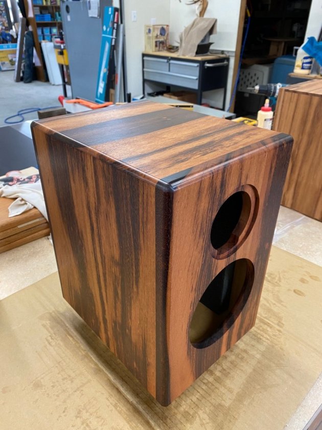

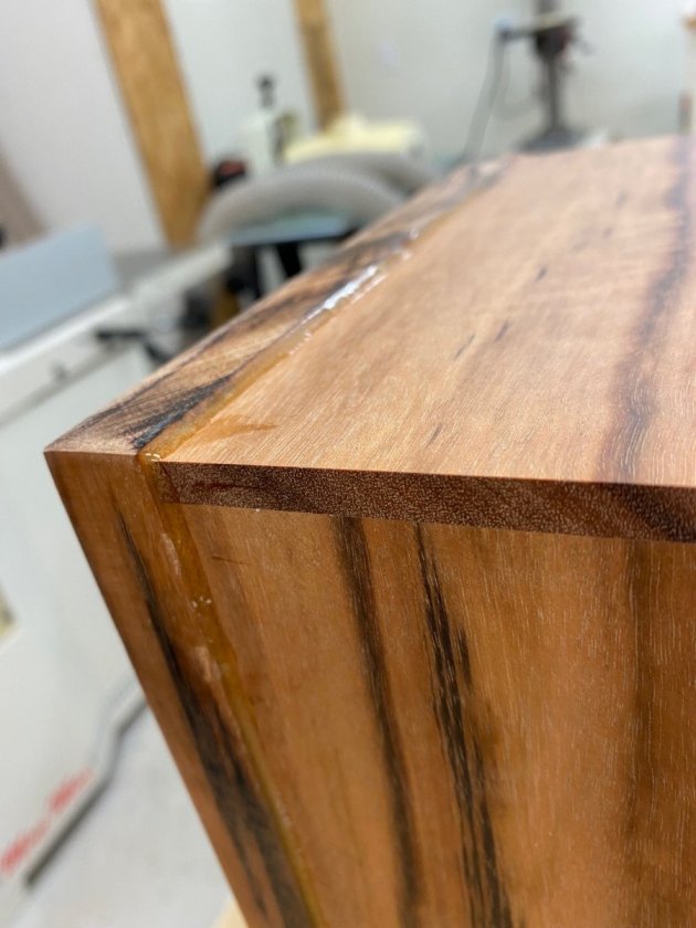

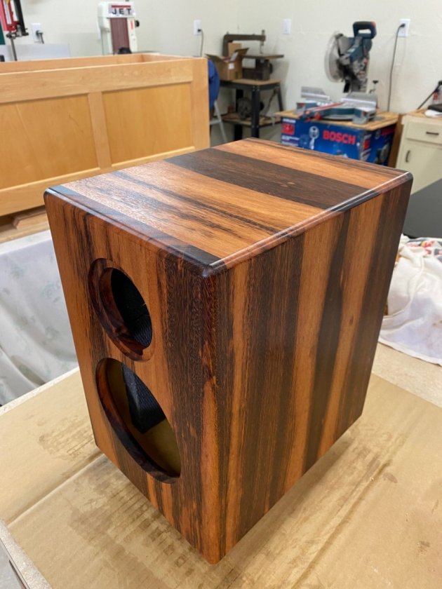

I kept going over it two or three times making sure to keep it wet I then let it sit for 6-7 minutes before wiping off the excess.  I wipe all the excess off and now it will sit for 24 hours.  Here is what it looks like wiped off.

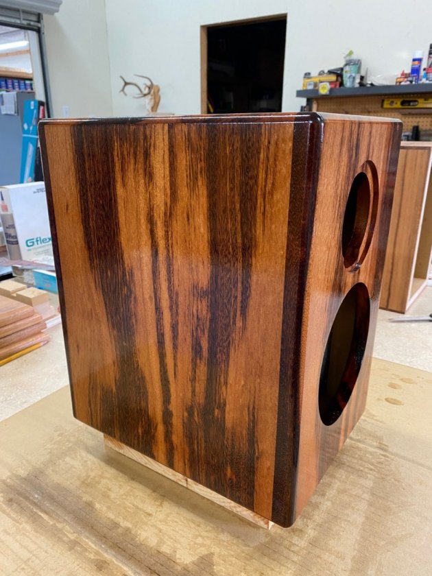

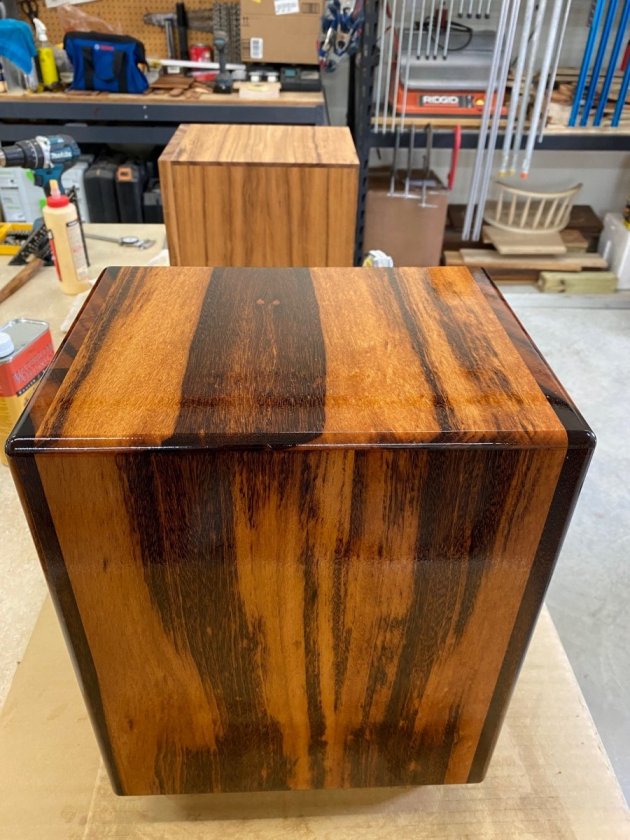

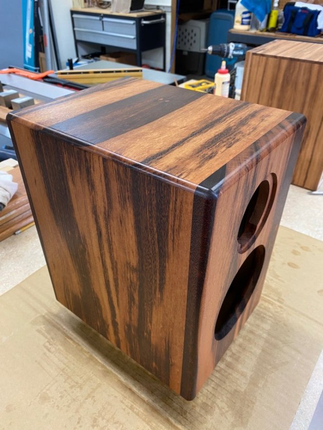

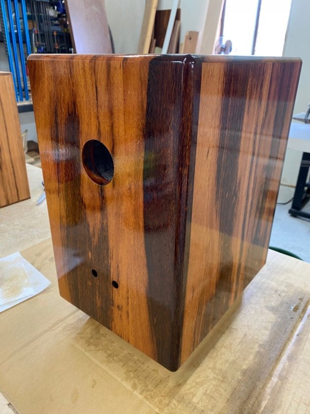

Here is a before oil and after the first coat of Waterlox that has been wiped off.  Big difference in the base color.  The Tigerwoods red/brown color is back.
Now the process starts.  After 24 hours buff/lightly sand, wet it thoroughly, wipe off the excess, repeat...

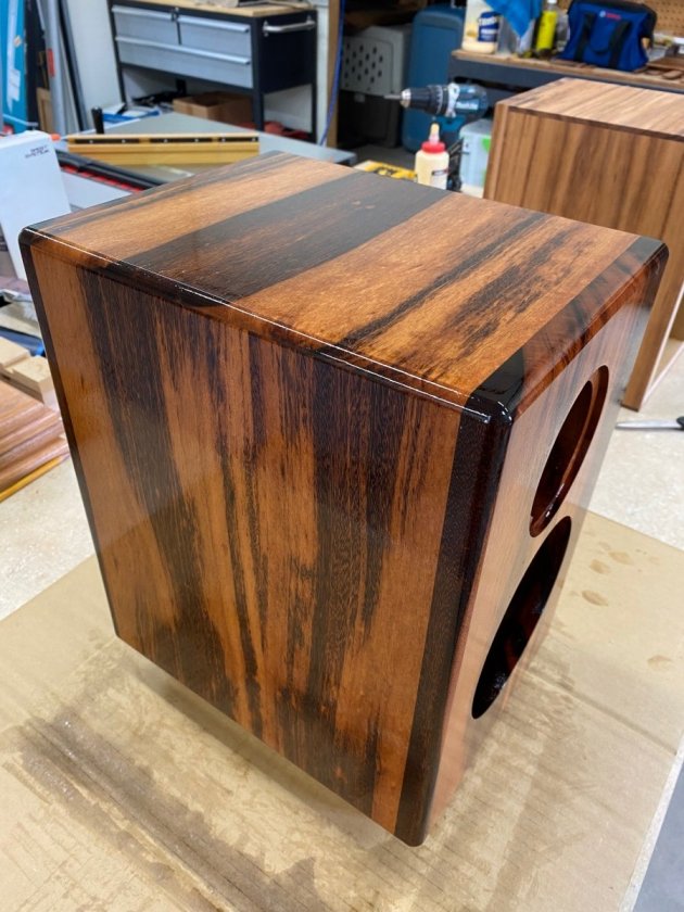

I truly appreciate all the responses.  I too like watching peoples builds come together and love pictures along the way.  I decided I would document this build hence all the pictures.  I am sorry if it is too pic heavy but I wanted to show off the grain of the Tigerwood as the oil brings it alive.  I just love natural hardwood.  One of the main reasons I selected Waterlox is it does not hide the natural grain and being oil based it definitely brings the grain to life.

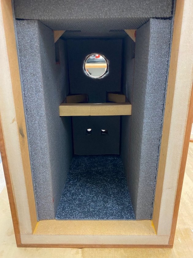

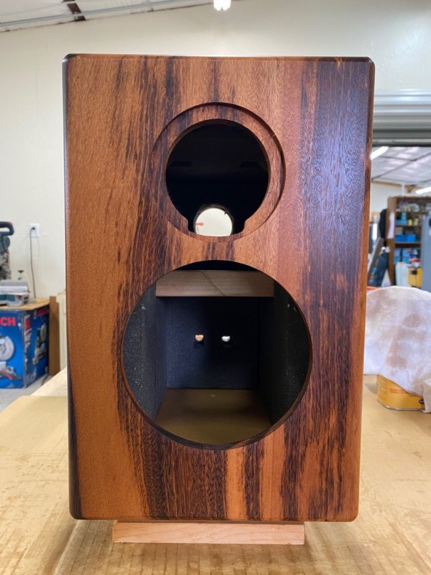

Well I received a package from GR Research today full of NoRez :D  Thanks Hobbs for getting that out for me.  Now I can continue work on the 2nd Tigerwood cabinet.  I got the 2nd cabinet lined with NoRez this evening.

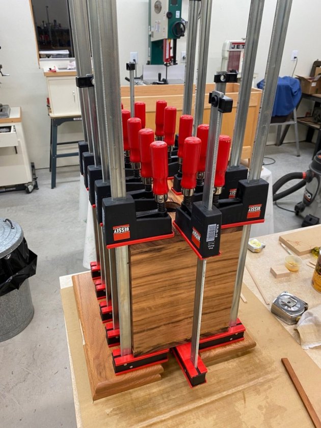

Once that was complete I installed my crossover board and predrilled the holes to hold it into place.  Then it was time to glue on the front baffle.  More Epoxy!!!!
Now I wait until tomorrow to remove it from the clamps.  Then out comes the router for a nice flush trim then I can start sanding the cabinet before rounding over the edges.  Feels good to be making progress again.  Thanks again to the guys at GR Research for getting the NoRez out so quick.   :thumb:

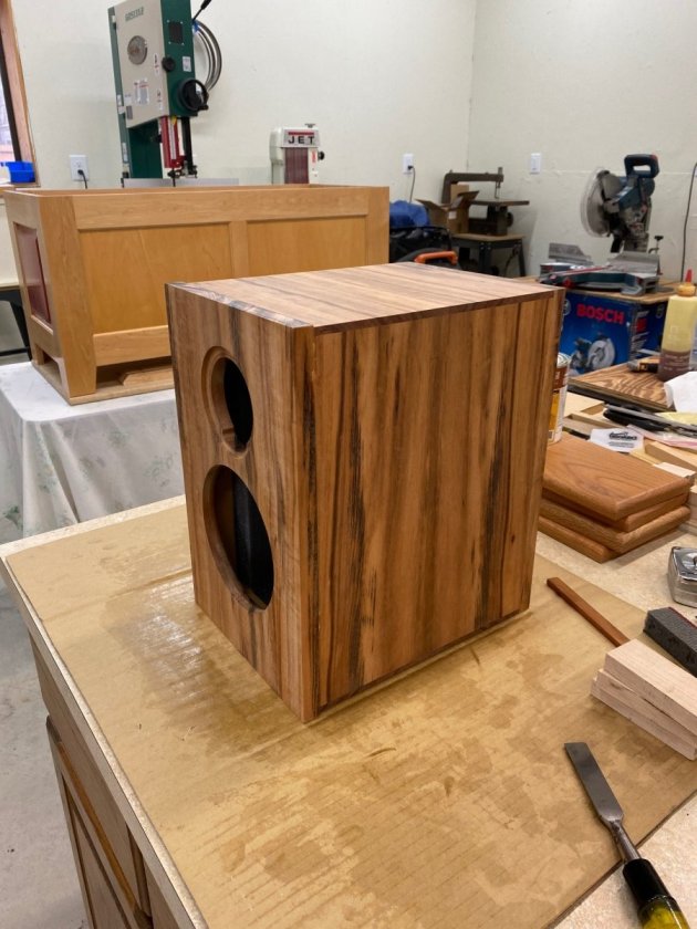

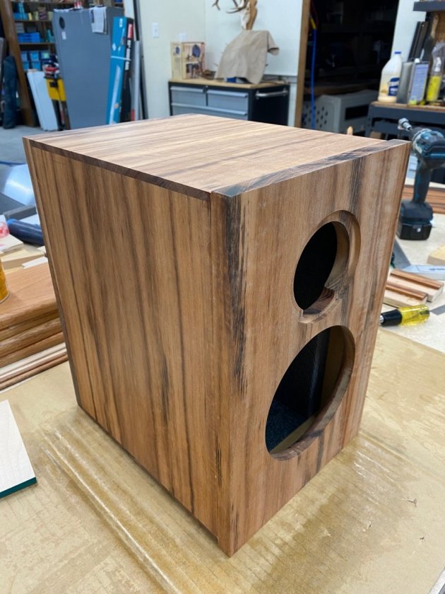

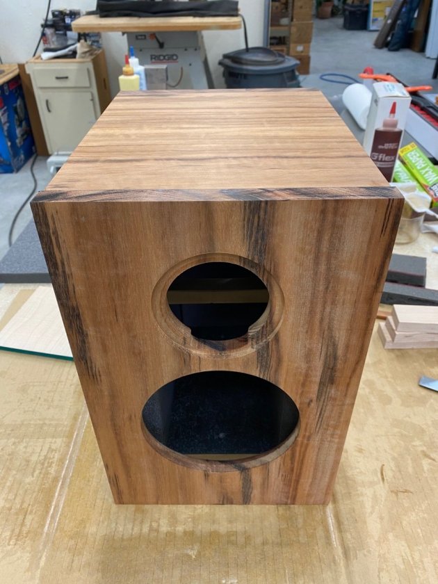

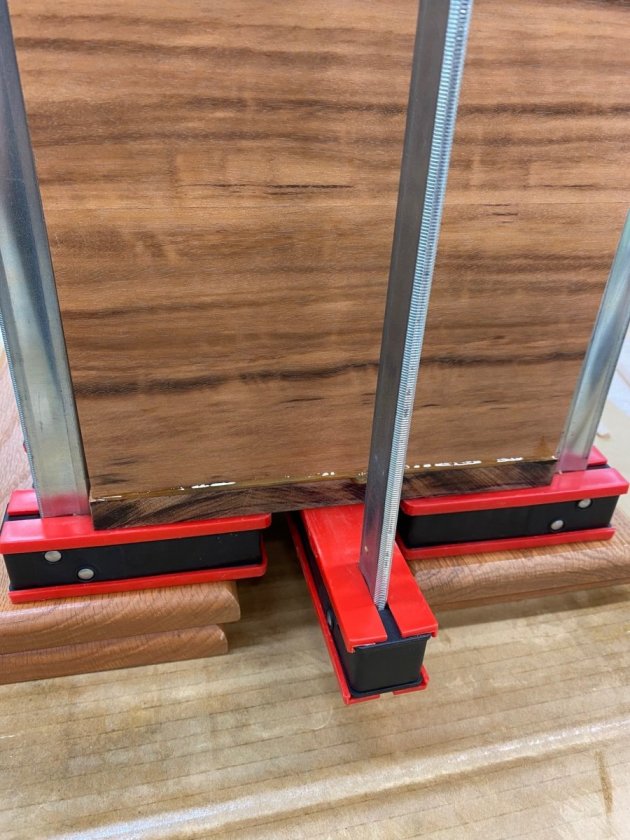

Not much progress today but I did pull the clamps this afternoon.  I decided to wait until tomorrow to flush trim to make sure the epoxy is completely cured.  Here is what the 2nd cabinet looks like with the front baffle freshly epoxied and still about 1/16" proud all the way around.  You can easily see the epoxy squeeze out.
I will get to work on this tomorrow.  Flush trim is next then a little sanding.  Once everything is sanded smooth I'll head to the router table for rounding over all the edges.  I decided to weigh the cabinet as it sits and it tips the scales at 21.5 pounds....empty!
